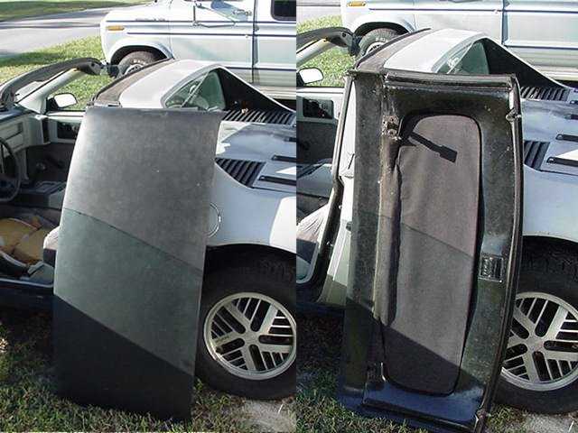

This Targa top kit was made back in the 1980's by a company called AutoDyne but I have yet to see one that's been installed. The literature claims that it uses a one piece detachable roof section with frame reinforcements. The top piece reportedly is stored on the baggage rack and when installed clamps securely to the top of the windshield and the rear roof section. It looks pretty nice in the picture.
I just wonder how many kits were sold and installed.

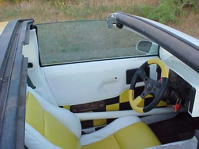

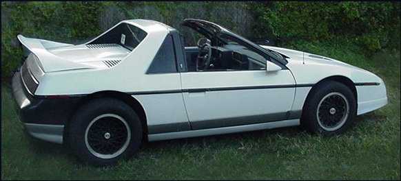

Corson and B&B Customs made them back in the day.
This is a really old post, and the car was rescued after sitting for 5+ years, so it was likely converted prior to 1996.
https://www.fiero.nl/forum/A...020511-1-012945.html
This is the Corson kit:
This is the B&B Kit

I had one of these kits way back in the day, on an 85 GT
Looks cool, but squeaks and rattles, lots of body flex, hard time closing the doors, despite the frames supports that were meant to add rigidity. Definitely would not recommend
