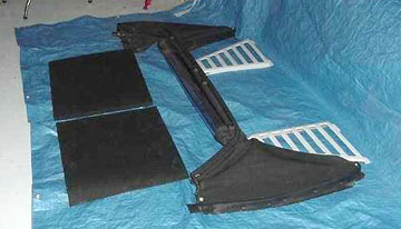

Cozmo- just wondering if you happen to have a photo of the top itself? Maybe some close-ups?

MinnGreenGT, here's a montage of both sides of the top. These pics were taken when I first got the car, you can kinda see what bad condition the car was in. Since then I have replaced the latches, rubber seals, center headliner and painted it gloss black.
When I get my camera back (durn relatives) I'll take some more recent pics...

Thanks Cozmo!

Thanks for the pic's Cozmo, That was exactly what I was thinking of. I think I might attempt that type of conversion this summer, Got to finish the Countach project first.

OK I will try to tell you all I know about the targa top (cosmo has) It was a company out of IL.
1)The picture to the right showing the under side of the top where that thing that looks like a dome light said Targa top(that ones missing)
2) How does it latch down? If you look at the same picture (center where the headliner is) you see the shadow of the latch
3)Where did the top store(Cosmo is that the original deck lid) I don't think so because they had 2 big bulk rails bolted to the rear deak lid (in the same direction as the luggage rack goes) and you strapped it down to that.
4)The outer panel is the original roof solid skin
The only reason I know about this is there is a guy in Milwaukee who has one of these conversion that is done to a Black 1986 Fastback GT, gray interior auto, but I haven't seen it around in about a year, he bought the car already done as well, but the first owner told him where it was done. I will try to find him.

Cozmo, it looks like the original deck in the photo of the two tops is what Fiero John is talking about. That means that the deck on your first photo is one that you've replaced and if this is true, what kind of spoiler did you put on your car?
