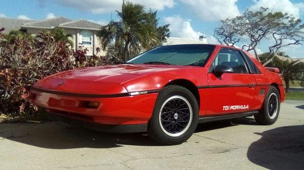

this is mine with 2" drop spindles, about 4" ground clearance at rubber air dam, need to slow way down for entrance ramps, and any road debris, scooped up some critters, mostly my rubber air dam takes the hit, Oh and those concrete parking stops, so yes not very practical, OK for a weekend cruiser, daily driver, no way
84SE, aero body, 4 speed and an injected 355 V8
