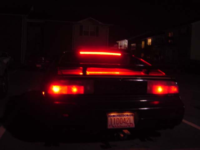

fierosound

Doober
Posts: 445
From: Oro Valley, AZ/Swartz Creek, MI USA
Registered: Nov 2006
Report this Post09-16-2017 03:27 PM Click Here to See the Profile for DooberSend a Private Message to DooberEdit/Delete MessageReply w/QuoteDirect Link to This Post
I like those... much more modern look.
