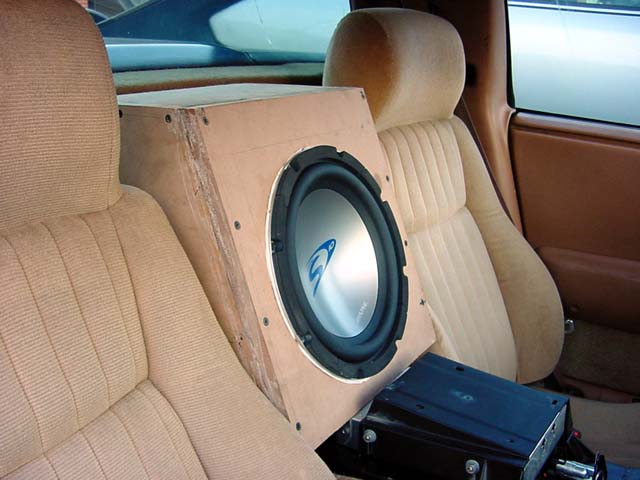

I put my new sub and amp in today. I haven't covered the sub box yet, as I am going to do a custom console later on. Here's where I'm at so far:
Alpine 10" dual voice coil (500W capable), my own box made from 3/4" MDF, and relocated ECM. I was very impressed with this speaker for the cost! The box took a while to get just right; I made a cardboard box for several different designs until I got it big enough without hitting my shoulder and with the proper angles. The box is small (.5 ft if you account for the sub), but it works. It's angled to be parallel with the firewall and the shelf under the window...so when I make my console it will look like it was supposed to be there.

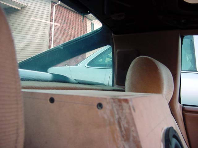

Here's a picture of the box/shelf angle comparison

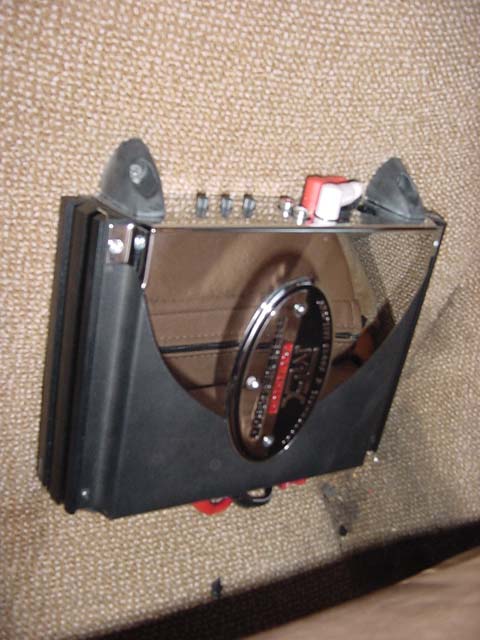

MTX 350W @ 2 Ohm. This amp wasn't the cheapest, but it is very small! I liked that the most, along with it's advertised 2 ohm stability.
