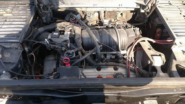

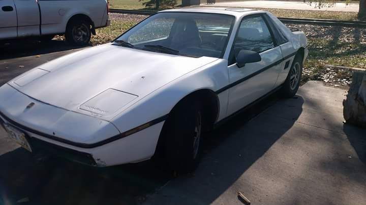

Been looking at Fieros for sale since before I could drive and one has recently come up for sale that the owner told be to make a offer and well go from there.
Its an 85 with a 92 3800na swap but the motor has a knock they don't want to fix it.
What might be a good price for this?

Very interesting wire routing on the right. Did you check for rust in all the usual Fiero spots? That Fiero's engine bay doesn't appear particularly clean. You're probably looking at pulling the engine.
I guess the first question is, what is THAT Fiero worth to you? Do you have the knowledge/financial resources to fix that swap and the problems with it? How about to fix the other issues? I'm guessing that the rest of the car is rather rusty.
Generally, you want to buy a Fiero is the best condition you can, then go from there; otherwise, you wind up with a problematic rustbucket. In the case of swaps, you usually don't want to inherit someone else's problems. That looks like a home swap. While I'm not knocking home swaps, they tend to be undocumented, and may have been done with no particular method. I've seen a number of 3800 swaps. This one looks ”interesting”. If a swap is done on the cheap, there may be shortcust that were taken.
Suppose you got this one for $500. Then put $2,000 into fixing that swap. Within the year, you'll probably have another $1,000 of work to do, from brake lines, to end links, steering damper, to brakes. There is probably rust in the trunk and frame rails. The fuel pump, fuel lines, and gas tank may need to be addressed. Were these replaced with the swap? I doubt you can get this car for $500, but these are lowball figures. Are you ready to spend $3,500 for a Fiero? Likely, this seller wants $3,500 as the car sits, and you're looking at more like $6,500. For that much money, you can buy a nice, running 3800 Fiero.
Personally, I'd keep my options open. There are a lot of great Fieros out there. Don't jump on the first one to come along. I'd recommend looking in the Mall here on PFF, and buy from a member here.
Here is a quick link to a cleaner install: http://www.gmtuners.com/85FieroL36/index.htm

I'm thinking I might be able to get it for under $500.
As for a motor I'm not worried I've got friends that have 3800na cars setting with good motors but totalled bodies.
I'm hoping to go see the fiero after the holiday. What areas should I be most concerned with to check for rust?
Any major things I should look at?
This is the first fiero I've seen under $2500 that didn't have mayor rust showing in the pics. Most of them I've seen under $2500 in my area I see in the junk yard about a month later because they are too far gone.
I'd rather put some work and money into a fiero instead of the car I'm currently driving.

Pull back the trunk carpet. Check the trunk sides and bottom for rust. Anything worse than a light brown is probably bad, because frame rails are there. If just the bottom of the trunk is rusted, it could be that the decklid leaked, but then the interior of the decklid is probably also rusted. Look underneath the rear of the car, at the visible frame and suspension. If you see jagged or sharp edges, run. Look at the cooling tubes along the sides. If visible rust, avoid. Look under the front, behind the nose. Anything more than surface rust, run. Look at the rack and front suspension. If the rubber is gone, or the lower control arms are rusty, run.

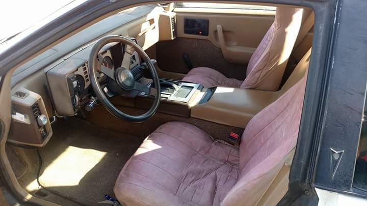

The interior looks OK.
If the car passes that, and you can get it for less than $500, there are other things to consider. Who can do the work? Probably lots of things will need to be fixed, even when swapping in the same non-stock engine. The engines in your friends' cars are presumably sitting and deteriorating. They may need a rebuild. Usually there is a reason a car is under $500. I got a cheap Fiero. It was a money pit. Often, when someone with a problem swap is selling cheap and doesn't want to fix it, there is a reason. The car may be too far gone, or the swap may have been done incorrectly. I could be doing this seller an injustice, but if you buy a Fiero expecting to spend $4,000, have it running within a few months, and drive it for 5 years, spending $1,000 per year, but end up spending $8,000, and the car still isn't reliable or running after a year, it will be a terrible Fiero experience.

IMO, ANY automobile with a bad engine is valued at the salvage price. Its worth about $300.
