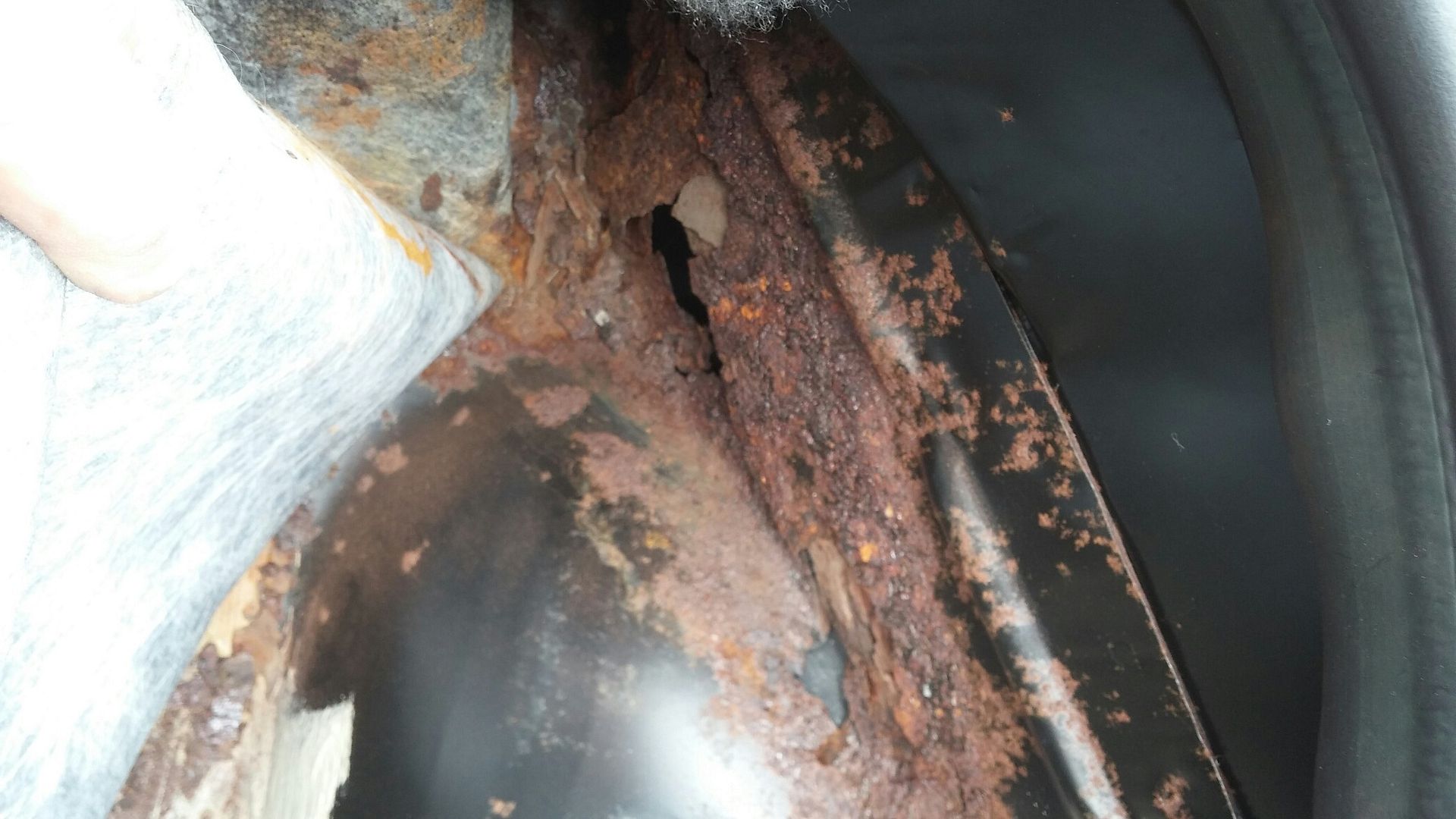

I have a quick question about a decision I need to make this weekend.
I have found 2 Formula's fairly close to me that would not need shipping ($$$) and I could pick up and drive home.
One is an automatic, and the other is a 5 speed.
Both are within 10,000 miles of each other, 95,000 and 105,000
One I know has some trunk rust, but it is not horrible (judging by the pictures I was sent) and rather fixable from what I can see (the 5 speed).
The other I am still not sure about, but it looks pretty good and is the lower mileage one.
Trunk rust looks like this......
And this......
My question is, by anyone's past experience, can you tell how extensive the rust is and just how "fixable" it is by the pictures.
I know I should probably walk away from the rust, but around here it is all you see.
If the other one has the same rust, I do believe the 5 speed would be the best buy for me, even though my knees may not like it that much.
Old age and time have taken their toll, but I really do miss shifting even though it hurts.
Almost a $1000 difference in price, and as far as paint and interior, they are almost twins.
Anyone feel free to chime in!

Report this Post04-30-2016 11:04 AM Click Here to See the Profile for TheDigitalAlchemistClick Here to visit TheDigitalAlchemist's HomePageSend a Private Message to TheDigitalAlchemistEdit/Delete MessageReply w/QuoteDirect Link to This Post
One of mine had less rust than that In the he trunk, but the cancer was all inside the cradle too. Very sad.
Looks fixable/treatable, but it's hard to tell the extent just by those pics. Would be good to get some pics underneath...
Hope the other one is in better condition.
Thanks for the input, I am worried about the frame rails and cradle also.
The car is a 3 hour drive from me, and I am hoping to get more feedback before I take the trip.
Great suggestion on getting some underneath pics from the guy.
I will ask for that before I make the trip.

Report this Post04-30-2016 02:18 PM Click Here to See the Profile for TKSend a Private Message to TKEdit/Delete MessageReply w/QuoteDirect Link to This Post
Two deal breakers for me is rust and paint. You never get your money back for any fixes. Look for a car with no rust and good paint or walk.

Originally posted by TK:
Two deal breakers for me is rust and paint. You never get our money back for any fixes. Look for a car with no rust and good paint or walk.
I am seriously leaning in that direction.
It is almost impossible to find a zero rust car around here that is less than 5 or 6 years old, let alone a 28 year old car.
sigh......

I fixed the typical rusted out trunk side floors in my '84 SE in Oct 2004 at 261,000 kilometers (162,000 miles).
They're still good now at 371,000 kilometers (230,000 miles), but I don't imagine there's much left of the rails...
I haven't taken the inner fender liners out to see what's left - I suspect that would be followed by the rear clip etc. to reconstruct.
Since it's not likely permissible by the seller, inner fender removal may have to be deferred until after purchase.
You can, however, reach up in the wheel well to check the wall of the strut tower box nearest the tire.
If it's solid, the other hidden structural stuff may well be ok.

My concern would also be, what is the cradle like? I live in Metro Detroit, so I live with the salt too. I bought my 88 GT knowing the trailing arm bracket was rusted out. What I didn't know was how hard securing a 88 specific cradle would be and the sticker shock to go with it. In the end, I was very fortunate and found someone in state to work with. If you are looking at rusty Formulas, they are 88s and you might very well find yourself in the same boat. I wish you the best in your search.
