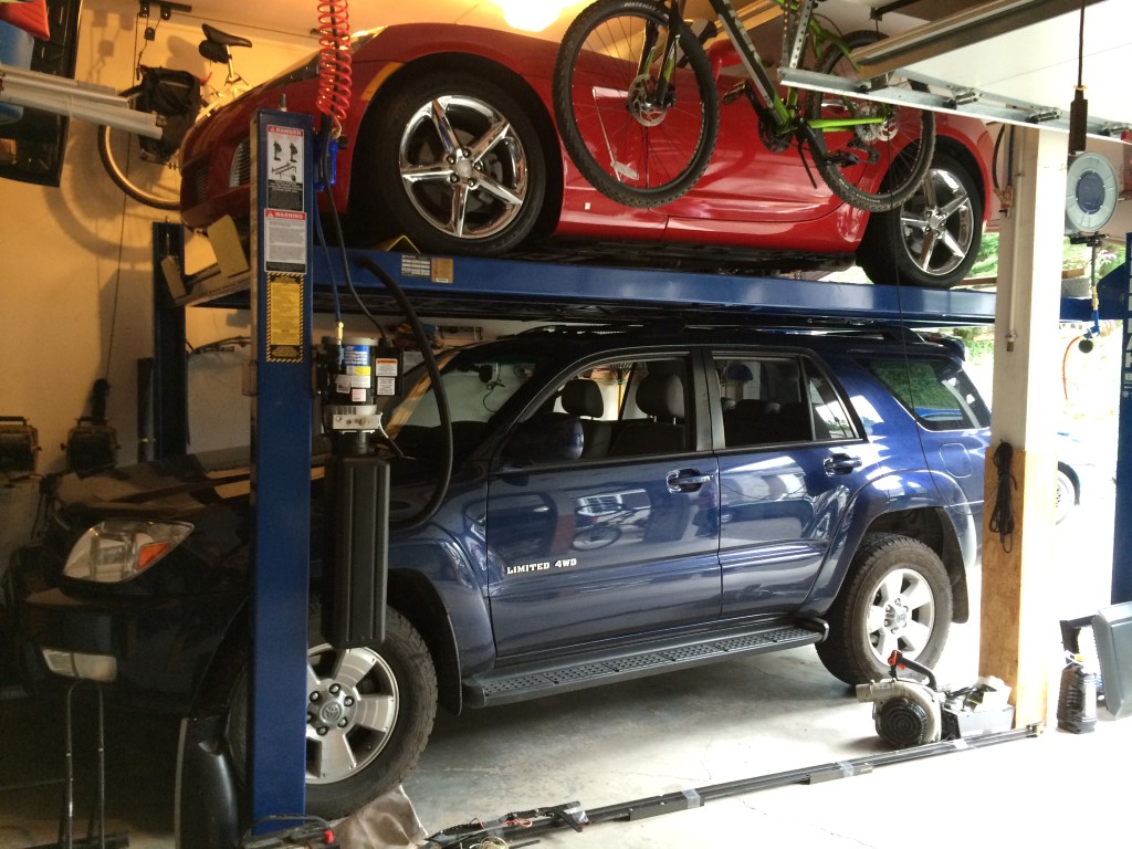

We're fortunate to have a high-ceiling garage. When we gave my wife her Bugeye last summer we put in a parking lift to make room in the garage. At that time the Fiero was parked outside.
Now that the Fiero has new paint, it's been in the garage and my 4Runner has been outside. But not after today. Today we turn this:
Into this:
Last time we did this I didn't have an engine hoist. It was really a feat to get the thing off the trailer and assembled with a floor jack and a hand truck. It ships all in that one package and weighs over 1700 pounds.

12 hours, two helpers, half a box of Top Pot donuts, a pot of coffee, four trips to the hardware store, one trip to O'Reilly's, and a pizza later.

Garage height is 11'-2.5". But there is a support beam that interferes with two of the three bays that costs me about 8" of clearance under the door.
In the bay without the beam I can raise the lift to full height with any of the two-seaters on top, and both the Sienna and 4Runner will fit under. I can also fit the Sky (with the top down) and Bugeye (haven't tried the Fiero) under the Sienna or 4Runner on that side. The Sky fits by two fingers widths
I'm not sure about the middle bay yet. The door isn't entirely done (not all garage door companies are created equal...should have stuck with the first, more expensive crew). I tested with the Fiero lifted to max height and the Sienna wouldn't fit. I think it will if I back the Fiero onto the lift, though.

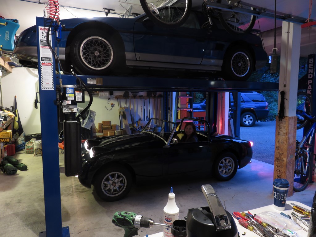

Yes, it's a Bendpak HD9. I spent a lot (A LOT) of time researching the first one and kept arriving at "I prefer everything about the Bendpak except the price".
With the first one I upgraded to aluminum ramps, got a set of casters (it can be moved around on them, just not with a car on it), and bought two pairs of drip trays (I needed three trays and they come in pairs).
With this one, I got just another set of aluminum ramp brackets (I don't need or want two sets of ramps), one more pair of drip trays, and added a 3000 pound jacking platform. With terminal pickup, I think my total was about $3100. I would add that Brian Lockhart at asedeals.com is fantastic to work with. He must have spent two hours total on the phone with me reviewing brands, models, and options the first time (I don't work for, with, or otherwise have any skin in their game, other than they treated me very well).
This one was waiting for me at the terminal five business days after I ordered it. The package is 14 feet long on the dot and weighs a little over 1700 pounds- getting it off a trailer/truck without a forklift is not trivial.
Assembly takes time, but isn't complicated. I did some thing differently than the instructions and managed to avoid a couple painful errors that I made and had to undo with the first one. If anyone where orders one let me know via PM and I'll send you some thoughts.

What is the car on the left, yellow with black rally stripes?
GreenPlatypus
Posts: 336
From: Louisville, KY
Registered: Oct 2011
Report this Post05-25-2015 07:47 PM Click Here to See the Profile for GreenPlatypusSend a Private Message to GreenPlatypusEdit/Delete MessageReply w/QuoteDirect Link to This Post
Viper SRT10 by the looks of it.

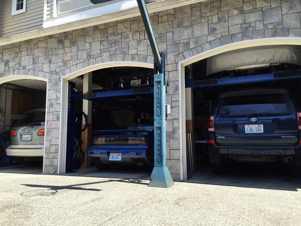

Finally took the time to shuffle things around and got all five cars in the garage last night. I still haven't tried all the variations; I'd eventually like to have the Sky and 4Runner in the middle, but because the door is lower on that side, I don't know yet if that combo works.
