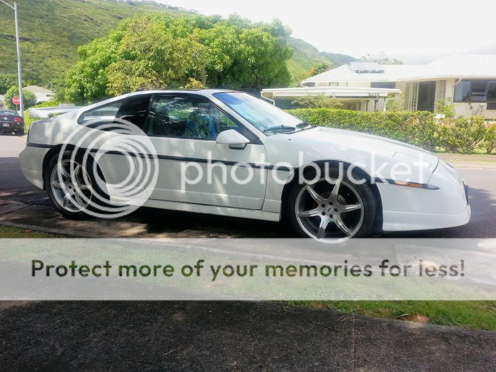

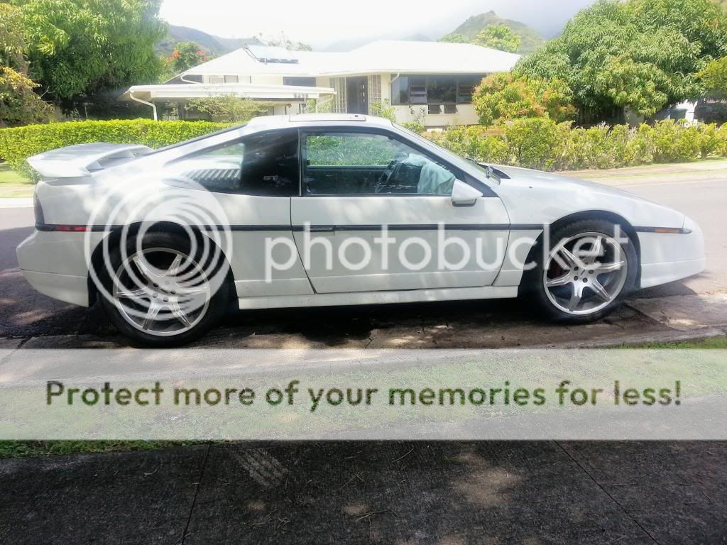

First, here's all the necessary info...These wheels are 18x8 with a 35mm offset. The front tires are 245/40 r18 and the rear tires are 245/45 r18. I got these wheels and tires at a pretty good price and for some reason I REALLY like the way theses wheels look. I'm usually more wheels with a deeper lip, but I guess there's a first for everything!
I put the rims and tires on my car today and here is what I found. The fronts fit fine, the rear tires however rub very slightly on the bottom of the rear coil. Actually, they are not rubbing the coil, but the rubber seat that the bottom of the coil sits in sticks out about 1/8th on an inch past the bottom of the coil and that's what it is rubbing against. The car still rolls easily and a 1/4 inch spacer will fix that issue easily. I usually don't like spacers, but 1/4 inch should not cause any problems at all.
Over-all, I really like the way the wheel fit the car @ stock height. the actually bring the car up off the ground a little but it's hard to tell. When it's time for new tires I may go down one size in the front and rear, but we will see how these do for now.

It does look very good with those wheels. You planning on paint them? Hope not. Have you tried turning the wheels full lock to see if they scrub? That should be your guide to front tire size,

I actually plan on painting the car matte black and the wheels gloss black. I turned the wheels without driving the cat and it seemed good, but I should probably drive her down the street and check it out like that! Thanks!

I'm running the same size wheel/tire combo on my 88 coupe and they work great. I have coil overs in the rear so no rubbing issues.
Those wheels look good on your car.

I'm using the same size rear tire. It's a good size and wouldn't go smaller. Your fronts could go down to a 225/45r17 like mine, but I doubt the sidewall will change at all. I'm also on coil overs front and rear, dropping it will give you a better idea about what size tire is best in the long run. 245 will rub if you drop it. The front inner fenders don't much like wide tires when it's lowered.
