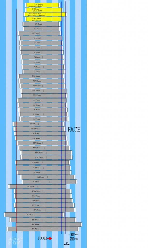

Here ya go

Thanks, so with 8" wheels and a 35mm offset, that looks as about perfect of a fit width-wise as you can get! What do the blue lines represent?
Location of the stock wheels.
Bob
Bob
Thanks!!!
