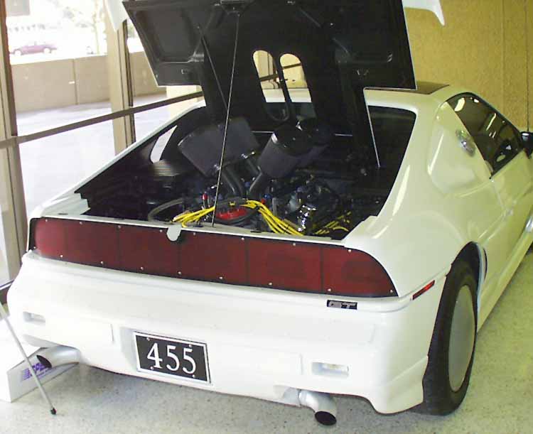

Already been done with the TH375 and a 455 Olds - and its supercharged.
Videos are all over U-Tube, and you should be able to find pics in old Daytona threads here on the Forum.

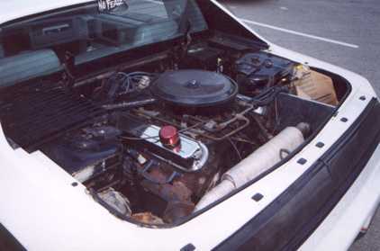

I sat next to the owner of this at the 30th Fiero anniversary show. Has Toronado setup:

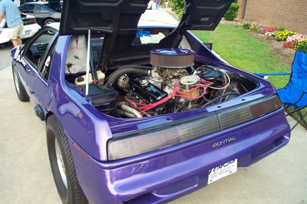

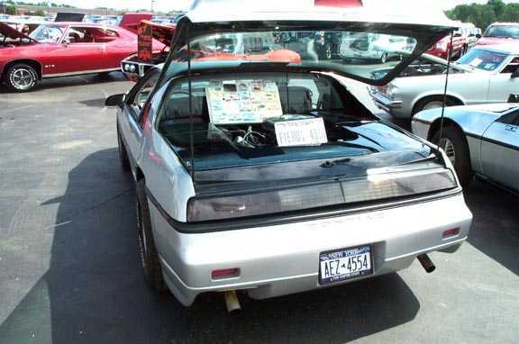

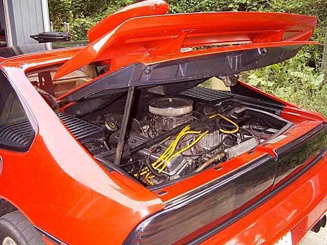

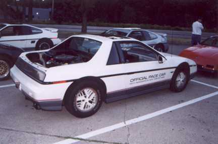

Here is Big Block Fiero's thread. There is quite a bit of drama and the signal to noise ratio is pretty low, but it does have some pics of putting a 500 caddy into an 84 fiero:
https://www.fiero.nl/forum/A...090219-1-062869.html
Here are some other longitudinal swaps:
