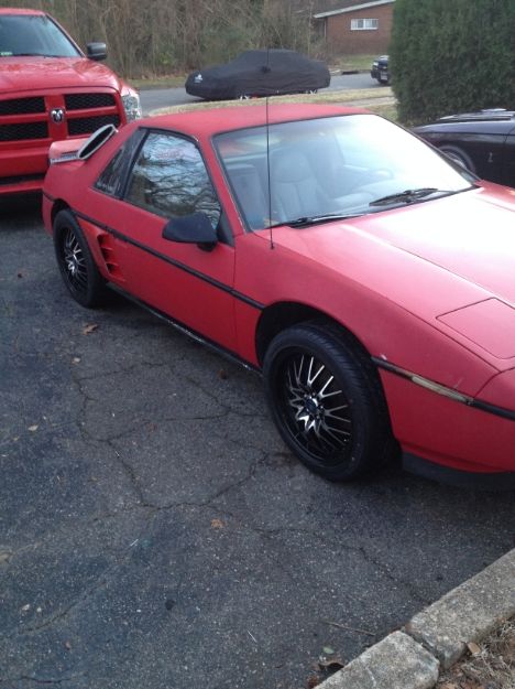

This is how I got this Fiero

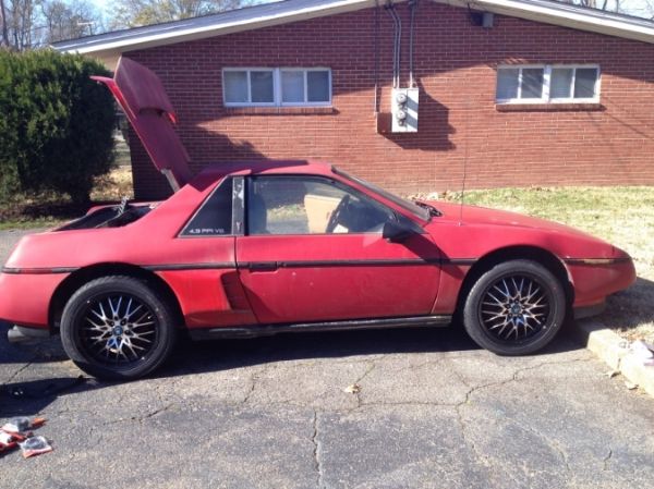

When I got her on Jan 15, 2014 from blackrams here on PFF. She sat for roughly 2.5 years until I bought her. I needed to get her running to ensure everything was in working order. So the following weekend, I changed the oil and oil filter and purchased a new battery. Then I drained the stale gas out of the tank because I didn't want to risk the gas creating more issues. Then I installed the 17" Konig Lace wheels on it so I could get the Centerlines off and sell those. This Fiero has a Cadillac 4.9 installed by The Fiero Factory, along time ago (circa 2002, I'm guessing). She also has the 12" Corvette Brake Upgrade.
This is how she sat after that day. This was also the day she ran for the first time in 2.5 years

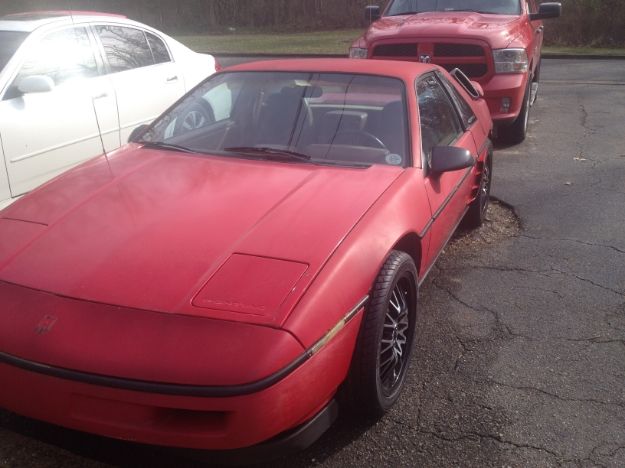

On to today (Feb 2, 2014). I gave her a Plug and Wire Tune Up (that was a pain) and I put in the a new Thermostat because she was overheating because the old Thermostat was seized up. I also took the shifter console out so I can repair it and install the shifter boots that I have for it. I also installed some scoops. Then my friend called and asked me to help him fix his STi.
This is how she sits as of today.

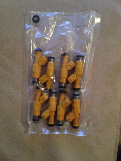

Well, my injectors arrived today. I got them off of eBay from seller osidetiger. They are rebuilds that are also flow matched and they use Viton seals when they rebuild them. The injectors also come with a 1 year warranty.
The injectors came in this bag which was inside one of those USPS VCR Boxes.

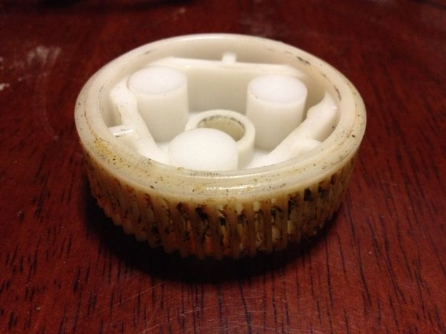

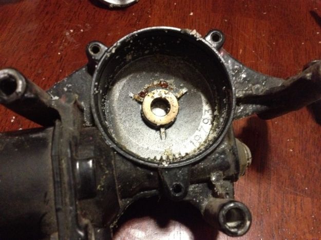

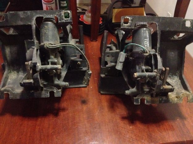

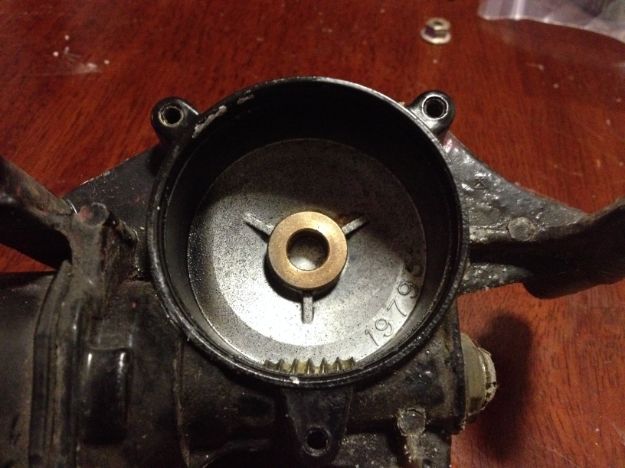

Well, these came in today from Rodney Dickman (Thanks Rodney!) Along with my Front License Plate Holder from mrfiero (Thanks Mike!)
Now for some install pics.
The victims
First Victim, this is the Driver Side. Its not bad, but I figure it won't be long before its the bad one. Might as well do it right the first time.
See not too bad
New metal gear going in
Onto the the Passenger Side, the bad one.
All Clean
New Metal Gear going in the Passenger Side Motor
These should last along time. I will probably put them back in the Formula tomorrow since its cold out now. I hate winter.

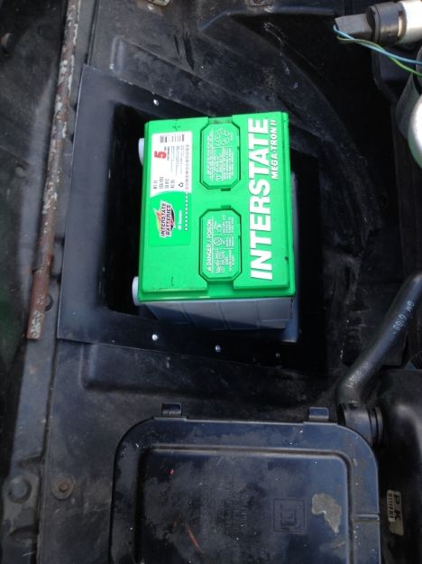

So today was a nice day outside. I gave in and purchased a "New" Driver Side Caliper from Amazon. Took my vacuum pump and pulled out the old fluid, then put new fluid in it and bled the system. Got in the car and the pedal went straight to the floor, so I am guessing my Master Cylinder took a crap on me. I know one thing on this car that will never be done again is that parking brake spring.
So to feel like I got something accomplished today, I went to install my V8 Archie Battery Tray. The pop rivets I have are too short to work. Nothing is going too well with this Fiero. To top it all off, the motor burns a healthy dose of oil, so I might be doing an engine swap sooner than I care for.
But I did get it registered at the DMV today. They robbed me of 2 hours this morning.

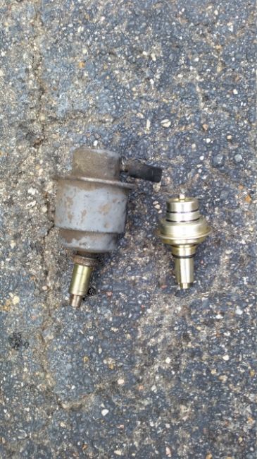

So I have been doing some research on why I am seeing white smoke, it real heavy upon start up and then its steady. I know I am not burning coolant because I haven't lost any and the exhaust doesn't smell sweet, so that eliminates a head gasket. I have read on a few Cadillac forums and various other forums that it may be some bad injectors or it could be the vacuum modulator on the transmission. So I might go investigate tomorrow. I haven't actually driven the car because of the brakes not working and because it wasn't registered until today, but I had put in a half of a tank of fuel in it after I drained the fuel after only running it a handful of times, she is almost empty. So that leads me to believe that I may have some bad fuel injectors, that also explains the hesitation when I rev it up some.
Good thing I bought those Bosch Type III Injectors then.

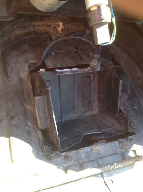

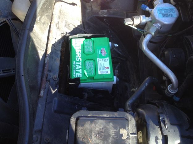

Now to the battery box situation.
This is the old setup. Its an old Marine Battery Box that at one time was held in by a couple pieces of plastic and some screws. I think this was done by the Fiero Factory when they swapped in the 4.9
At another angle without the battery in it.
Here it is after today.
Once my new battery cable crimper comes in, I will be able to run the battery wires and have the battery all hooked up. Today, Rockauto got $234 of my dollars for some brakes pads, Shocks, struts, and parking brake cables. A Master Cylinder from Amazon is also on the way so I can finally bleed the brakes.......again. This is going to be a new Fiero by the time I am done with it. LOL!

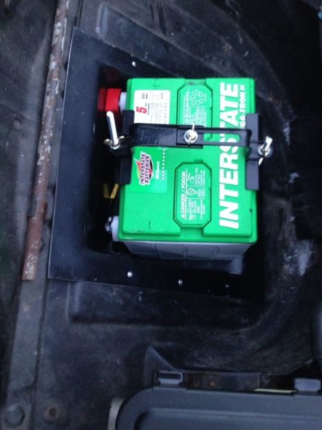

Well, today was a nice day. I spent all day working on it. I got the battery all secured and re-ran the battery cables with new connections. Much better now. I also got my KYB Front Shocks installed, the old ones were toast, absolutely no rebound.

I forgot to mention. After getting the battery all hooked up and secure. I was able to start the Fiero for the first time with the new Bosch Type III Injectors. What a difference it made in the idle and some revs. Before, it acted like it needed a tune up bad, now she is pretty smooth. Definitely a worth while upgrade for a 4.9 Powered Fiero.
Come Monday, I won't get to work on her for the next 3 weeks because I will be gone for some Army Training. So my goal of getting her on the road by March is pretty much shot.

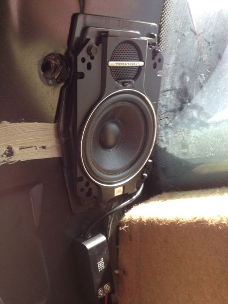

So today it was nice out again. So I decided to figure out why I only have one speaker and to install my new JBL 4x6 Plate Speakers
Installed. This is the Passenger Side, I installed the Driver Side too, but I got anxious to hear them so I didn't get a picture of that side. I have to "modify" the hole some to allow space for the speakers.
This was the result of yesterday's venture with the Battery. I think it came out pretty nice.
Yesterday, after I finished installing the KYB Shocks up front and lowered the Fiero. I noticed I probably gained about a 1/2" to 1" in gap up front. She looks like a Monster Truck now.
My Fiero has some company now, my neighbor just picked up a 1996 Mystic Cobra that has only 21,000 miles on it. Very Pretty Car.

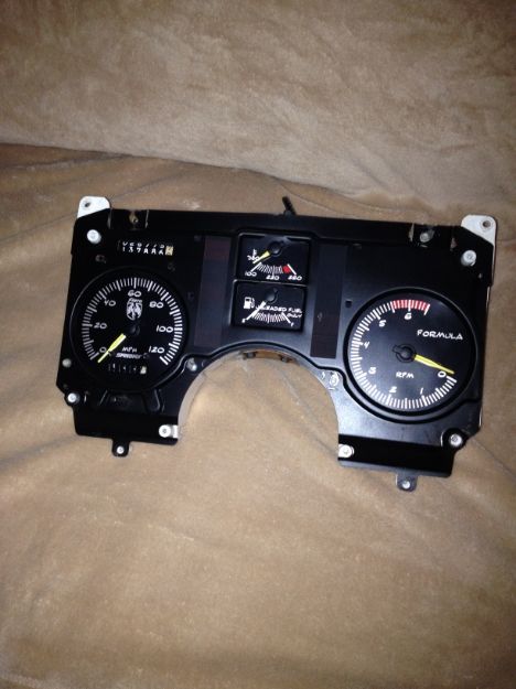

I also decided to install my Speedhut Gauges too since I am doing electrical stuff today anyways and to take a break from Soldiering. I still need to install the overlays on the Aux gauges and the AC Controls.

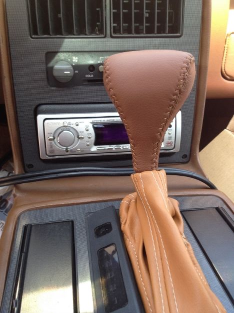

Well, the brakes still don't work. But I did get some shifter knobs in the mail today that mmeyer86gt/gtp recovered for me. Excellent Craftsmanship.
This one is a Cadillac Knob. Its out of a 1999 DeVille Concours with a dark tan interior so the button on the back is sort of not really close to Saddle, but you can't see it anyways. He recovered it beautifully.
I found a Camaro Knob so I figured I would have him recover it in case I want to change it up. This one is also recovered beautifully.

Thanks! The white smoke did stop with the new injectors, the old Multitec Fuel Injectors were junk. The scoops are Lazy C Scoops, I am probably going to take them off until I get some more deck lid vents I don't mind cutting up.

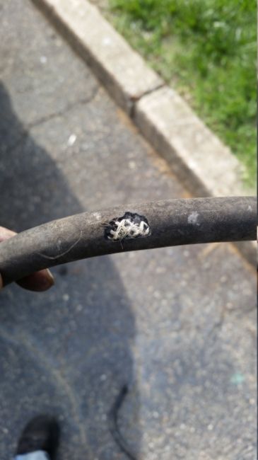

I purchased some 5/16 Gates Barricade Fuel Injection Hose from eBay and I made a Run to O'Reilly's for a Pioneer Transmission Modulator part# 747017
After I got one hose in. I discovered that the other hose was 3/8, so I had to make another parts run but this time to Car Quest and I picked up 4' of 3/8 Gates Barricade hose, which cost me the same as I paid for the 25' of Barricade Hose reel off of eBay. Oh well.
Here is the source of my fuel leak, luckily it was spraying toward the ground and not the motor, which would've been very bad.
Then I installed my new adjustable Vacuum Modulator and made 4 turn of the adjustment screw. The difference between the stock vacuum modulator and the Pioneer one is funny.
Today, I drove it around and I can notice a huge difference in shifts than before, much quicker. Now I am just waiting on my brake rotors to show up from fieroguru and I believe she will be ready for the road. Finally!
