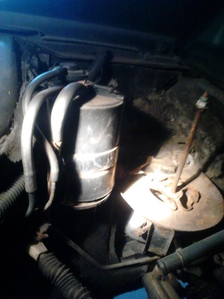

Firstly, I believe this to be the EVAP canister, and obviously I won't need it anymore and the lines that run to and from it. If someone can confirm that I would appreciate it.

First pic - Yes - it's the evap canister - it can be removed if your local laws don't require it for emissions, inspection, etc.
