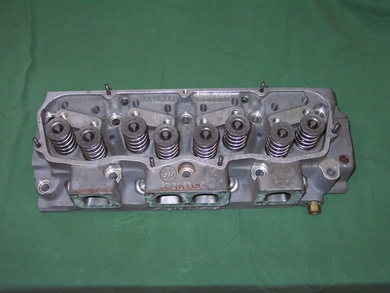

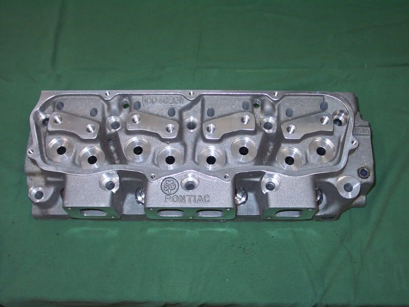

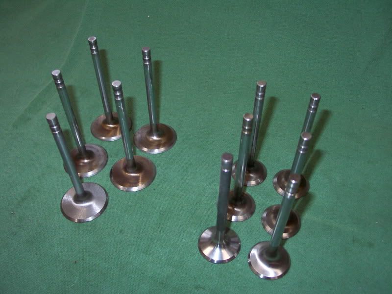

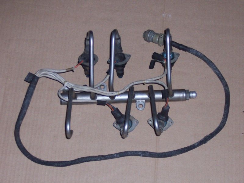

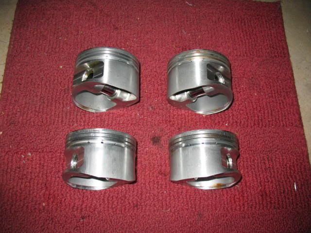

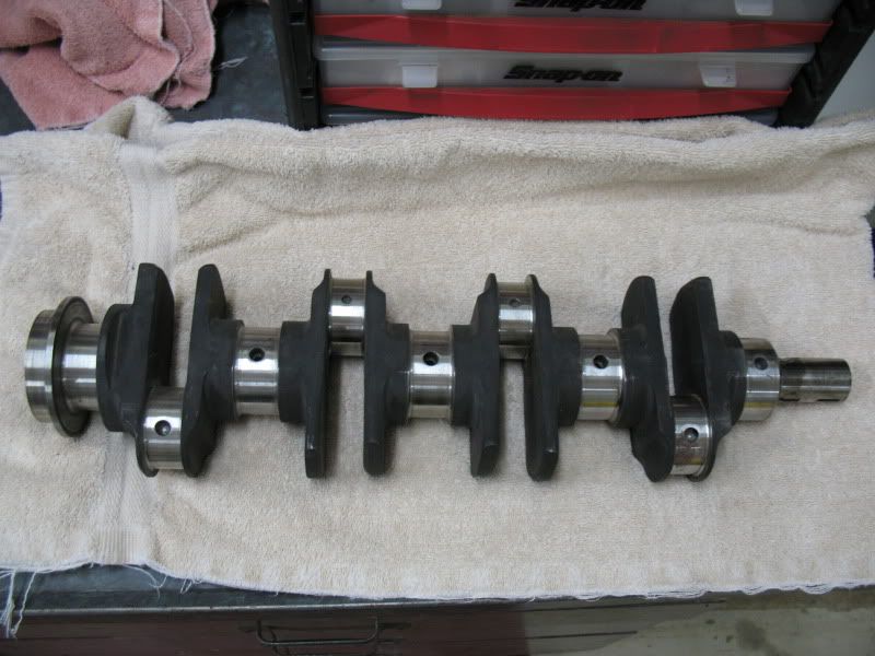

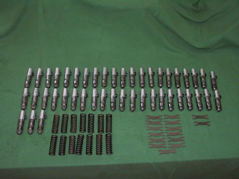

The Motor Parts I have

The connecting rods look like stock duke parts? The rods are a MAJOR failure point. What crank is that? Cams? Looks like the 10049801 Super Duty Four High Port Special Aluminum Cylinder Head? Have the block yet? KRP still makes the block if you don't have one yet, and have the money

The 2 heads are 801's yes, that is a custom built crank 2.5l as for the rods they may be stock havent checked yet. I have paid for one block and put a deposit on another however i will wait to post details and info on them until both transactions are completed, the deals originated from PFF though.
However i will say i am going to build one as a fuel injected race motor, and one will be a weber'd street motor. An Indy is the next fiero for me and it will probably get the FI Race motor (Long ways away.)

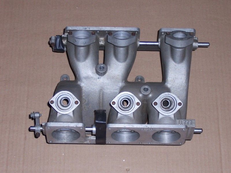

Also got the Build kit and Oil pump today as well, weber manifold and torque plate on the way.
Also im buying an ITB intake for the 2.8 right now for later in life when the SD4 becomes a display pieces and i want the 88 to go back to #'s Matching, but dont dwell on this as i am giving no info out.

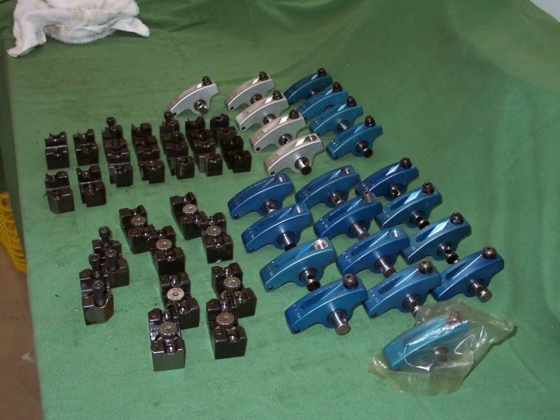

Looks like a nice build thread. Just wondering about your rocker arms, what brand,ratio and part # ? Been looking for some Jesel 1.6 but not for sure on the part number. This would be on my 3.0L build

Well all the rockers are jessel, i have 21 total, 8 1.6 ratio, and 13 1.55 ratio.
If you do a google shopping search there sets for some pretty hefty prices, i was lucky to get them almost new for cheap.

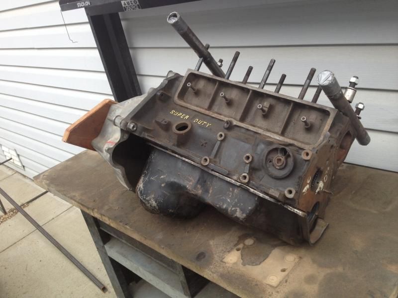

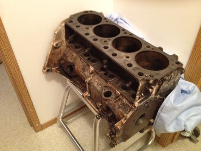

I will be getting the block next and maybe the intake manifold aswell.

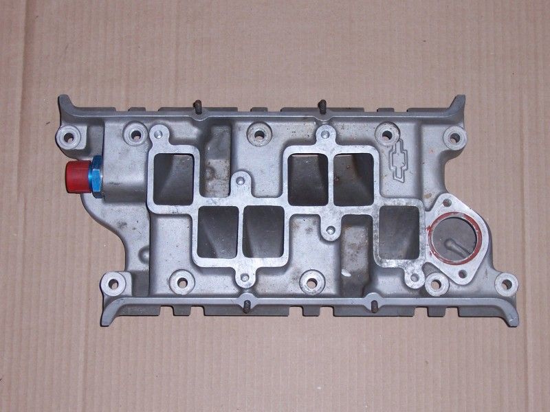

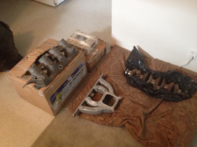

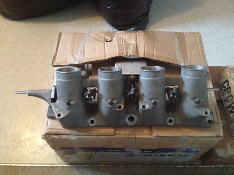

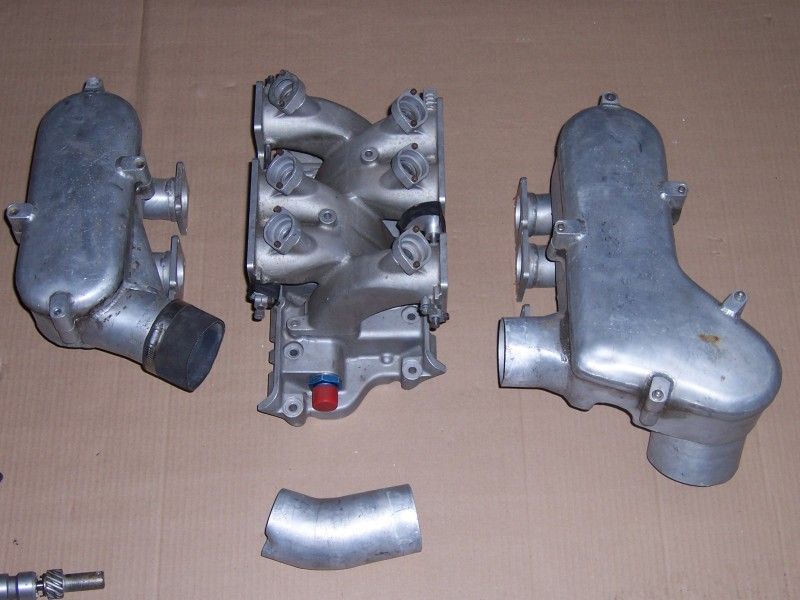

Alright, many months later most parts are here for the build, now im contemplating what i want to build a Falconer V6 or SD4, what are your opinions.???
Just a little teaser, not sure if they ran boost to the common plenum but i think im going to run it N/A.
I got Falconer Ported Heads the forged Falconer Rods and the Falconer intake and custom made plenums.

that falconer intake is awesome. only seen pictures of one other one

And this arrived today, for $40 from BC i figured it was a deal;

Figured i would throw one of 2 SD4 blocks up aswell, this is a used block, dirty but i havent had a chance to clean it up so it will look better than it does now.
Actually now that i think about it it used to belong in the IMSA Replica now owned by PontiacKid i beleive, Its from a yellow IMSA either way.

Well as the parts collection continues I have picked up a few new jems, unfortunately my wife and I just purchased a house so the build will be on pause for a while but here are my latest parts I have bought.
Brand new SD4 Block, never even left the original crate,
Large load of parts with the real Jems being the Pontiac SD Intake and the crank, numbers are worn of of crank so I have to do some digging as to which one it is,
There you go hopefully this hold people over for a while.

Self Bump because I want help identifying the Crank and Intake,
I figure the intake is Pontiac Part # 10031330 (Super Duty Intake Manifold "Racing")
The crank looks mighty similar to Fierosound's but who really knows I need to figure this out.
Come on Fierosound im calling you out hahaha.

Well did a rough measure and im getting roughly 3.50 so now I don't know if its a 2.7 or 3.0, I have a 2.7 though and they look nothing alike so who really knows at this point.
fierosound
Posts: 15253
From: Calgary, Canada
Total ratings: 286
Report this Post06-13-2013 01:23 AM Click Here to See the Profile for fierosoundClick Here to visit fierosound's HomePageSend a Private Message to fierosoundEdit/Delete MessageReply w/QuoteDirect Link to This Post
There were several SD4 cranks available for displacements from 2.0 to 3.3L
(with 4.000" bore) so engine could be used in many racing classes.
PN 10042835 2.600" stroke - 2.0L
PN 10027778 3.000" stroke - 2.5L
PN 10027779 3.250" stroke - 2.7L
PN 10093312 3.625" stroke - 3.0L
PN 10041860 3.9375" stroke - 3.3L
The intake looks like a Kinsler manifold. Fits the 437 and 801 cylinder head.
Scroll down this page http://www.kinsler.com/page--GM--17.html
DarcyJL

Report this Post06-13-2013 03:04 AM Click Here to See the Profile for DarcyJLSend a Private Message to DarcyJLEdit/Delete MessageReply w/QuoteDirect Link to This Post
Well I didn't think it was a kinsler but now im googling pictures it definitely is and as for the crank I guess a good measure is in order as the numbers have been ground off.

I think the Kinsler intake is intended to be used with the engine tilted 23 degrees - and the stacks are then vertical.
This then necessitates additional oiling on top of the head (a rail of some type) and a dry sump system.
I'm sure I saw information on this in the SD4 Guide.
Not sure how transmission alignment is affected. Not even sure if engine fits in Fiero engine bay that way.
... or never mind. Probably doesn't make a difference.
https://www.fiero.nl/forum/A...110502-1-078841.html
PS - it's really hard to find SD4 stuff. It seems that a lot of what comes up ties back to my Indy thread.
