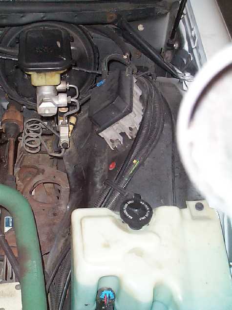

Originally posted by bluefiero:
I just talked to one yard, they said they had a 95 monte carlo there with the cruise still intact. $60 plus tax for it. He said it wasn't a 3.4 dohc though and it didn't need to be. Is this true?
It should work fine. They are all pretty much the same in all W-bodies. Here's a picture of what you need:
Although I'll say, that's a high price for the unit.
These well help you with the wiring from the cruise stalk and brake switch. Save them as soon as you can before they get deleted.
http://dtcc.cz28.com/files/electcrz.zip

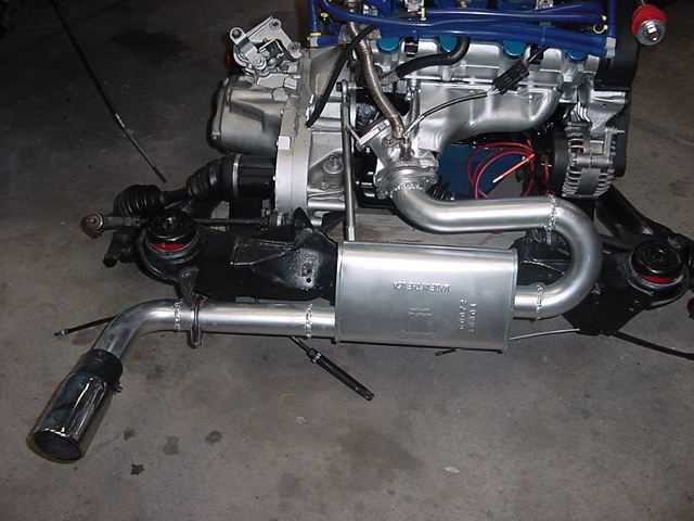

Report this Post07-11-2008 03:07 PM Click Here to See the Profile for Doug85GTSend a Private Message to Doug85GTEdit/Delete MessageReply w/QuoteDirect Link to This Post
I have a question about space in the engine bay and the exhaust. I saw this photo from another build thread:
Will this fit as is or would it require cutting the trunk?
