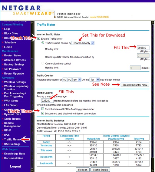

To stop you from going over limit, check your Router!
Some new models have a feature to stop hitting the limit. Just login to your router and see. Netgear's Traffic Meter is one…
Use http://www.convertunits.com/from/GB/to/MB to figure GB in MB space box.
Note: Use Reset button carefully. That button will wipe counters and stats.
For Comcast, I set mine to 250880MB, which is 245GB, 5GB below Comcast's limit. I set the warning to 225280MB, which is 220GB, 54976mb, which is about 53gb, but I will set it lower (mean warning mb is greater) next month… That way I can cut off Netflix and still use Internet for rest of the month. update: warning value mb is backward... cap limit minus warning not 0 plus warning.
Current firmware, 1.2.2.44 and below, the warning is fairly useless. Only can monitor by dumping logs to Email and set an Email rule or watch http://192.168.1.1/traffic_status.htm
Use IP Phone, like Skype, Vonage, and Comcast Voice? Then use a warning with lower number to cut Netflix/etc off before don't have a phone.
By cutting off netflix etc... I mean do not use, and even unplug, the service/device for rest of that month. Blocking service on the router is good to. (No. I don't have any info to block service at hand right now...)
Using Open Source Firmware? Check them... Not a feature? Scream at them and Change Firmware.
Using old OEM firmware, check makers for update for Traffic Meter support. No? Get a new router or see if Open Source firmware will help.
I was using DDwrt v24 SP1 (Build10020) with my old Linksys WRT54GS but DDwrt doesn't have a Traffic Meter feature. So I won't use it or any OS firmware that doesn't support Traffic Meter on my new router. (Netgear WNR3500L, which supports most Open Source firmware.)
Need a new router? Check features or ask at makers web site. Router go on sale all the time but lacking this feature should be a deal breaker for most users.
