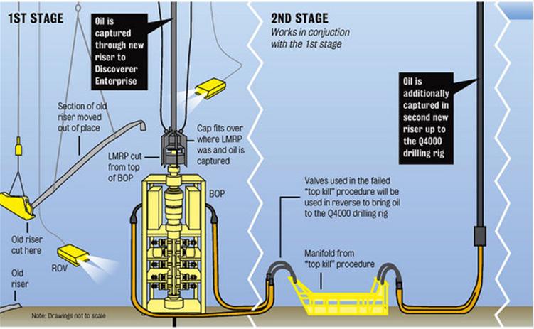

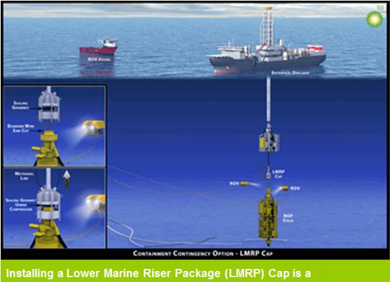

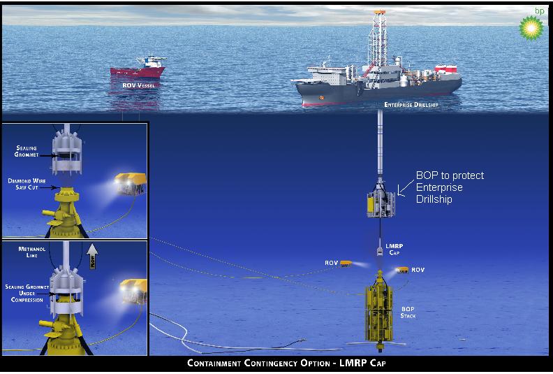

I can't really see much video as I am on dialup, but have seen what they plann to do--and in fact, are already doing. Snatched some drawings off BP's website, as well as their narrative. Some of this obviously may have already taken place.
Installing a Lower Marine Riser Package (LMRP) Cap is a containment option for collecting the flow of oil from the MC252 well. The LMRP is the top half of the blow out preventer (BOP) stack.
*The installation procedure first involves removing the damaged riser from the top of the BOP.
*A remote operated hydraulic shear will be used to make two initial cuts and then that section will be removed by crane.
*A diamond wire saw will then be placed to cut the pipe close to the LMRP and the final damaged piece of riser will be removed.
*The LMRP Cap is designed to seal on top of the riser stub. The seal will decrease the potential of inflow of seawater as well as improve the efficiency of oil recovery. Lines carrying methanol also are connected to the device to help stop hydrate formation.
*The device will be connected to a riser extending from the Discoverer Enterprise drillship.
*The LMRP Cap is on site, and it is anticipated that this option would be available for deployment by the end of May.

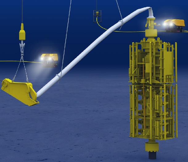

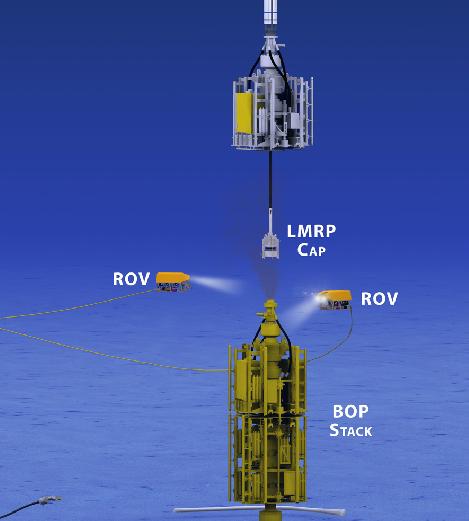

Above, is what the overall plan looks like. The drillship Enterprise will sit above the LMRP, and handle both the assy and take on (beam aboard?) fluids from a pipe coming up from the old BOPs once the LMRP is attached above those old BOPs. Enterprise, cannot handle full flow coming up a 21" pipe, so they have chosen 6 5/8" pipe above the new BOPs. The new BOPs are NOT to shut in the flow--more on that later, but understand, that the new BOPs are to protect Enterprise.
They will 1st shear off the 21" dia riser pipe, after attaching slings to hold the part they no longer want to work with--the longest part. The sheared off part is a;so the part where PB inserted their 6 5/8" "straw". That straw will suck it's last as soon as the shear cuts the pipe.
They will make one shear cut, which will also crimp the end of the pipe, some distance away from the old BOPs. They will then make another shear cut closer to the bend in the riser pipe. Only one cut is hown in the image below:

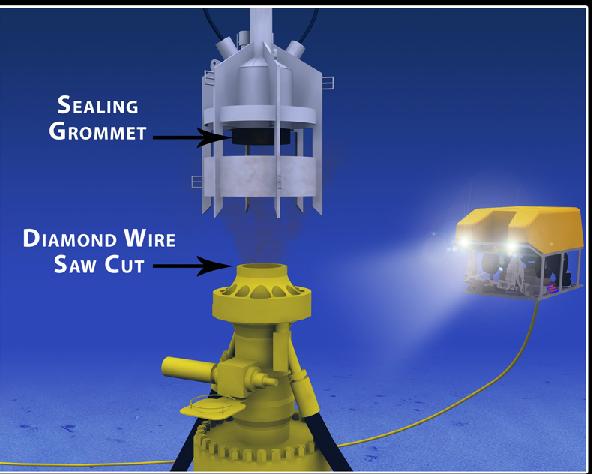

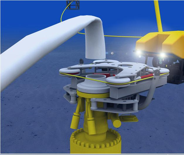

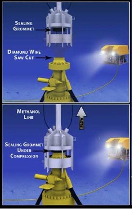

Once the 2nd shear cut is made, they will attach a diamond wire saw to the riser stub just above the old BOPs. A lot depends on how strainght and clean the saw cut ends up. A good clean cut will allow the LMRP to set down on the stub much better. Keep in mind, that the saw has to cut thru both the 21" riser and the drillpipe that is trapped by the partially closed BOPs, tho there is some speculation, that they may just cut the riser off by rotating the saw around the riser pipe, and not cut the drill pipe.
A lot will be learned as soon as the sheared and crimped riser is cut off by the saw. BP and the world--if the video is running--will know if all the flow is coming from just the drill pipe--just the annulus--or from both. Either way, the LMRP will still be set down on the stub.

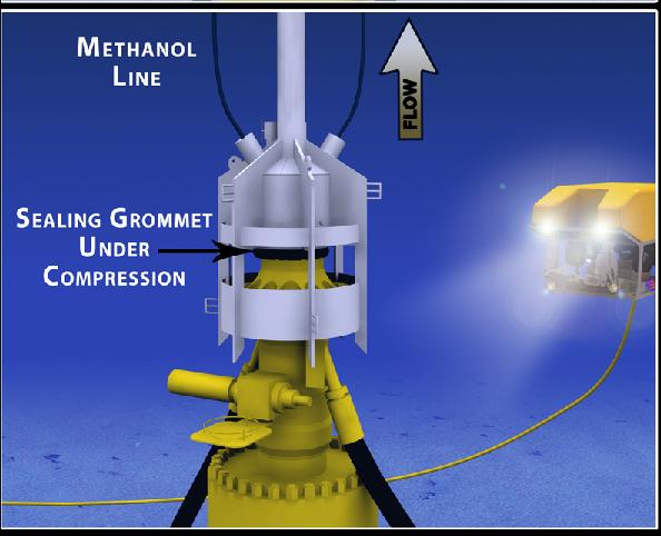

The next step is to position and lower the LMRP and it's cap down on the old BOP's riser stub.
Inside the LMRP cap, is a hydralically actuated ruuber sealing assy. It is very thick rubber, and can be envisionded like an inner tube. When Hyd pressure is applied, the od has no where to expand to, so the ID gets smaller and seals around the stub.
This seal, is going to be subjected to about 5800 psi oil & gas. Expect it to leak some, which is good in a way. It will keep seawater out. The seawater mixing with the expelled oil/gas mix is what causes the frozen problems they encountered in previous attempts to capture the effluent. If they get a perfect seal--even better, but keep in mind, the seal is never going to be good enough to hold the LMRP assy in place vertically should the new BOPs be closed. A sudden kick, could push the whole assy off the stub, which is why they may chose not to close the new BOPs up above the LMRP cap. As you can see from the pics above, they have added some brackets (for lack of a better word) to help guide the LMRP cap and assy down on to the old BOPs. A lot of the guide work tho, will be done by operators on an auxillary ship via the ROVs.
Here's what it should look like set down in place with the seal inflated. The methanol injection line is to help prevent frozen hydrates from plugging up the pipe going up to Enterprise. (where no hydrate has gone before)
It will be up to Capt Picard on Enterprise to hold position. Hopefully, the weight of the new BOPs, the LMRP, and the 5000' of 6 5/8" pipe will be enough weight to hold everything down in place during normal flows and if they should see a sudden unexpected kick of effluent..
There is a risk, that the added hydrostatic head in the new assy and pipe, will cause more leaks around the old BOPs that are still attached to the wellhead. That entire assy has already been stressed far more than it was ever designed to be, has endured Deepwater Horizon sinking, the riser crashing down, and 40 days of scouring oil/gas flowing thru it at a high velocity and pressure.

im still confused on why the original pipe was 21" in diameter, yet they are going to attempt to attach a 6.675" pipe to the new adapter to bring the oil up.
one would think that installing the smaller pipe would increase pressures greatly.
i figure they might get away with a 12" or 16" pipe, but cutting the pipe by 15" in diameter is bound to cause alot greater pressures.
matthew
I said that as well. Stupid idea, stay with the same size pipe or even bigger to lower pressure.
matthew
Matthew/Steve:
I've seen it explained elsewhere, in math that I didn't really understand much, but it comes down to trying to keep pressure up enough to keep frozen hydrates from forming as the gas goes out of solution. That's been a problem all along. The other thing is, the drillship can't accept the flow rate that a 21" pipe running wide open would cause. The smaller pipe is a throttle valve of a known dimension, and that known restriction is something they haven't had before. I don't 'know' all this for fact, but that's just how it was explained to me.

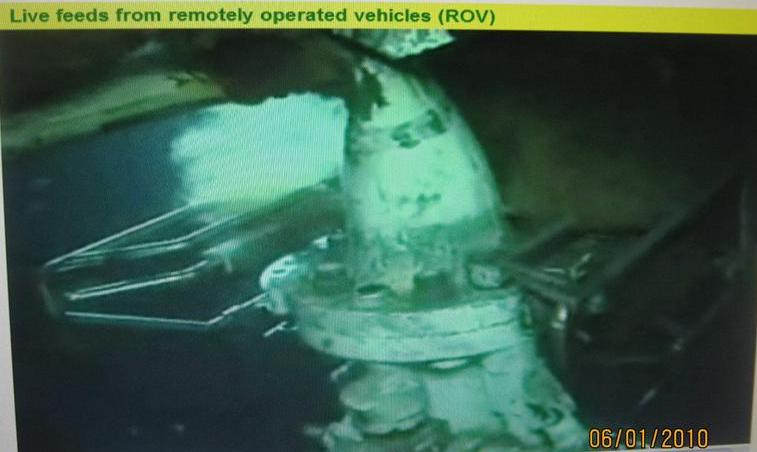

I've been watching most of the day, except for when it was offline. Most of the day was watching the ROV was just wandering aimlessly around. I know it wasn't doing that, but it sure seemed like it after awhile. Almost like whenever BP doesn't want someone to see something they send one ROV out to just wander.
Right now one ROV is cutting a small diameter pipe that looks to have something flowing through it, though whatever it is is not coming out in force.

They've got the big shears out again. Looks like it's just crunching the pipe.
They've removed the smaller diameter pipes that were on the outside of the larger one.
Edit - Looks like they've made the cut.
Hmmm... Either that or they've just managed to crimp the pipe and all the oil is spraying out from the bent pipe above the BOP.

Looks like they're sawing the riser now.

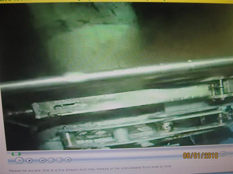

You can see the progress by those vertical marks on the metal beam below the rotating pulley as the machine moves itself forward to the left. Wow, no shortage of cutting fluid now.
[This message has been edited by jetman (edited 06-01-2010).]

Here you go, this one will freeze every 7 seconds or so but it's not a loop, it's making progress as indicated by those marks on the metal bean and it's getting deeper into the pipe.
Man alive, that's one mean cutting saw.

Sorry Steve, I can't seem to get a screen shot for you. You cannot see the progress due to the billowing clouds of oil, last I saw was about 1/7th the way through the pipe. Maybe someone can get a picture up for you.

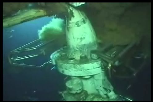

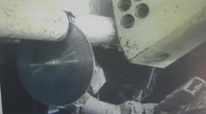

From earlier today when they were using the diamond cutoff blade to cut the choke/kill/hyd lines off the outside of the riser:
About an hour ago, using the diamond belt cutting on the riser--you can just see the bend of that pipe in the background. Sorry is dull--that's what happens when ya take a screenshot the hard way--using my digital camera to take a pic of what is being shown on my monitor.
