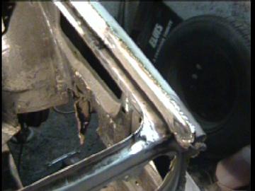

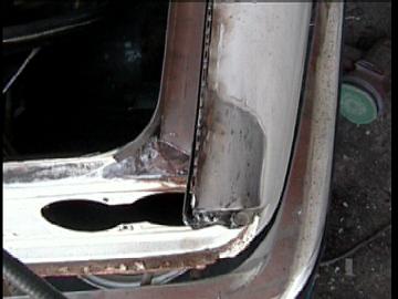

After a week or so doing other jobs for cashflow, I have started rebuilding the rear body panels..not much to see, but here are a couple of pics..
The inner panel in the rear upper corner is totally rotten, so replace that section..
and then the outer piece..

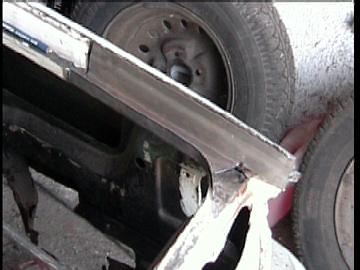

and also the top corner of the rear wing...

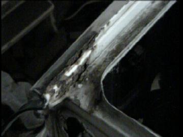

same for the other side..as was... ..
and as is now...
