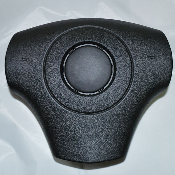

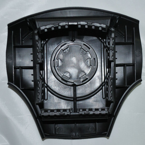

Also in prep for the mounting of the new steering wheel next week, I picked up the remaining pieces for the C6 wheel:
Saturday morning, I have plans to go to the salvage yard and pull the airbag bracket from a blown air-bag...this piece snaps into the cover plate above...which allows the front cover to lock onto the steering wheel.
Here is what it looks like with a fresh airbag loaded:
I just wont put a new airbag in the bracket.
The only things left to do once I get the wheel back on Monday is wire the horn, which I have already figured out
