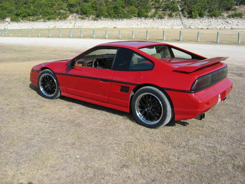

Front: 17 x 7 38mm
Rear: 17 x 8 35mm

Nice car, thanks! Anyone else? Pics viewing the car from the front? I am curious as to how the fronts look (how far they stick out)

What tires sizes are you running on those ASA's TXGOOD, and is your 88 lowered?

My tires are
Front: 215/45-17
Rear: 235/45-17
Lowered about 1 or 1-1/2 inches
