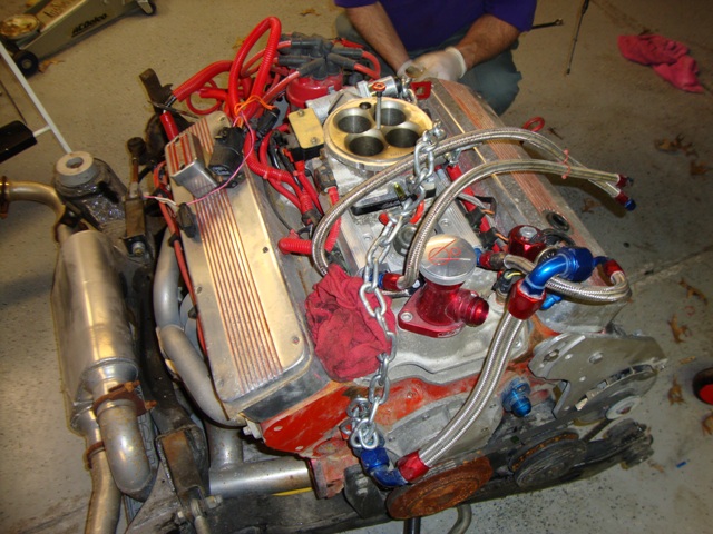

Ninjabruce has one. It is for sale if you don't want all the headaches of a build.
https://www.fiero.nl/forum/Forum4/HTML/053810.html

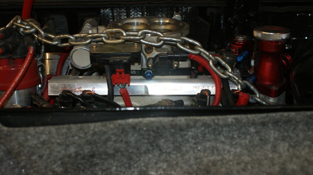

I have one, My best friend built and installed it in my 86 GT while i am deployed.
Jake

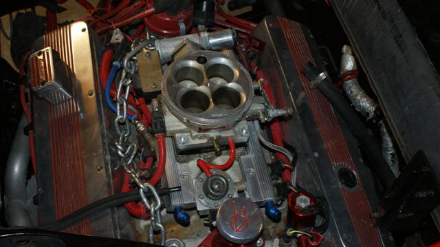

Several people have put a 383 stroker in a Fiero...
From personal experience.. the drive train for "The Dirty Rat" was a 383.. and it was OMGORGASMIC AWESOME when Chester took me for a ride once.

They do exist and mine may be able to run some day.

Was that the heart of The Rat??

Yes, yes it was... The rat is going to get a 3800SC once Nelson's swap is done.

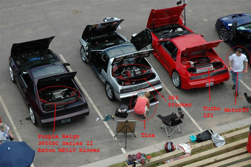

I had a 383 in Raptor..........86 Fiero GT. Tranny lasted a week. Swapped it out for a ZZ4 350 Camaro...transmissions lasted a few months then
Tina, in Chicago I think, was one of the first I know of. Dont even know if she is still on here.

I have a 383 and the only problems I have had so far are with my Centerforce clutch. It slips when power shifting......axles and tranny have lasted 10k+ miles under V-8 power.....tranny has been cryo treated though.....I might be trying a SPEC clutch in the future.
1986 SE 383 SBC w/ 5spd
aka "Homewrecker"

The older Brian, has a Red GT with a 383 stroker, and 5 speed Getrag. He says it's a 11.50 second car.
The younger Brian (which someone else I know said they were Father/Son, had a Black GT with a 283 / Auto (used to be a 327 but he blew it up)
Both cars look strong,
Tina, in Minnesota, has/had one and it was fast. If she still has it, she probably won't have it for much longer... long story there that isn't mine to tell. She pops up on PFF once in a while and the car does still exist. She started out with Isuzu 5 speeds and she broke them constantly, with spares on a shelf that could be swapped in when needed... she then switched to a cryo-treated Getrag and hasn't busted it yet. From the Dells Run 2010, a trio of nice cars:
Clay's car was the first to get a Archie fast back hatch as well... very nice car.
