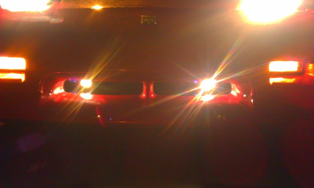

Here is mine, you can see them in the air intake for the radiator.

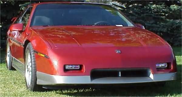

Mine here: http://fierosound.com/moreMODS.htm

I really like the way you did your fog lights, especially since the turning signals are still functional. Do you know if the products you use fit in the area where the turning signals are on an 84 Fiero?
The turn signals positions on every Fiero is the same setup. If something works on one car in that area it will work on another, even if you have a bumper pad or aero fascia.

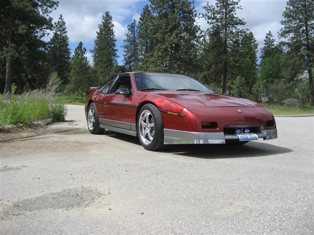

Not really fog lights, but some pretty bright driving lights...

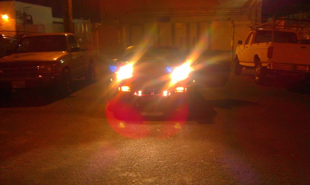

Mine. They shine a blueish white.

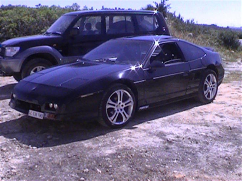

hey Nick in Spain.
what kind of fixtures are those?

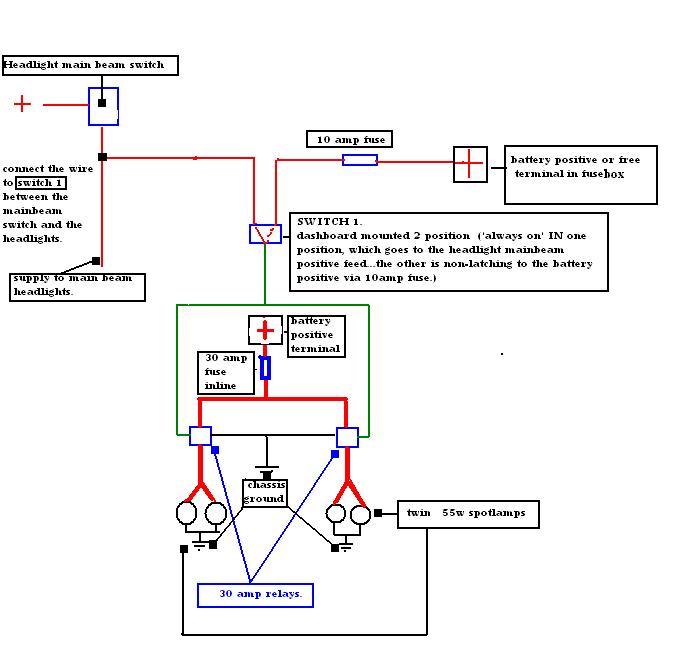

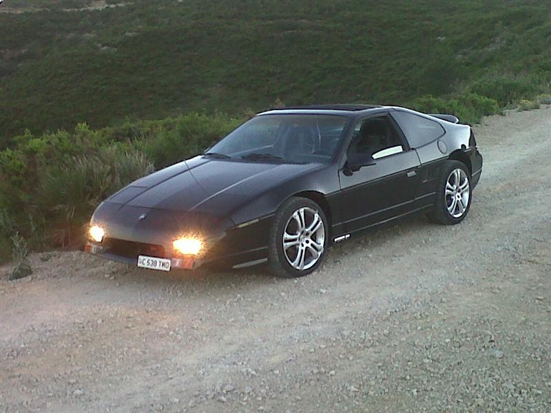

I found them in a car shop...they are twin 55mm spot/floods, 65 watts apiece. I mounted them on the supplied brackets, and wired them through 2 relays, and two switches, so they could be used with main beam, or just to flash them as a signal...because you can't use Fiero headlights to flash people
Nick
My wiring diagram
[This message has been edited by fierofetish (edited 12-02-2010).]

Thats a good idea Fetish. I know in Europe you flash your lights to indicate your going to pass. State laws vary here. In Ohio, they can ticket you for flashing your headlites....they call it aggressive driving...and you can even get points for it. Ya, Nazis run the place, lol.

Could you post a pictures of where you put your switches on your interior?

i'm in Holland at THE moment, so I will post one when I get back to Spain next week.

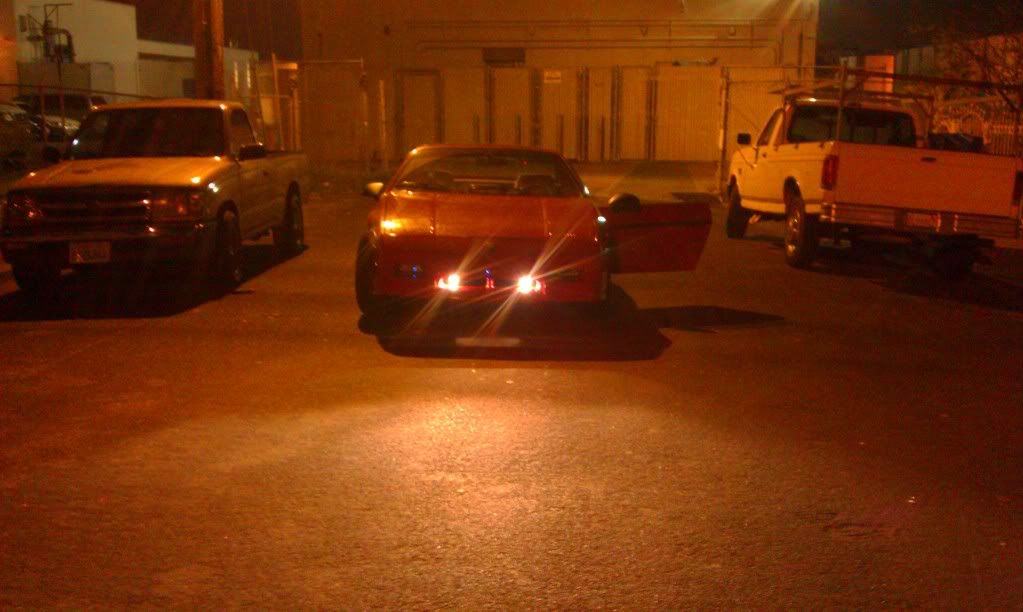

no day time pic i just finished installing them as darkness fell. that is some damn hard metal in that front cross member
