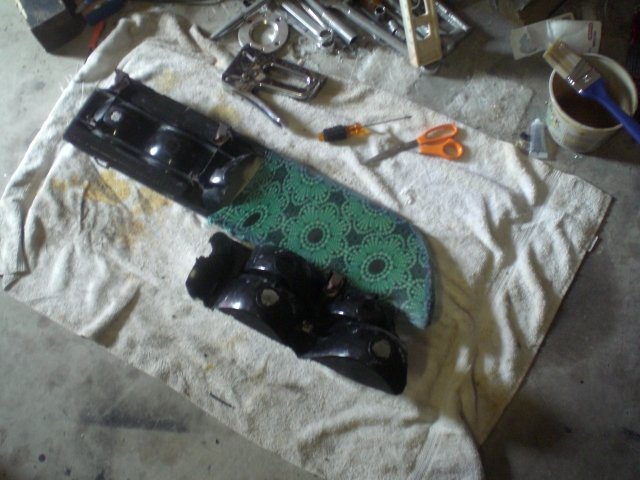

I will be doing this with a set of cracked lenses. There are chunks missing, so I will just fill them in, and cut holes for new lights. I just have to find the right style to look good.

mine are stock lenses, cut out and fiberglass buckets formed on the back side, trailer lenses...

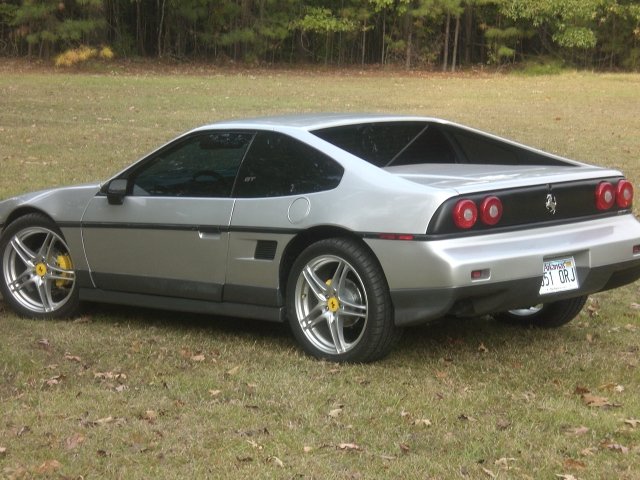

355 tailights in the stock housings.

Heres a few pics how I installed them. After cutting out the lights, I popped the lenses back on to help sturdy them up and stretched some fabric over the hole and glassed it. After dried I glassed both sides again and then cut the holes out to mount the lights. The lights are about 5 inches deep. Turned out well. Very bright.

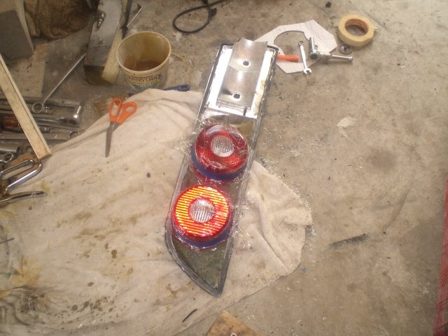

I did something like what you're looking for:
Stock GT taillight assemblies. The inners were cut out and had custom Vette taillights bonded in. The rear part of the Vette lights are from a 78-82 Vette and the lenses are aftermarket bubble lenses. Reverse lights are in the bumper cover.
....forgot to add -- also used parts of an aftermarket F355-like taillight panel too. Could never find a rear taillight panel that fit all of the curves of a Fiero, so the third one I bought I just gave up and started cutting to make it fit into the rear of the Fiero assembly......

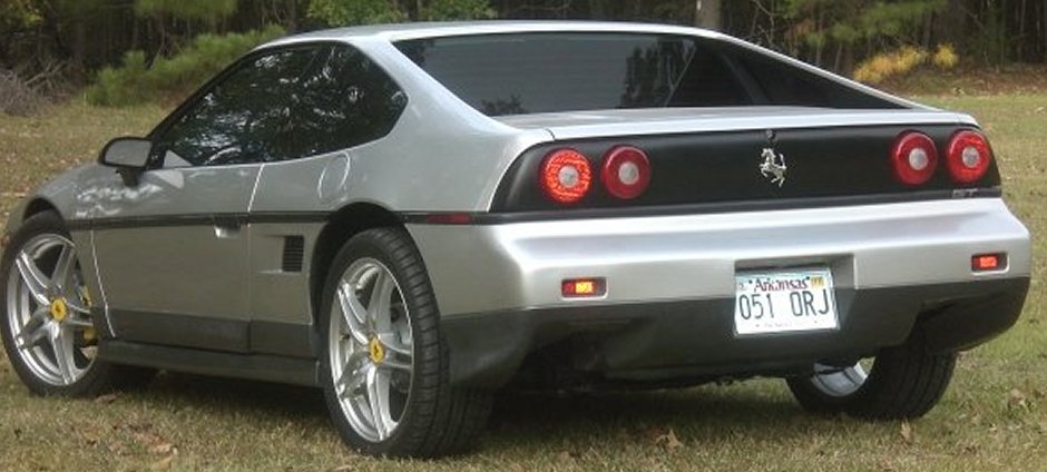

From my build thread.......
That's what I was thinking of doing with my Hella LEDs. I like how the ribbed lenses look painted.
