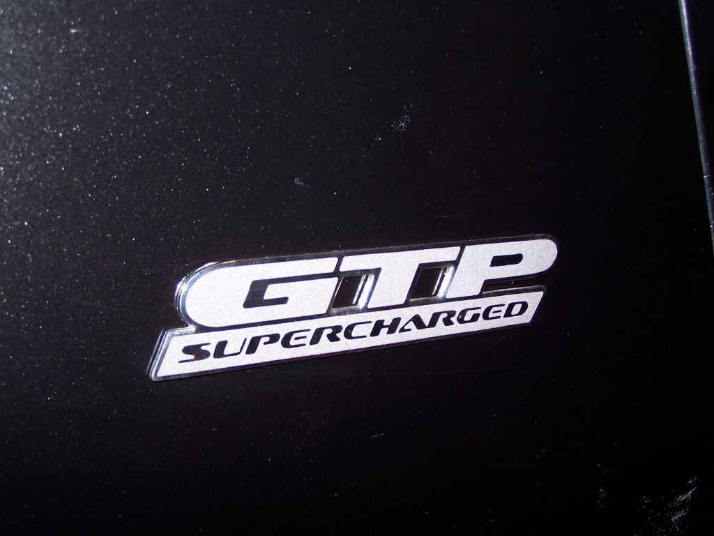

Well here is a long overdue update,
I got the exhaust done, now all i have to do is cut down the tail pipes
I have the wiring loomed up and almost done, i still have to hook up the wires to the computer and c500 and c203, but that shouldn't be bad.
The engine is now in the car and everything seems to fit, it will be hard to keep everything off of the exhaust but it doesn't look imposible
I will have some fun in making the weirdest dogbone ever
And i also badged up the car now that it truly has a 3800 in it
