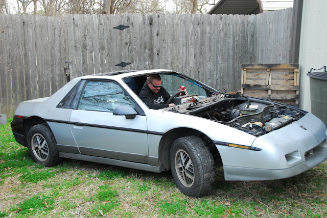

Lemons2010
Posts: 23
From: bryan, tx
Registered: Jan 2010
Report this Post02-02-2010 11:36 PM Click Here to See the Profile for Lemons2010Send a Private Message to Lemons2010Direct Link to This Post

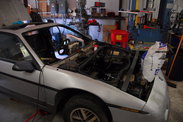

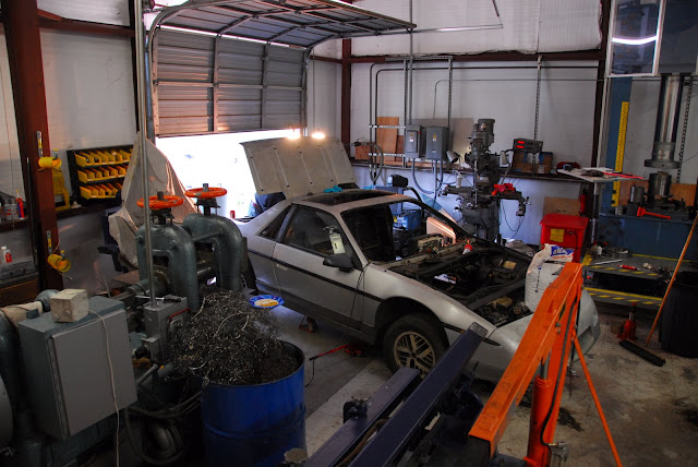

By request...
[This message has been edited by Lemons2010 (edited 02-02-2010).]
mattwa
Posts: 7106
From: Lorain, Ohio
Registered: Sep 2008
Feedback score:    (41)
Total ratings: 88
Report this Post02-03-2010 12:00 AM Click Here to See the Profile for mattwaSend a Private Message to mattwaDirect Link to This Post
Man, I wish I had a shop like that!! Nice!

Report this Post02-03-2010 12:17 AM Click Here to See the Profile for Lemons2010Send a Private Message to Lemons2010Direct Link to This Post
Not my shop... It's half of the teams employer's shop!
mattwa
Posts: 7106
From: Lorain, Ohio
Total ratings: 88
Report this Post02-03-2010 12:53 AM Click Here to See the Profile for mattwaSend a Private Message to mattwaDirect Link to This Post
Still looks really nice.

The GT 1/4 windows if they are not damaged would be worth something, not alot, but something, as would the emblems that say GT. I currently need a Front GT nose emblem.
The Sunroof is heavy, remove it, and sell it, and the rest of the top if you are able. Most members will trade you for a non sunroof top, but it's not needed for anything safety wise.
Do the Grand Am Brake upgrade, it's fairly cheap, and ads good stopping power. The Fiero Store gives store credit for brake parts, you won't get cash, but that could be a good thing.
Interior pictures would help so we know what you got to work with.
I notice the headlights are down, does this mean the lights go up and down on their own? If so they are worth something.
Obtain another sway bar and add it to the rear for more stability.

I just thought,
Cut out the hood behind the radiator for cooling, and in front of the trunk on the decklid (also for cooling).
You can remove the trunk in the rear to lose some weight, and the trunk in the front to change the airflow some.
You want as much air as possible to go past those points.
Does the car have rear defrost? and when can we see those interior pictures
I could use some power window switches that are not torn up.

Since the windshield is out, now is the perfect time to replace the sunroof top with a hardtop one, rip out all the air conditioning parts (WARNING! stock, turning on the AC turns on the radiator fan. May need to rewire the fan).
WORKING headlight setup would be worth some money. The 84-86 headlight motors are horrible. For the race, you can just have the mechanisms stuck in the up position, maybe fabricate a little bracket to replace the motor.
Oh, and get a BIG aluminum radiator. I've seen 3-row alminum radiators on ebay for $180, probably worth the expense in a 24 hours racer. Heat is the biggest enemy of these cars (well that and rust).
