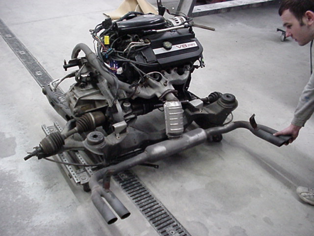

I don't have the engine in the car right now. When I had it running I had the mufffler off of the pipe . I wanted to hear it without the muffler. I did slide it up on the pipe for a 'peek' of how it would sound, It was nice an in the mid range for tone.
I will be following this system someone here used

I just got an e-mail from olejoedad, he asked me to post these for him. He sent two, one exhaust on a 3800, and the second on a 4.9 swap:

On the 88's there is room for a FlowMaster 80 in the stock location (see pictures that josef644 posted for me), but I don't know if there is room on the pre-88's. It takes carefull measuring, and the clearances are tight, but there is room.
Thanks for posting the pics for me!

Originally posted by Mickey_Moose:
...you mean like this? And yes there is lots of room for a Flowmaster 80 series (which is stock style) - of which I am considering installing this year.
BTW >> the system as shown above took the exhaust shop 1/2 day to make up and it costed me $400 (that is Canadian dollars, so closer to US$300 at the time this was done) - but then this shop does a lot of custom exhaust for hot rodders, so they may have a bit more experience. All I did was take the car in, told them exactly how I wanted it - they gave me the options (muffler type, tips, etc) and I picked it up at the end of the day.
If you need a cat, use stock 92-93 Deville manifolds, cap off the port on the trunk side, custom build y-pipe as in the stock 2.8, down to the cat in the stock location, and then out to a stock type muffler in stock location. It really is not that hard - people always look for the easy way out.
There isn't a Catalitic Converter there in your picture. They don't do the 'sniff' test or the 'Dyno' test here , but they do look at the exhaust , the converter, and eyeball the tires. A quick road test to check for "Check Engine Soon", "brakes" and end with setting the parking brake. Your exhaust would not pass inspection here in San Jacinto County, Texas

http://s10.photobucket.com/...w¤t=MOV01E.flv
Flowmaster 50 series with bullet cat. 2.5 in 2.5 out. Sounds mellow but is throaty when you put your foot into it.

I like to do the down and under exhaust using 2 Eldorado front manifolds
Engine from the front
From the back.
I find that the down and under exhaust routing cleans up the engine bay and reduces the heat in the engine bay.
Joe Sokol

I am a fan of the down and under routing also, but I think it is only practical if you can get by with out a cat.
