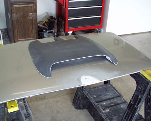

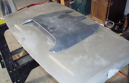

I started to create one... but never finished the project. I still have the fiberglass scoop itself & a rally roof vent (weatherproof). If you're interested, I'd probably be willing to part with them.
Here's an artist's rendering (Reality) from "way back when..."
https://www.fiero.nl/forum/A...031229-1-032746.html
Also, FieroX had a functional one as well... but I couldn't seem to find any pics.

I did a little more digging and ran across my original thread asking for people's input on a roof scoop - didn't realize that was already back in 2001!
https://www.fiero.nl/forum/A...020511-1-012815.html
