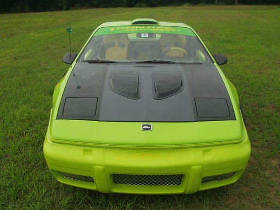

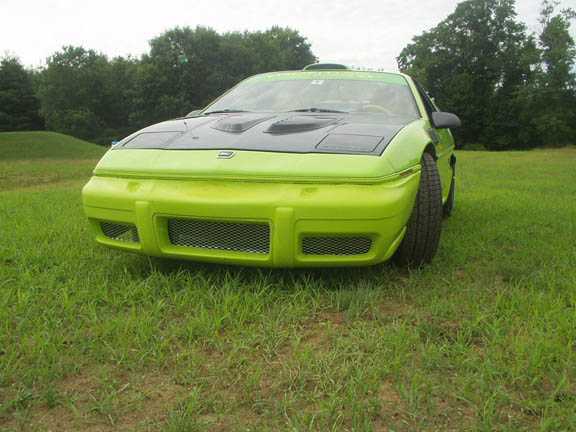

I believe Rob Bartlett (MinnGreenGT) also has one in his sig pic. Has anyone found a way to make these functional in some way other than just looking cool?

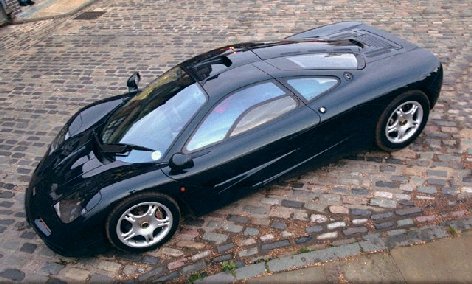

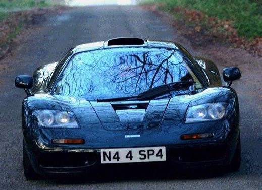

BTW this is not meant to spark any discussion about what they look like, or whether or not you like them, or why would you want to do that, I just want to know if anyone has made them work as an air intake for cabin ventilation or some sort of engine compartment intake. Like the Maclaren F1:

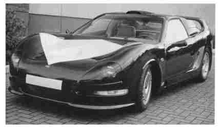

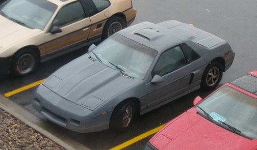

OK...OK...so you don't actually need it, I was just curious, I couldn't do it anyway because of the sunroof. As for the Finale, it has a sloped rear glass so the scoop which wraps over the roof and window (like on the Maclaren) may be doable. A functioning over the roof scoop like this would make an interesting custom effect on the Finale. Here are some manipulated pics I did a couple of years ago of the Fino with a scoop:
Can't give credit for the original pictures, I believe they came from the pre-Archie site but I could be wrong.

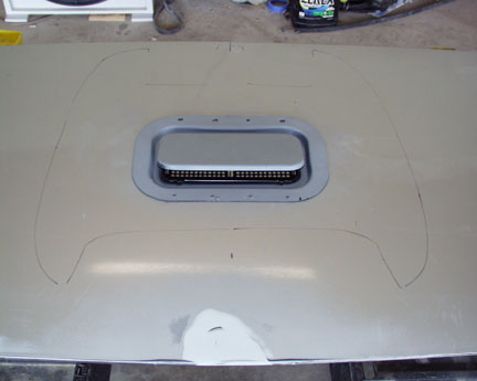

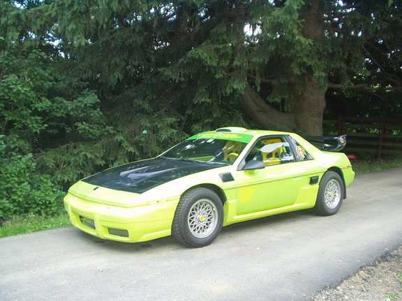

Mine's not completed yet (hot/humid weather sucks, and I just haven't felt "motivated" lately).
But yes, it is (or will be) fully functional. I purchased a roof vent (to go inside the scoop) off a WRX/WRC Rally Car (from Primitive Racing in Washington State).
Here's a pic or two to give you an idea of how it all works.
Here's the scoop I'm using (this is Jch 82's car - currently non-functional).
Here's the scoop positioned on my roof skin:
And the vent itself (guaranteed to seal):
And another of the scoop a little farther along:
...lots of projects in the works, but only a little time to work on them!

Very well thought out! Actually that is essentially how I was going to do it. I even still have the scoop hanging out in the rafters of the garage somewhere. I had every intention of finishing this project and makeing it functional, but after starting it I have changed my mind of the type of "style" that I was going for. If anyone is still interested in seeing how far I got with makeing a replacement sunroof panel with scoop let me know and I will try to dig it out and take some pictures.

Monza- simliar to an RV vent, but not quite the same. I guess I should've posted the link with the other info
Cory- It was purchased from Primitive Racing out of Washington State (from Paul Ecklund) at http://www.get-primitive.com/ (look under body parts, then under roof & hood vents). You may want to go ahead and email Paul and see what he has available, as there are a few variations. Mine is steel and came used off another car... at the time he also had an aluminum one for about $10 more.
One thing to take note of, the vent is designed to be opened front or backwards up to 6" hight - and thus needs to be "restricted" so that it doesn't exceed the height of the inside of the fiberglass scoop (I'll be putting some "stoppers" in mine before the final install).

For the headliner & interior... I'm just going to cut a hole and wrap the fabric in - I don't know if I'll do anything else until I get a little farther into the project.
Airflow? Ummm... I don't really know for sure - enough to be useful, but probably not so much that I'd eliminate my A/C
