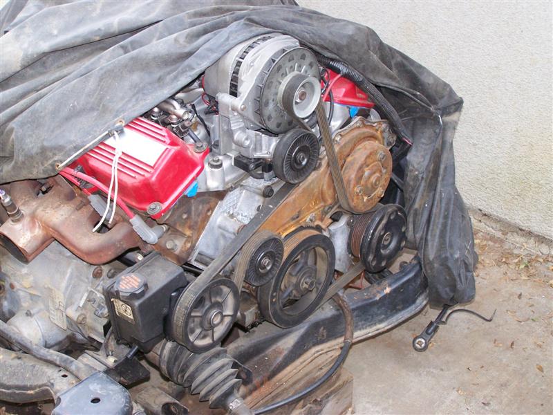

No new progress. As you can tell by the dust, this has not been worked on for a while.
The pump mounted and the stock 4.9 belt is used. I notched the alt bracket so I can use the alt as a belt tensioner. I have about an inch of adjustment at the alt.
I used an A/C compressor from an early 4.5. Mine was damaged.
