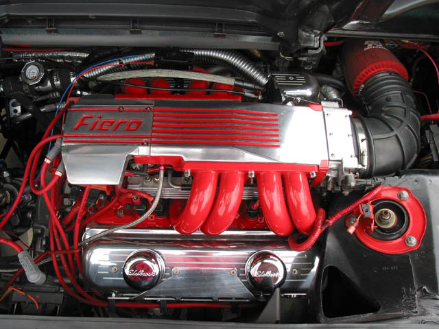

Originally posted by Alex4mula:
I think this looks so neat.
