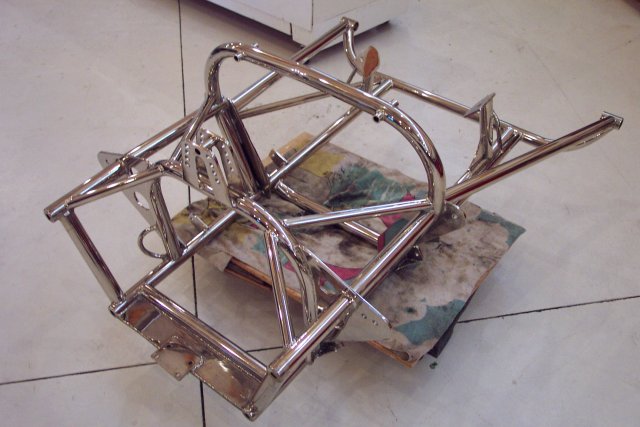

This one is my favorite:
Build thread is here:
https://www.fiero.nl/forum/Forum1/HTML/048610.html

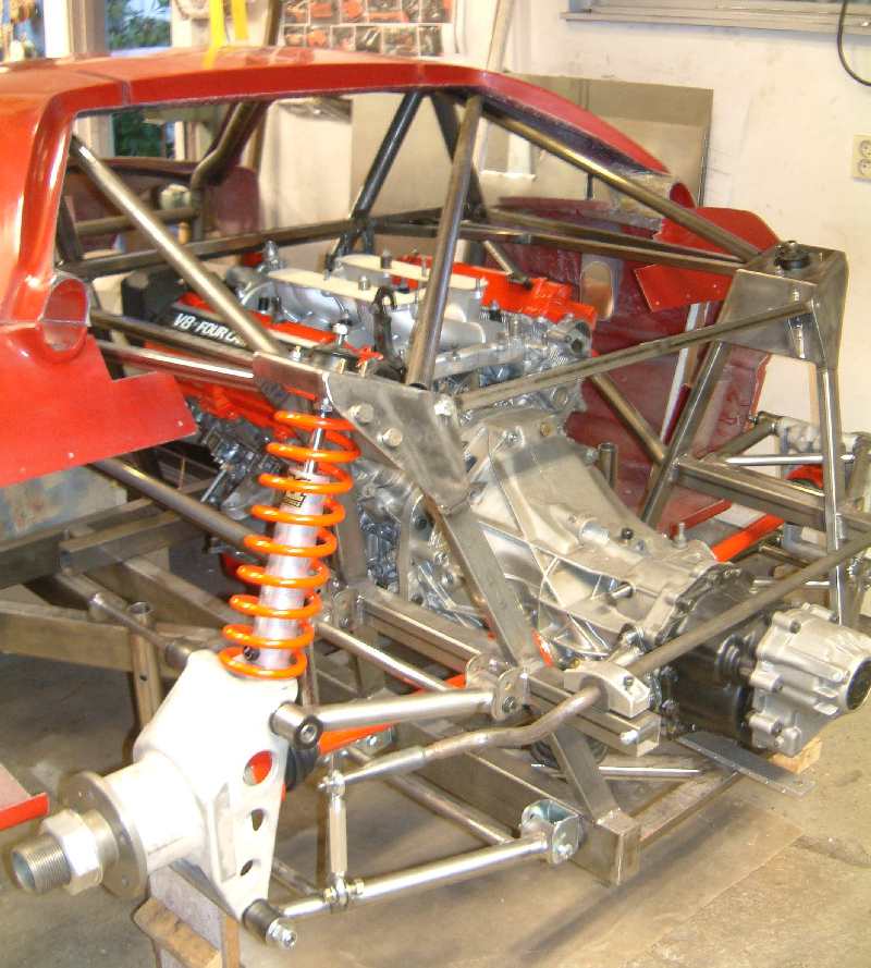

Russ Fiero (the guy doing the transverse BMW V12) is also working on backhalfing his BBC fiero and these are the pics from last time I saw it:
He is also working on an upper A-arm setup to take the place of the strut:

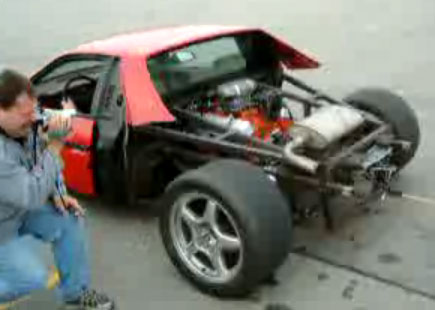

There's one on youtube: http://www.youtube.com/user/worldcarman
I wonder what happened to it.
I got to go up and help pick that one up. It is an awesome chassis. You would not believe the people that checked it out, in frame form.
Simply a work of art. It's getting a Ferrari body though IIRC. It'll be really nice, but will not in any way be a Fiero when it is done .

Here is my tubular cradle for an 88. It is setup for a stock wheelbase, stock track width and transverse mount (for my SBC/F40 swap)...
Here is the tubular cradle for the transverse BMW V12 (Russ Fiero)...

Those look awesomes I like the idea of not having to use stock strut towers For some reason have anything like that?
