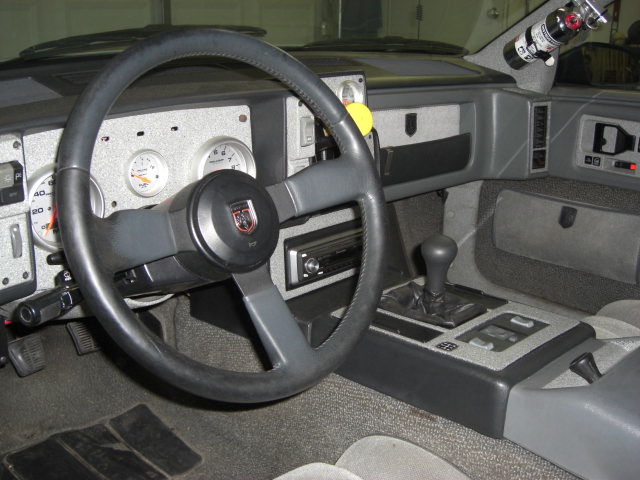

Here is a picture of one of my short shifters installed in my Fiero with the stock shfiter knob and the stock shifter boot:
Here is an interior picture of the same shifter installed:

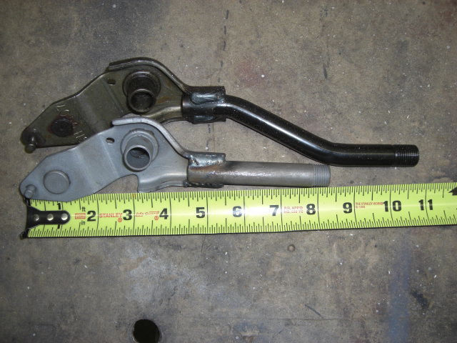

This picture is a picture of an '87 stock shifter sitting beside one of my short shifters (before it got painted black):
I have heard that the '84 shifter is approx. one inch shorter than the '87 shifter (honestly, ive never measured) but these pictures give you an idea.

I actually cut about an inch or so off of the bottom of an '84 shifter (enough to keep the offset) and put that in my dad's Fiero. He didnt like my normal height short shifters because he thought they are too tall. I have made a bunch of shafts that I could add about 1.5" in height to the height that I normally make them for custom shifters also...... Chris

maryjane & jscott1 - I see that you seem to be more interested in the '84 shifter, thats cool. But if I can be of any assistance with getting you a shorter '84 shifter, or one of my short shifters, please p/m me and we can make a deal!
Also, for anyone else who is thinking about my shortened shifters compared to an '84... my shifter is approx. 1.5" shorter than an '84. My shifters do not have the offset that the '84s have, as my shifter is a straight shaft and it will stand straight up when installed and the transmission is in neutral.
I posted a picture earlier (scroll up) that I took with one of my shifters installed in my Fiero with the stock shift knob and stock shift boot - for those who wonder what it would look like.

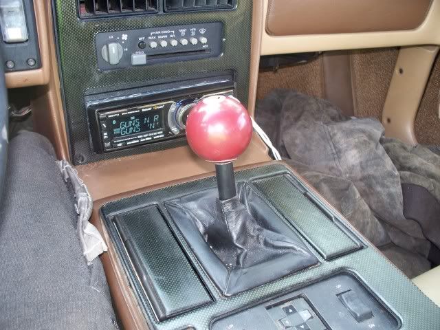

Not sure who makes this but the interest is in the knob as it swallows the stick eew sounds rude.
There was a guy who sold those knobs on Ebay. I have one (with a yellow top and silver Fiero logo). The seller seems to have disappeared -- I haven't seen them on Ebay for a while.

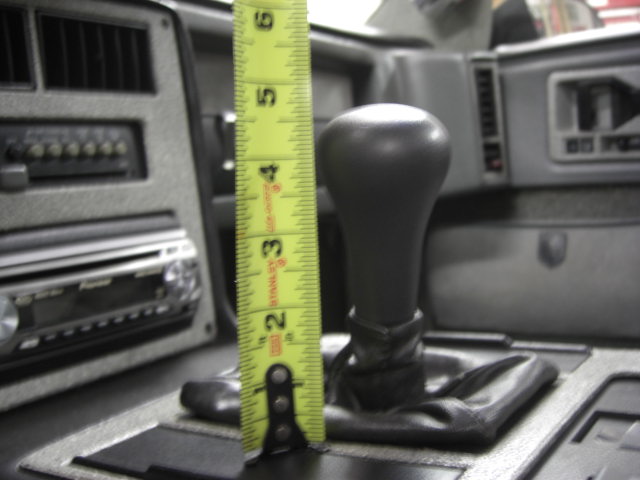

Here's one of my favorite pics... The Devolution of the Fiero Shifter Shows a cut down 84, a regular 84 and an 88
No problem, and I would not consider it a slam in any way (I know that I have a quality product with welds second to none..... but it is not for everybody).
I know exactly what you are saying with the cut down '84 shifter. I gave my dad one of my short shifters for his car - he didnt like it - so I took an '84 and cut it down, rewelded it exactly like the shifter in the picture, and he hasnt had any complaints! Chris
About the logos they seem to fade and fall off i bought one on my BMW and lost it i since made a m3 center logo fit and looks great i plan to replace my fiero centre with one from a keychain eventually as i know it wont last. The knob itself is great.

The shifters that I make are ONLY shorter handle. I take a stock shifter, cut the shift shaft off of it, then I weld one of my shafts onto it (my shaft can be welded on at a higher or even lower height if it were to be requested. The height that I chose is a very good height that will allow you to reuse the stock shifter knob and stock shifter boot. If it were lower, you would not be able to use the stock shift knob - you would have to have an aftermarket knob.
Rodney Dickman makes "true" short throw shifters. I am not in the business of making short shifters. I have a few laying around, and as I get more stock shifters, I turn them into shorter shifters then resell them to people who want to get rid of their Fiero's tower shifter.
