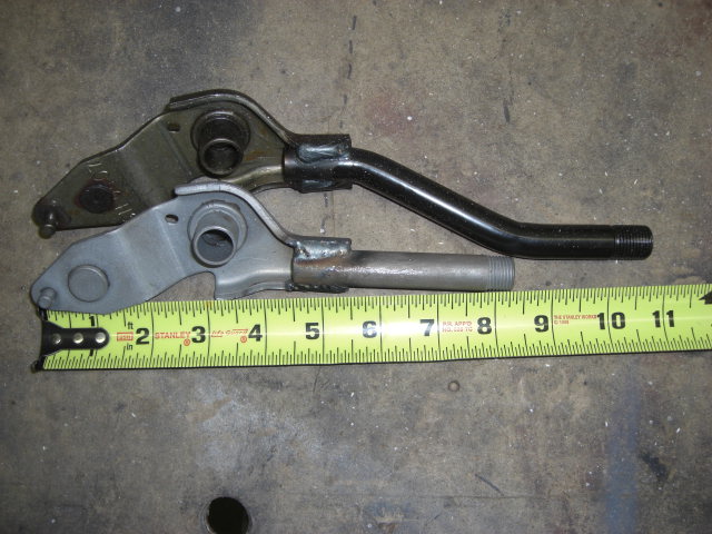

The only change that I make is a shorter shaft. I posted a picture on the first page that has one of my shifters laying beside a stock '86/'87/'88 shifter. Check it out... the only difference is the shaft that I have welded on to the lower part.
There is absolutly no change in how far the shifter cables are pulled in either shifter. It is just the shorter shaft, which creates a lower shift knob height. The lower shift knob height creates a much more comfortable feel, and a shorter distance to pull the shifter during 1-2 or 3-4 shifts.
So, to answer your question about the '84 stick compared to the '88 stick... They are essentially the same, just the '84 stick is about 1" shorter than the '88 stick. No change in how far the cable is pulled. My short stick is about 1.5" shorter than an '84, and about 2.5" shorter than a '86/'87/'88 stick.
***FYI*** Since I use a threaded rod, and weld that onto the lower shift assy. I can make my short shifters a little higher for those who are worried about not having enough leverage. I had a request to make one that was about 1/2" longer than the normal height that I usually do - and the person who bought it loves it!

I use the original "lower part" of the stock shifter, then weld in a threaded shaft that has the correct threads for the stock shifter knob.
Here is a picture of a stock later shifter, beside one of my short shifters.

If you have ever played with a shift lever you will see that it is free to move on the shaft as much as it needs to in order to shift the gears.
With most short shifters the amount that the cable moves is unchanged.
If you do change the amount that the cable moves, (by making the arm underneath longer like Rodney's shifter) it will shorten your throws, (with increased effort as well). There is no change in cable tension, the cable will move as much as it needs to in order to shift to the next gear.
