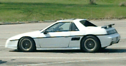

That's an 85 GT, with one coil removed from the front springs, and adjustable coilover sleeves in the rear.
Perfect! Thank you... now let me ask, do you feel the ride would be jeopardized if you had cut 1.5 coils? I'd like to see mine sit a pinch lower than that, and I want some opinionated feedback on how it feels, if you've bottomed out, etc.

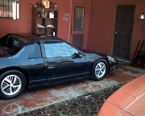

Here's what I have now (just bought it)... I don't have a pic of it unloaded yet, but you can kinda see where it sits:

This is the ride height on mine with eibach springs, and a coil cut in the front... which I figure equates to about one coil cut in the back, and two coils cut up front:
And here's the before:
That is exactly how I want the front of mine to sit, and about a 1/2 inch lower in the back. It just looks 200% better like that!

Are those 17, or 18 inch?
Your wheels like like my wheels haha.
They're 17x7 wheels, with el-cheapo 225/45/R17 Kumho 711 tires.
They look cool, but they weigh a ton, so one day, money permitting (broke 19 year old), I'd like to get lighter weight wheels.
I'd like to get Konig Daylites, in the 17x7, 40mm offset, and 5/100 pattern, weigh only 14.2 lbs each. At $195.99 Canadian a wheel from 1010tires.com
Now as I just mentioned, my opinion is biased by my probably 22 lb rims, and all that unsprung weight is horrible for the ride and handling.
It's hard to say since the ride is influenced by my modified rear suspension also, so I can't single out the effects of the front springs.
That said, with my single coil removed, the ride is not the best... but I prefer stiff go-kart handling. I very rarely bottom out on bumps in the road, then again Quebec roads are pretty bad. My bumpstops are stock. Even though it's a pre-88, there's not much nosedive on braking.
If I lived in the USA (much better roads I think), I probably wouldn't hesitate to remove another half coil.

I cut 1 3/4 coils off the front and 2 5/8 coils in the rear.
87 SE 60* Turbo
Are you kidding? That's exactly the look I'm going for! Yours is the perfect height, front & rear, but looking at 2m8's post above, I almost have to wonder if you're kidding... ?!?

Report this Post02-11-2009 11:00 PM Click Here to See the Profile for AutoTechSend a Private Message to AutoTechDirect Link to This Post
No, not kidding lol.
He has 26" tires, which I am assuming is a bigger diameter, as well as body work done. The illusion will be different.
87 SE 60* Turbo
*shudder* Heh, it's hard to believe I can make it sit like that with no money... Are yours 24" rollers? If so, everyone in this thread gets a +, because that is the exact look I'm wanting to achieve...
