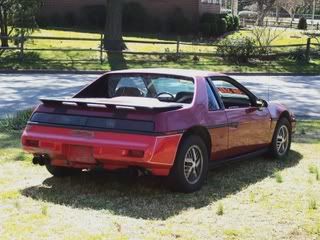

Originally posted by F-I-E-R-O:
Plymouth Duster spoiler, and here's a picture for ya...
*sniff* I miss that car, shoulda kept it...
