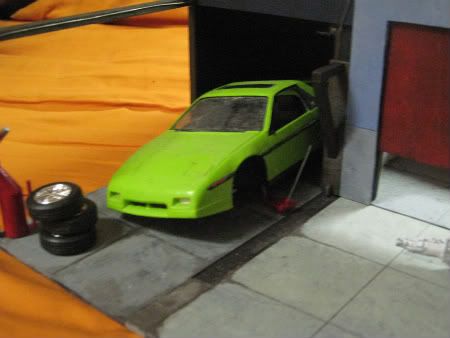

I did one of the Fiero models a while back, currently it is disassembled and awaiting rebuiding :P Here it is:
