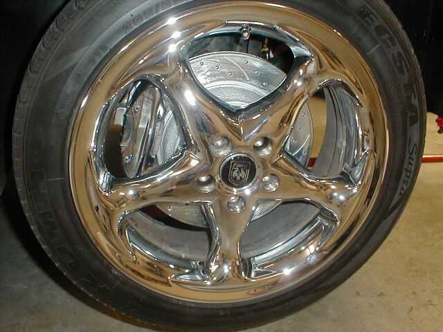

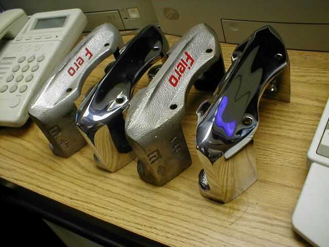

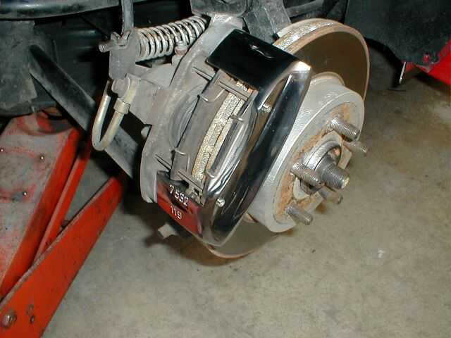

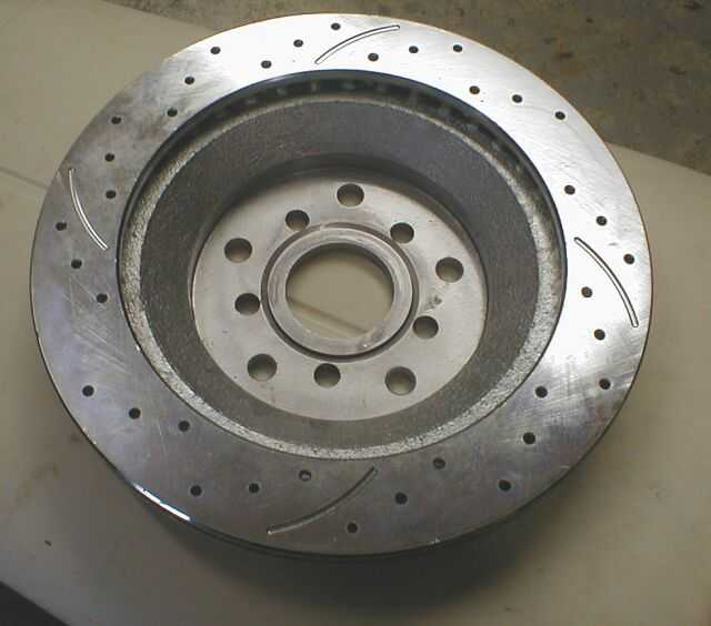

Although the 88 brakes are far superior to the pre-88 Fieros, I wanted to upgrade my brakes and was inspired by West Coast Fiero’s 88 brake upgrade kit. http://www.westcoastfiero.com/Brakes/Brakes.html The beauty of this swap is that you are only swapping to a bigger diameter rotor. The 88 Fiero caliper is retained which means you are also retaining the emergency brake. The 88 Fiero disc brake rotors are the same thickness as the C4 Corvette rotor while the 88 Fiero rotor is a 10 ½” diameter but the Corvette rotor is a 12”. WCF could not supply the rotor I wanted so I decided to make the kit myself. Most brake upgrade kits run $1000 to $2000 so the WCF kit is a bargain at $595 for all four wheels. Too bad it only works on 88 Fieros.
At the Fieros at Carlisle show, I found out that Rockcrawl had already done the swap by himself also. Thanks to Rockcrawl and Akursked I was able to figure out what I needed to do. Rockcrawl has a great web page about his brake swap here. http://www.fieroaddiction.com/brakes.html While talking to Rockcrawl he assured me the brake swap has impressive results. AkursedX also had a good thread about his experience of installing the WCF kit. https://www.fiero.nl/forum/Forum1/HTML/030023.html

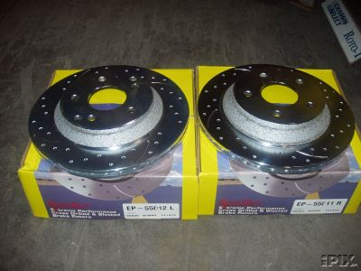

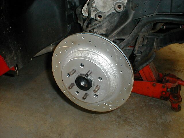

I wanted some rotors that would really catch your eye as well as superior to a solid rotor. I found some sweet drilled, slotted, silver plated, directional Corvette rotors from Parts Authority. They are out of Rockville Centre, NY and their phone number is 516-678-3900. They cost $75 each but shipping was $60 total for the four being $360
Here is one side by side with a stock Fiero rotor.

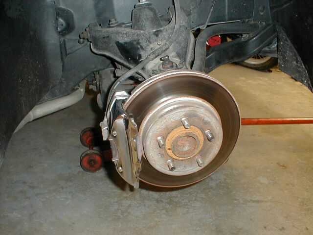

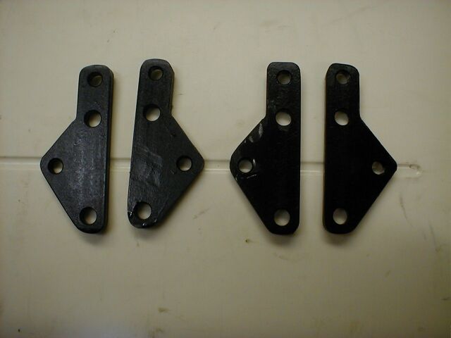

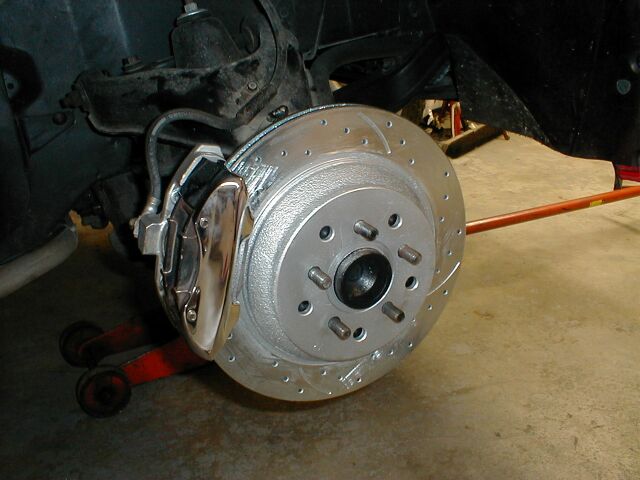

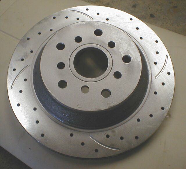

I sent the rotors out to a local machine shop to redrill the rotors from a 4 ½ bolt pattern to a 4 ¼ Fiero pattern. The machine shop also made the needed centering rings. The centering ring is tapered on the back which matches the taper on the Corvette rotor. The taper prevents it from falling out and the centering ring was also machined to have a friction fit through the center of the rotor. All that worked only cost $60 for the four rotors.
I spent a lot of time on the caliper adapters. I tried a few prototypes to see what needed to be done. Finally I decided the only precise way to do this was using computer aided drafting CAD. I teach AutoCAD at a high school so I felt this was the best way to design them. I spent a day taking measurements from rotors, spindles and calipers trying to decide the best layout. I then plagued myself by cutting some 3/8” steel attempting to make them. I stopped in to check on the rotors and asked if they could make the adapters and they said they easily could. I brought my CAD drawing to them. Wish I would of done that first. LOL They only charged me $30 for the brackets and were already to be put on since they tapped them for me as well. I picked up all my parts and was keeping my fingers crossed it would all fit.
Here is a before shoot with my chrome caliper brackets.

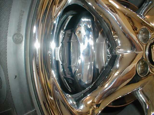

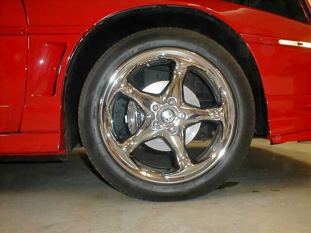

And for a before picture……..
After installing the rotors and driving the car enough to break them in, I was amazed at how the brakes inspire so much more confidence. The brakes feel stronger under normal conditions but really are at their best under extreme conditions that would overwork the stock brakes. This is definitely a modification all the 88 owners should do.

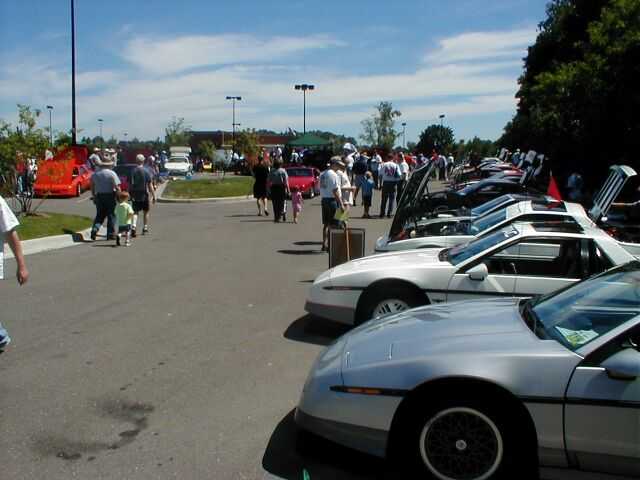

I had no experience with this type of show. I leaned on Kameo Kid for advice. So Saturday morning I was having a hard time trying to decide what was the best strategy on judging. Early or late? When Kameo Kid decided to go early, I did the same thing. Vonnie was off getting breakfast but I went without her. She arrived while I was waiting in line and did some more final touches. I was perhaps one of the first ten cars to be judged. I was really relieved to have it over with and really did not figure I had a chance anyway. Since the car was judged I could take the t-tops off and open the car up to show it off and enjoy the day.
Here is the parking lot later in the day. All the empty parking spaces are because the car is over being judged.
