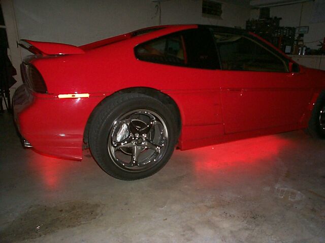

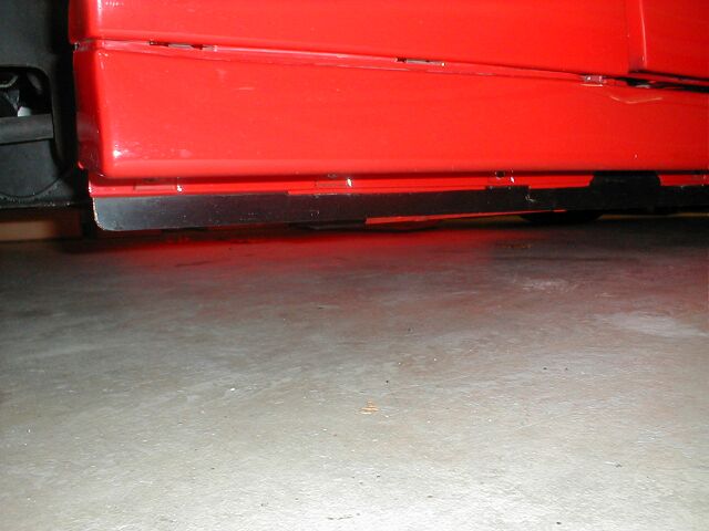

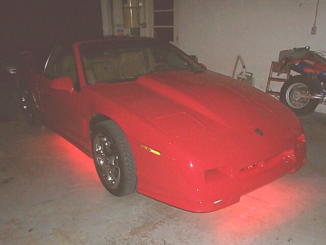

Report this Post10-01-2004 12:27 AM Click Here to See the Profile for Ken86GTSend a Private Message to Ken86GTDirect Link to This Post
Originally posted by skitime:
The Fiero is nearly perfectly flat from the bottom of the rocker panel to the opposite rocker panel. So how could I mount them with out them being seen? Some tuck the bulbs into a tight crevice right behind the rocker panel. The problem with this is that it creates a sharp cut off of the light instead of a soft glow across the ground. What I came up with worked out great. I bought some 1-½ wide aluminum straps. I remove the fasteners along the bottom of the rocker panel and mounted the long straps painted black along the length of the rocker panel.
This piece does two things. It blocks the view of the bulb and provides a “bumper” to help protect the bulb. Since the strap is black it is almost totally unnoticeable. Most people never see it unless I point it out and even then they always go over to see it close up. The side bulbs are mounted about 5 inches from the rocker panel. The rear bulb was easily mounted between the trunk compartment and the rear bumper skin.
Sorry I have had a real hard time getting good pictures of the car with the neon lights on.
Was wondering if your car is lowered at all and if it's safe to really drive it around with the lights underneath it.
I apologize if either of these questions have been answered, but I've been reading this post from start to page 5 for the past few hours and have been absolutely awestruck by your Fiero. I can honestly say yours is now my favorite because of your eye for perfection and skill to carry it out. I would love to one day see this beauty in person.
Thanks in advance.
Thanks in advance.
My car is not lowered however most people that look at my car think it is. Probably because the front spoiler makes it appear lower. It does set slightly lower than our other stock 88 GT. Driveways certainly do cause a hazard. I did scrap the side metal I added to protect the lights and block the view of the lights but so far the lights are fine.
Thanks for the compliments. I too hope we meet someday.
