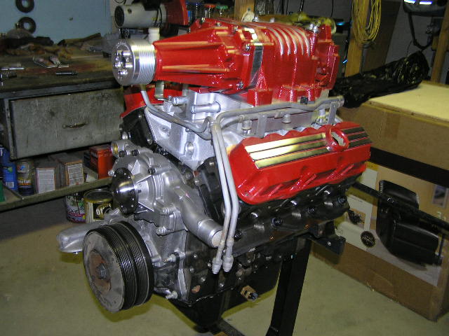

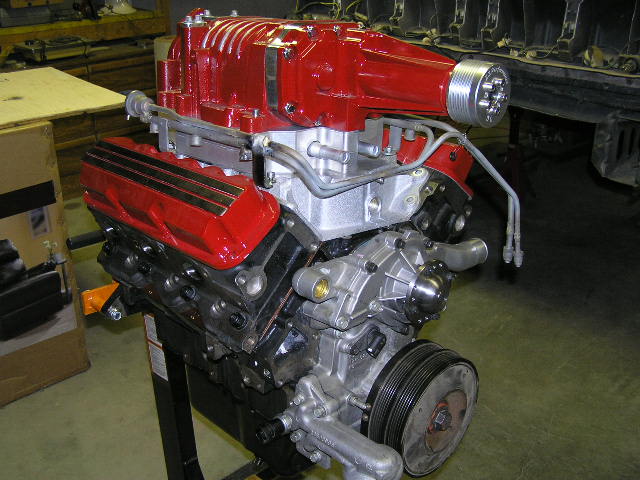

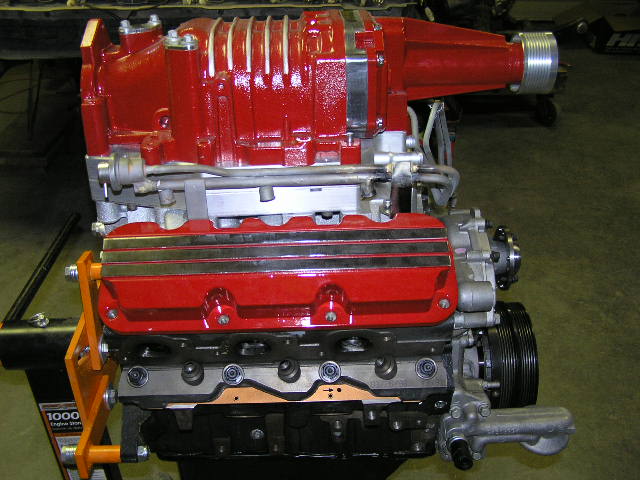

I bought a set of these rails that 3.8 SC made. I think they look really good and are a hell of alot cheaper than ZZPs. I am painting the rail black and i just havent got to it yet.

doublec4- The disadvantage of running the rails over the supercharger is that when you use an intercooler it raises the charger 2.25 inches and then you either have to use ZZPs injector spacers or you have to cut the rail and put injector hose in to lengthen the rail up. You can use these rails that run around the charger and then you dont have to worry about leaking spacers or fuel line. IMHO if you are going to run a intercooler either make a rail like i am using or buy PRJ or ZZPs billet alluminum fuel rails. Theres also the cosmetic issue of hooking up two lines on top of the supercharger. I didnt want anything running over the supercharger and i am doing to cleanest swap possible so my new lines connect down like the stock 2.8 did. Out of sight the way they should be.
