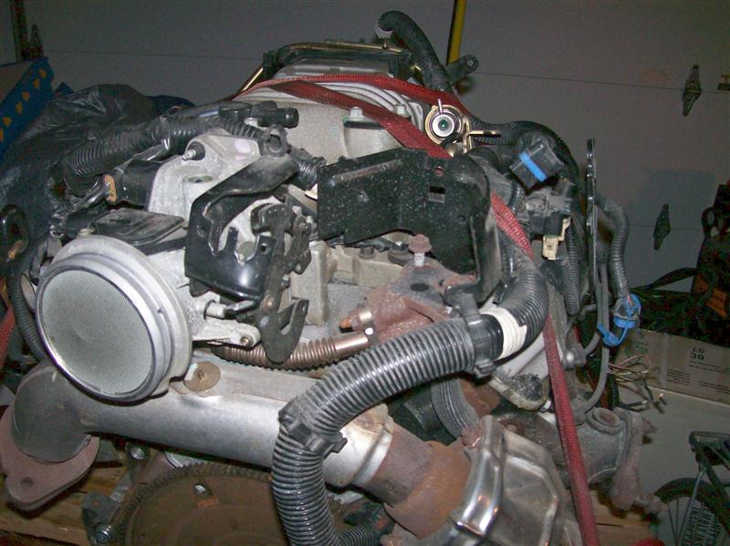

The bracket you are looking for is a large piece of cast iron that sits above the water pump inlet and bolt to the head. At the same time it has a bracket for a dogbone set-up for the car it came from ( which you will cut off ) and it hold the coil packs, on the car it came from. Believe it or not they used the same bracket on the N/A 3800's and all you need to add is the tensioner assembly & idler pulley for the Supercharger Belt.
See the bracket on the far left of the engine ???
