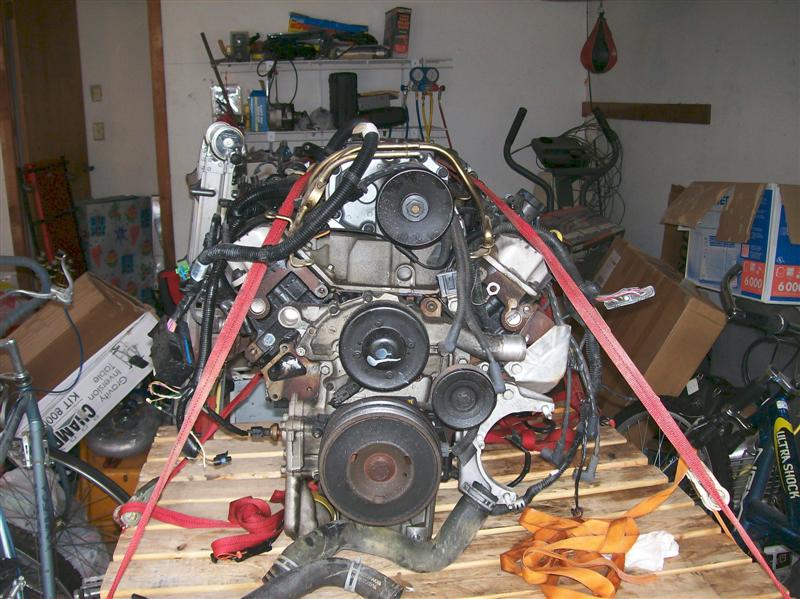

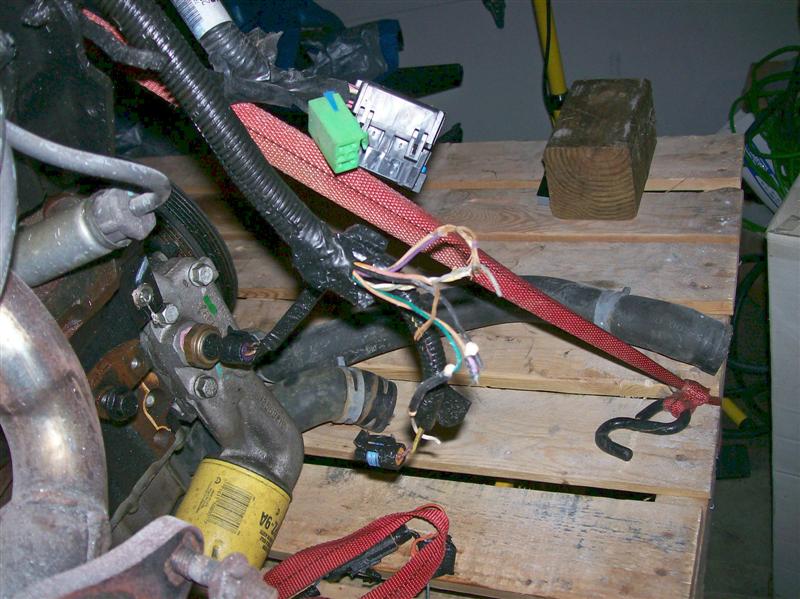

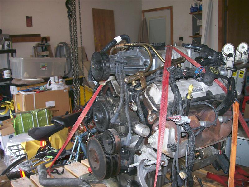

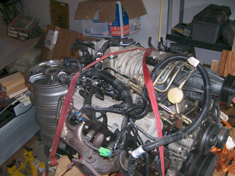

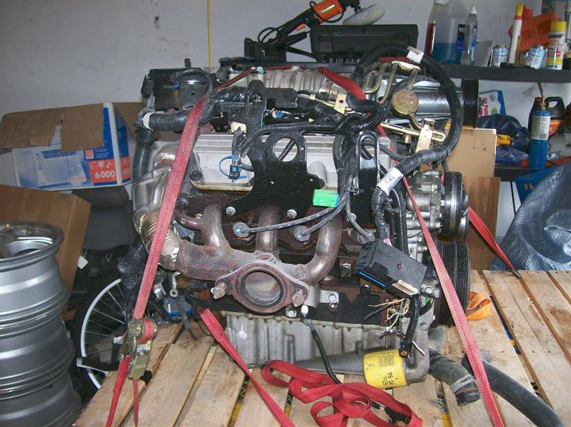

Can someone enlighten me, from the pics, as to what basic items I am missing?
The a/c---can I use my Fiero a/c there?
Alternator---?? options??
What pulleys are missing? where to source these ?
Thanks Jeff
You are missing the A/C compressor(wouldnt use the Fiero one), the Alt(can use either the 97/98-99up-Fiero/would use the GP Alt though) and the SC tensiner setup. All these parts can be bought from Ed Morad if you want to get them all at one time from a good source.

I agree! Ed Morad is the way to go, when needing 3800 parts. If you can think of it, he has it. You can find him on E-bay - http://stores.ebay.com/Mora...3amefsQ3amesstQQtZkm If a part, that you need, is not listed on E-bay, just give him a call. 216 798 6902

The injectors are missing too--going to have to compile a Needed List
a set of injectors I also need a gtp oil filter adapter and a supercharger tensioner bracket and pulley and an ignition module-I have the coils and a 97-99 ecm? I have the 2001 but I don't think it's useable?
96 camaro 3800 flywheel alternator a/c compressor

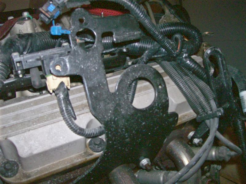

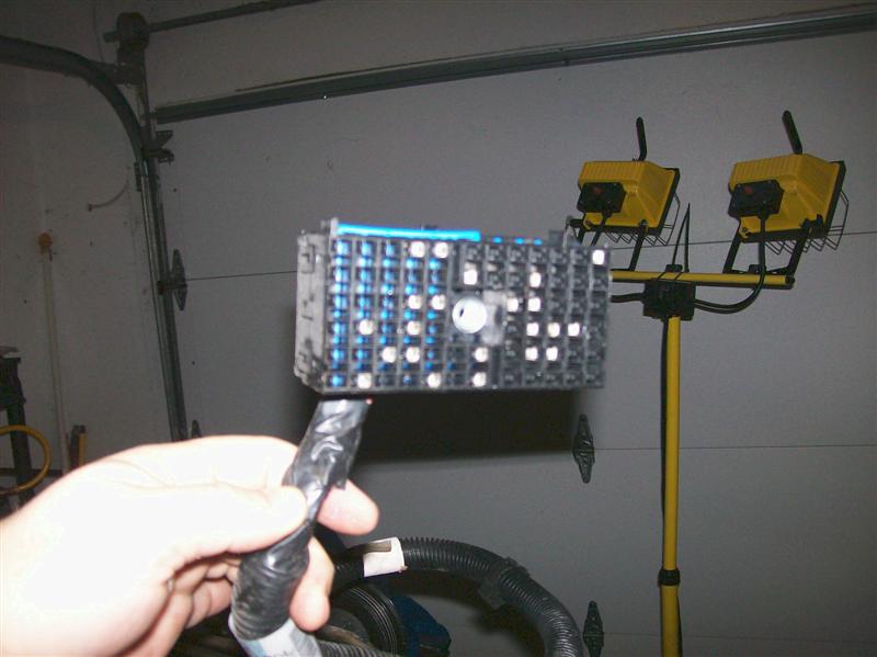

The thing you refer to as "#5 is part of the original GTP fuse box or whatever the motor came out of. The fuse box has stuff like a fuel pump fuse and other things.
The big plate is to help hold the beauty cover thing in place, just remove it to get it out of your way. Your harness still has the MAP sensor plug so you can always just go get an engine harness that has not been cut up from a 3800 N/A engine to work with if needed. Four of the extra wires by the oil filter are for the second O2 sensor which you do not need and there should be a blue wire there for the knock sensor. If you are not using the EGR then just cap off where the hoses come from the exhaust manifold and the intake, if wanting to use the EGR the one from the N/A engine is the same. Dan

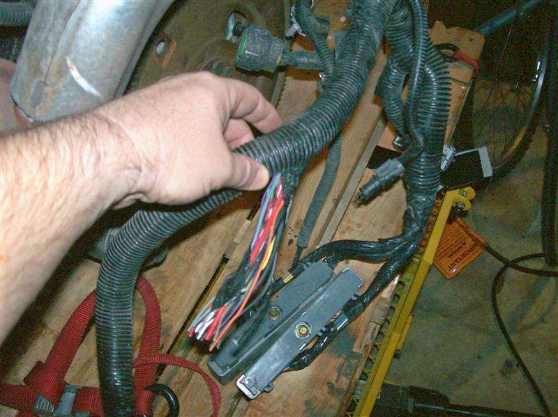

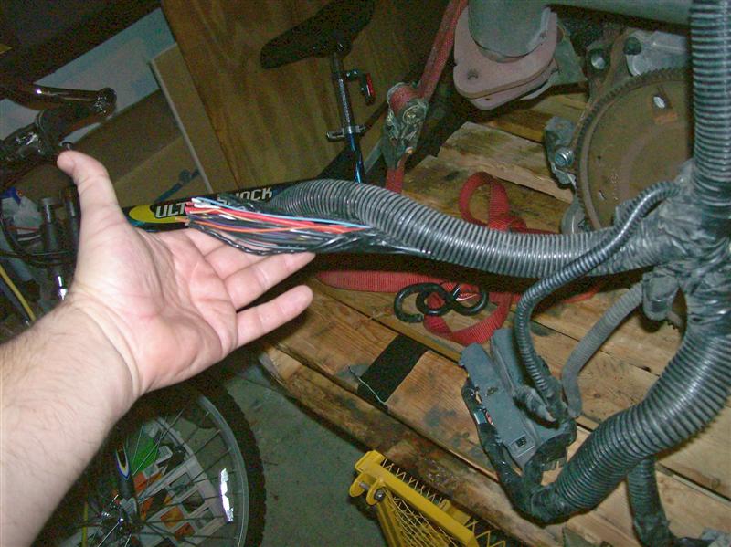

Looks like you have more than enough of your harness left, and the 2001 PCM is fine for anything, the 99-02 pcms are all the same basically. You are going to end up cutting back almost all of the harness parts you have pictured, all you really want to keep together is any of the PCM to engine connections, as you dont need to disturb those. One bonus to keeping them together is the fact that you can be assured that you didnt mix up any of the wires when you put the swap harness together.
