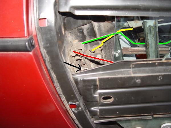

You should be able to reach the lock and latch mechanism with the inner door panel removed.
This shows the mechanism with the outer door panel removed. You'll be able to easily see the rod that connects to the inner lock lever and you should be able to see the shorter rod that connects to the outer lock cylinder assembly.

Here's a little more explanation.
The rod marked in green goes to the inside lock lever
The rod marked in red goes to the outside door lock
The rod marked in yellow goes to the inside door handle
The black arrow is pointing to the door latch release lever. The outside door handle lever rod connects to this and has a small spring on it.
You should be able to unlatch the door by pushing down on this lever. Be careful not to disengage the outer door handle rod and spring though.

Might be more work than you really want to do, but you're going to need room to pull the inner door panel away from the door structure and get it out from between the dash corner. The passenger seat is definately in your way. In order to make enough room you may want to remove the passenger side seat and carefully take it out of the car thru the drivers side. I think you can reach the rear 13mm nuts on the seat tracks with the seat all the way forward and the seat back tilted forward. Once the seat is out you should be able to at least release the inner door panel and flex the rear edge of the door panel inward enough to reach inside and try to move the lock rod bellcrank mechanism. You'll have to do this by feel, but the bellcrank only has 2 positions, (locked and unlocked).
The blue colored lever in the photo is the lock bellcrank. It simply pivots forward and aft to lock or unlock the latch mechanism. That's the item you want to try to reach by feel and move to the unlocked position. Best bet is to try moving the inner lock rod first becuase its easier to see and reach.
