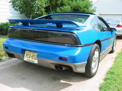

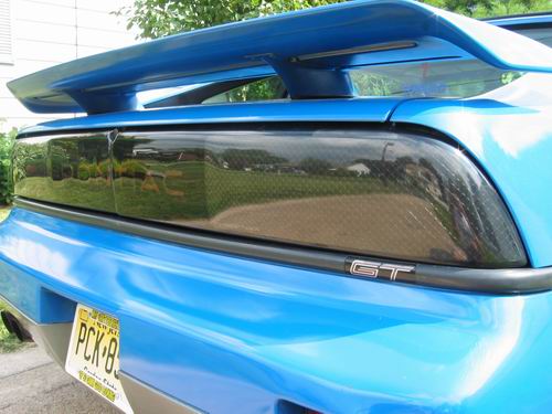

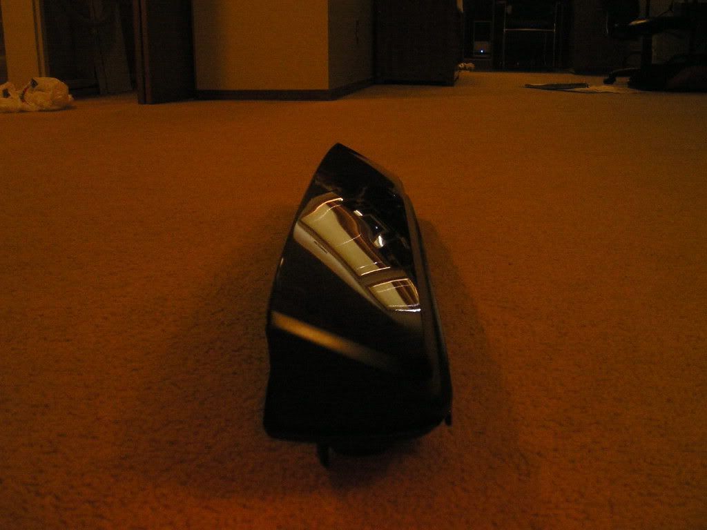

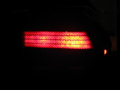

Same thing here, VHT nite shades tint spray. 2 or 3 coats on the inside, I don't remember it was a couple years ago now:
Sorry, car was pretty dirty in these pics:
This images is larger than 100K. Click to view.

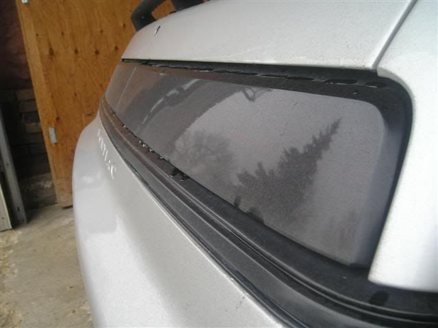

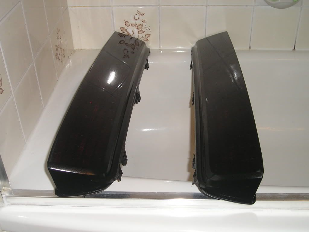

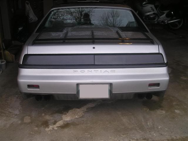

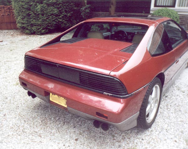

old pic
think it was about 3 coats of motip/duplicolor lens paint

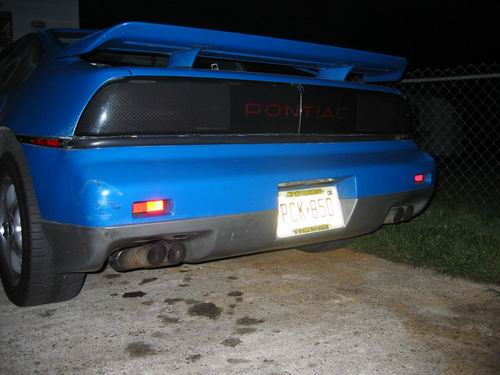

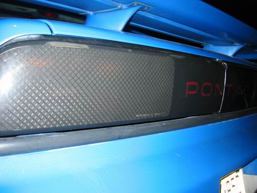

Cut out from my thread:
And the paint is dry and the taillights are on the car. PONTIAC is back!!!
Also new tail pipes for the exhaust.
Tinted in 4 layers
One more
Regards SHARKMAN

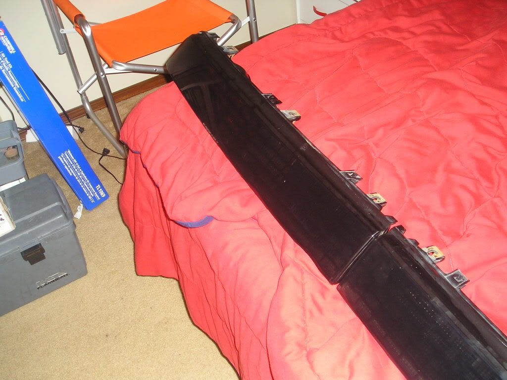

2 layers of fade resistant black panyhose wrapped around the inner color lense, then black plastic gutter guard between that and the clear outter lense.
