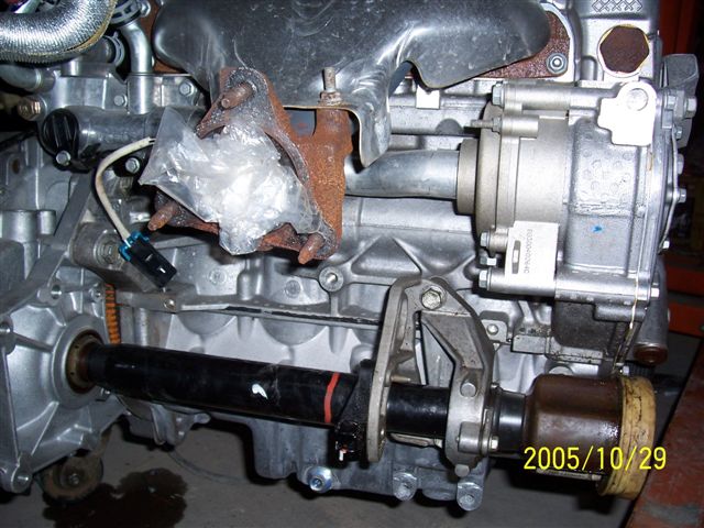

This is the engine and transmission explored a little over the weekend..
http://www.fastfieros.com/tech/ecotec_20sc.htm
What do I know at this time? This package will fit in the Fiero with no problems. Mounts are almost designed already. Transmission is located in stock location of current mounting methods of 3800sc, and other swaps. Clutch release is already solved. Axles, now this is the big one. I have no clue on this one yet. My axles just came in today, and I need to get the LSJ and F35 on the cradle to determine this.

Axles are the hardest part of this to stay in a good pricing structure. I can get custom axles made at many different places. Most are $400-750 however.

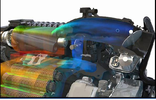

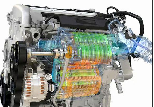

Check out this CAD animation of the EcoTec in action... Warning large graphic file >
http://www.FastFieros.com/tech/Ecotec_CAD.mpeg
This animation of the water flow.. Not to large of a file here.
http://www.FastFieros.com/tec/ecotecflow.wmv

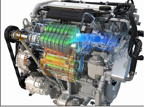

That last picture makes the engine look like such a tidy package. It does make me wonder were the water pump is?

looks like its intercooled...?! cool

What the hell kind of accessory belt is that??? Ribbed on both sides for her plesure?

It's chain driven, and it's just up and to the left of the crank pully. (Almost directly across from the alternator). You can see it better by looking at the other side of the engine.

I'd say it's ribbed on both sides because the outside goes around the alternator.

The belt is double ribbed. Not a great thing at this time because there are limited sizes. Pulley changes require a special tensioner that replaces the OE one. I have one already. ZZP will be marketing it as well as I will.
The Alt is a sprag clutch pulley just like the 04 ALT on the 3800sc.
The water pump is huge and mounts on the backside of the front cover. Pic>
It is intercooled. It has Laminova cores. I have read some about these. ZZP has done some testing already with these cores and indicates that these cores do not out perform the heater cores they are using in the Stage 2 units. I think some IC upgrades are going to be needed sounds like.

Axles... Oh my, was this just to easy... More later on this one... There's good and there's fair.. So far, no "bad" however...
