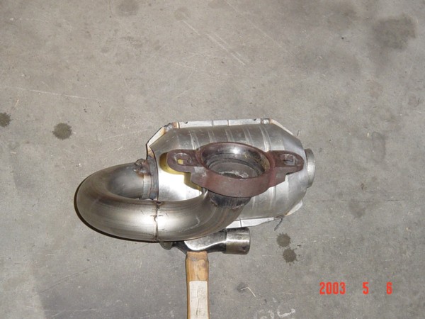

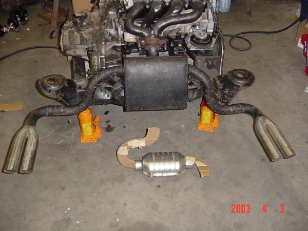

On my Quad 4 I was able to squeeze in a short Cat between the engine and a standard muffler. I ran 2" 304SS. It's tight and 2-1/2" might not fit. The last weld had to be made in place as the cat inlet tubing and muffler will not fit over the cradle to remove as a unit.

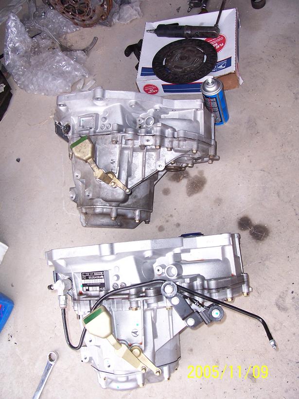

I already have the axles worked out..
I purchased 2 brand new GETRAG 5 speeds ( F35 ) .. Just need more time to work on this, but I have some wiring harness that have to come first when I finish Will's car.

Its not painted... It is brand new and never installed. I have 2 that are brand new now. The used one above in the picture is already sold and gone.

So, how much do those trannys sell for? If they're a lot stronger than the 282, that might be a good option. Besides, if you're doing a V8 you have to have an adapter plate made anyway.
(Although that does raise the question if all you'd need to do is change the adapter plate to match the new tranny vs. the 282.)

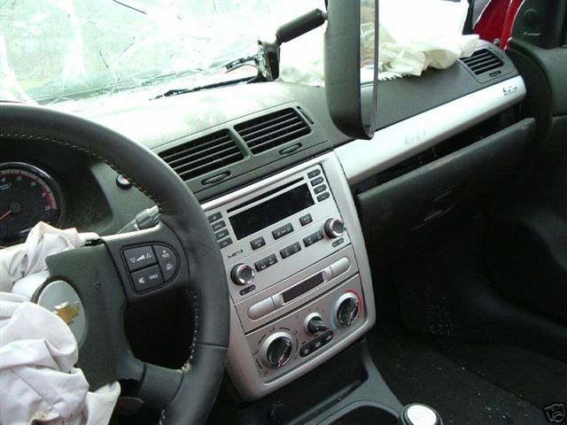

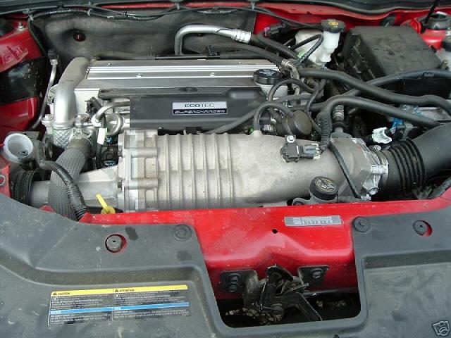

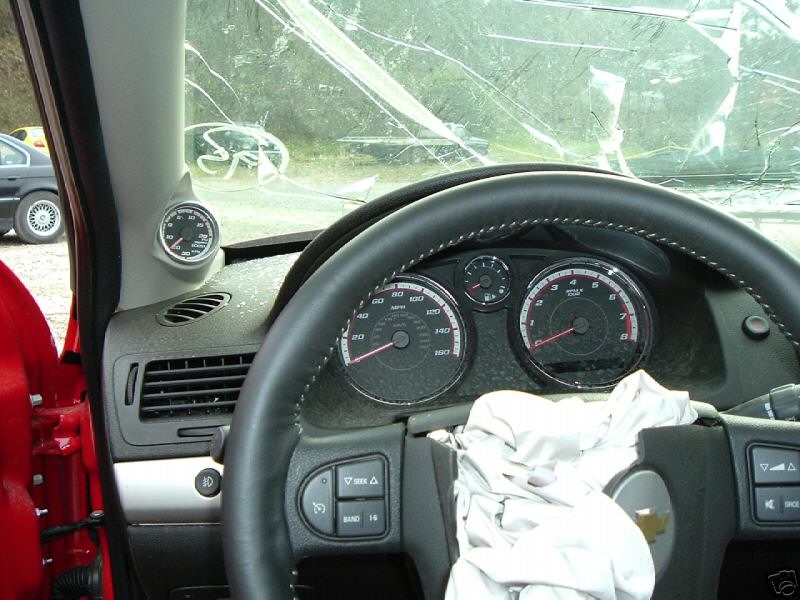

Well, since you bumped this.. I will update what a 2005 Chevrolet Cobalt SS with 1652 miles looks like very wrecked.
As soon as I finish this 3800SC install to the Ferrari 355 I am working on today, I will try to do a little work on this 2.0L SC install.
The whole interior wiring, and engine harness are going into the Fiero. I love the dash in this Cobalt. 160 MPH speedo..
Now that I see how the electric steering is installed to the cobalt with the manual petals, I think I can get it all in the Fiero as well. I cranked up this Cobalt and steered left and right. It feels real nice with the electric power assist. With the engine off, and the steering unlocked, it steers left and right about like a Fiero sitting still.
Loyde
