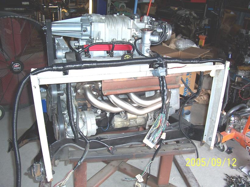

Another 3800SC hits the road with Stage 2 intercooler.
This install was done in 10 days from pull the 2.8 to running 3.8SC with IC. The wiring harness was built, the intake cut, the low mount made, the T-stat housing modded, the exhaust complete built, and all the other small items in this entire 10 days time. I dont do build threads as I go along, but here are the results of my work.

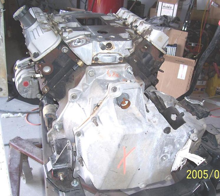

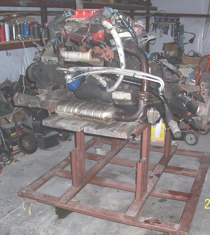

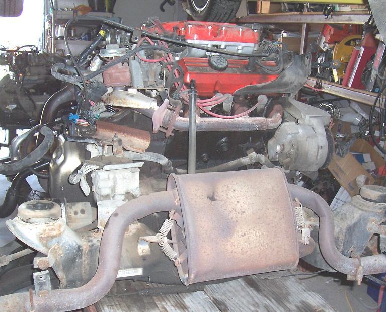

Pull 2.8
3800SC mounted and SC removed.

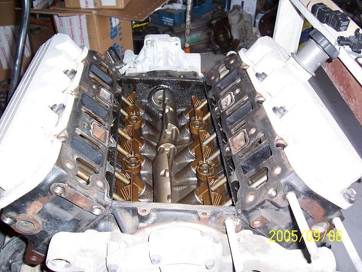

Inside a 27k engine. Nice and clean.

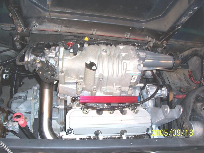

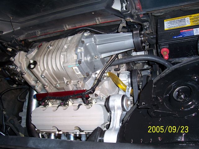

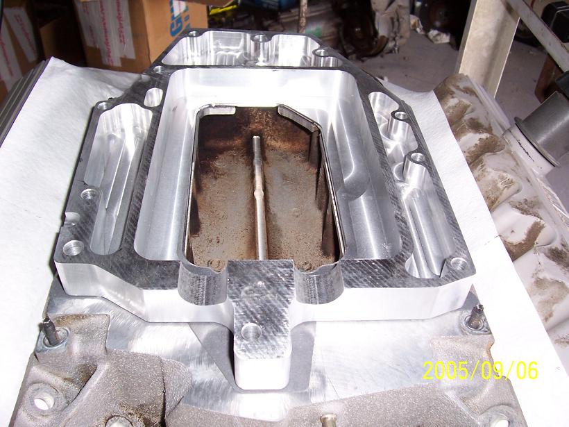

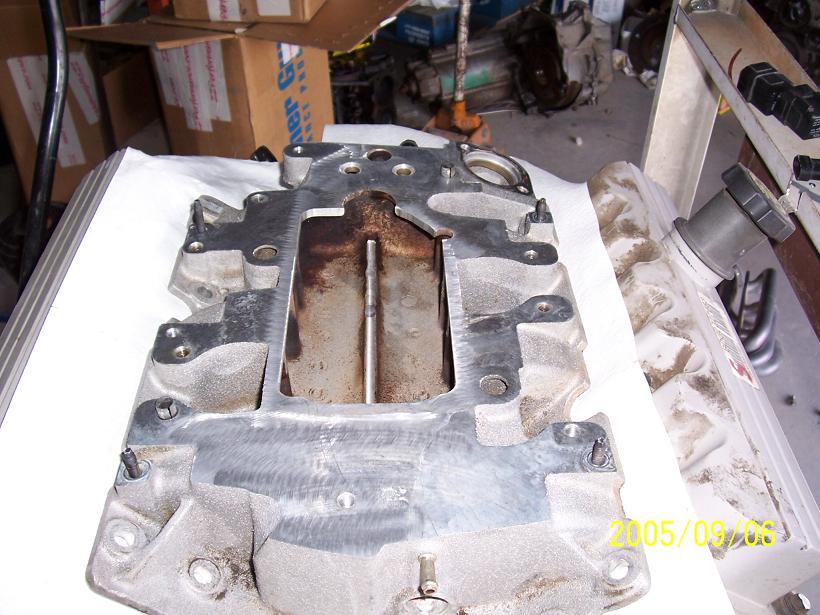

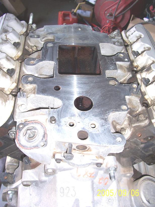

Before intake is cut
Intake now cut for the IC stage 2. I used my CNC mill to cut this.

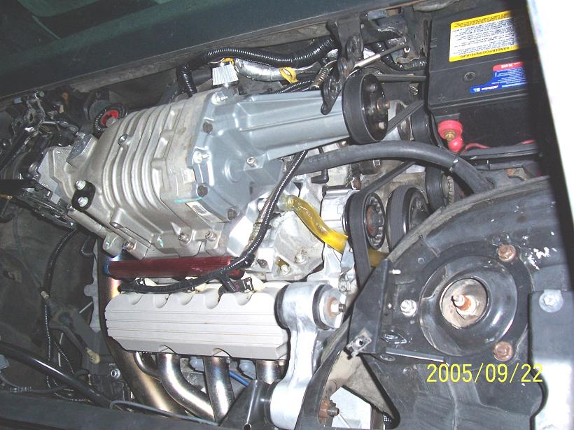

Lower half of Intercooler section added... This is considered a GEN 2 IC with the lighting pockets, but these also add in silicon sealing. Product is from ZZPerformance. I am a certified installer for ZZPerformance now today as well.

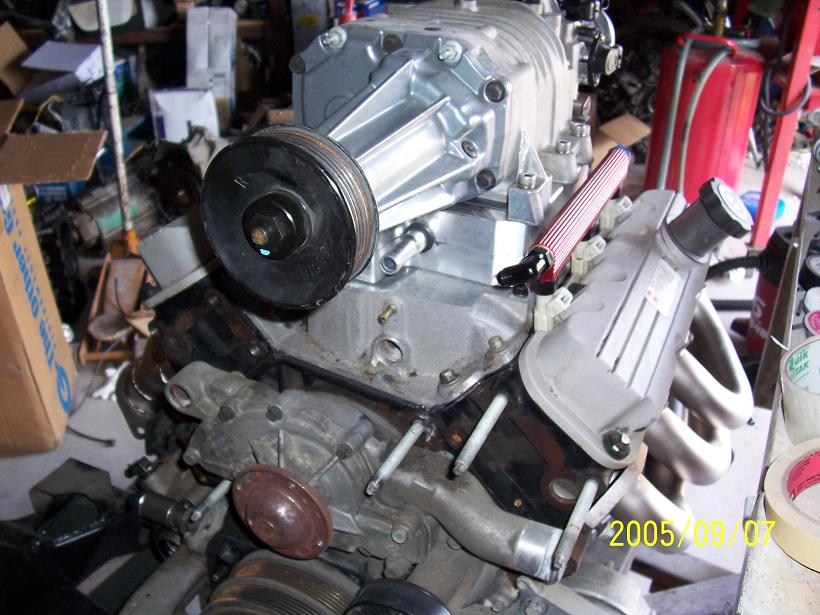

IC is now complete with SC and PRJ fuel rails in place

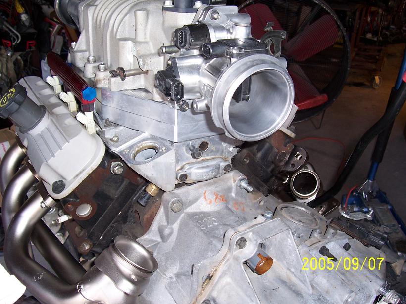

Stage 2 Throttle body bored to 72MM, IC from the rear

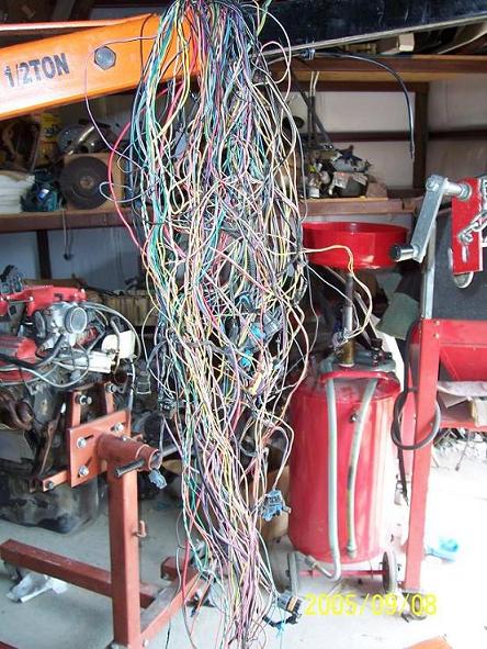

Starting the OBDII wiring. This is the 3800SC engine harness ripped to each wire and connector. I concept build every harness. Each one is specific to the install and the mods.

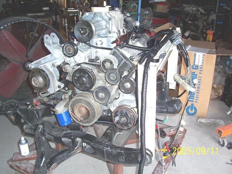

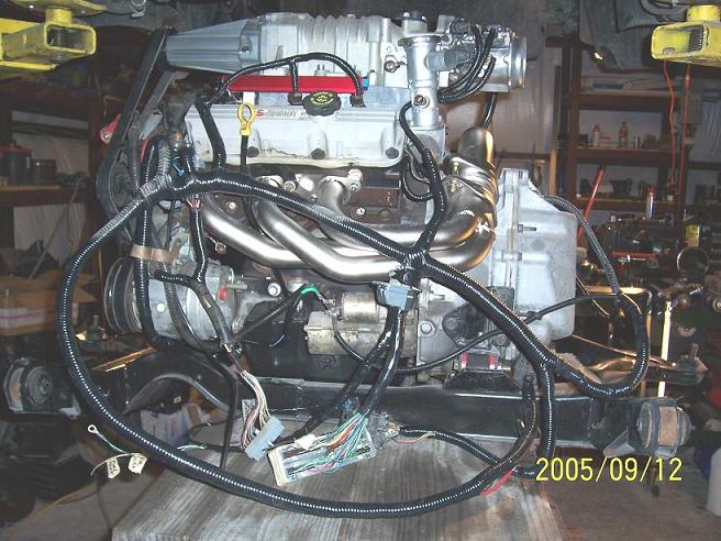

Wiring harness is complete
Low mount complete, belts on
Wired, Tstat modded, ready to install...

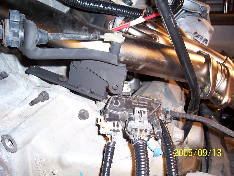

Transmission shifter modification.. Uses Fiero V6 components.
Installed and ready to start the engine...

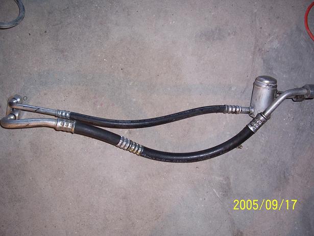

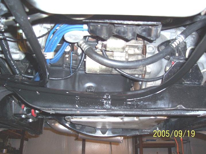

AC hose build.. I do this all in house now since I purchased my own cripper and fittings.
Underside wiring and fuel lines. This is a RETURNLESS system I used. Keeps the fuel hoses clean up top.. Spark plug wires are all routed under the engine. These are MSD 8mm.
I took 100 pictures of this install. This only 18 of them. I will provide additional if I have it in that section. The orginal pics are high resolution and I will add this install to my projects page in a few days.
Loyde
http://www.fastfieros.com
Hey, just curious about this. What do you charge to make the hose fittings??? As of right now the AC compressor is just going to be an idler until we can find someone locally to make the hoses. Since you have done all the othe work (low alt, axle, wiring, PCM,etc) would be convientient if you'd be able to do the lines as well...
FastFieros
Posts: 2698
From: Dallas Texas USA
Total ratings: 265
Report this Post09-21-2005 01:13 PM Click Here to See the Profile for FastFierosClick Here to visit FastFieros's HomePageSend a Private Message to FastFierosDirect Link to This Post
Just send me the Fiero AC hose set, and the 3800sc hose set, and I will do it for free with all the other stuff I have already done/attempting to do.. Your patience is appreicated here.

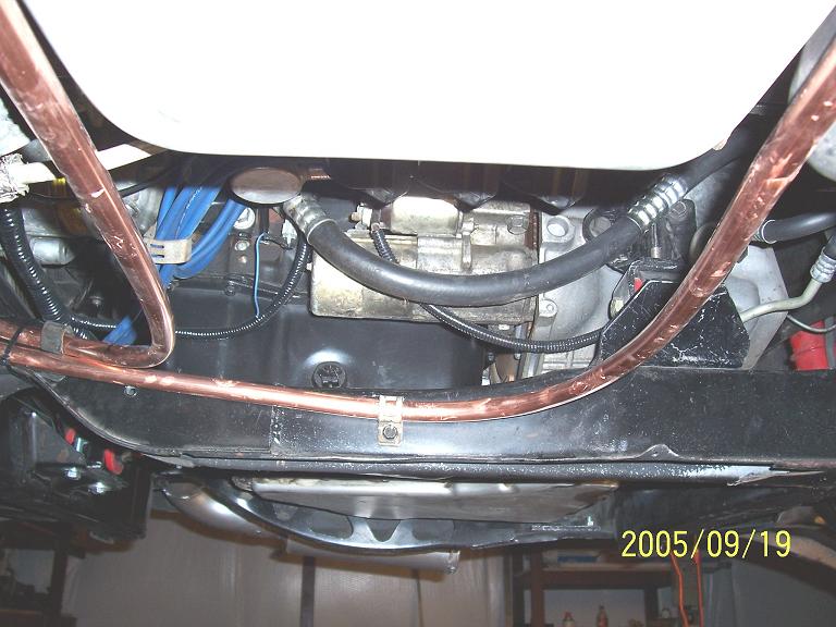

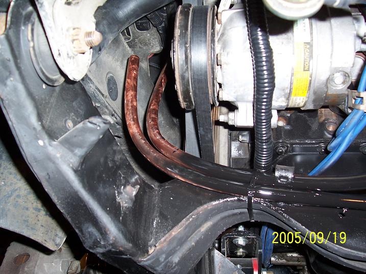

Here are the intercooler lines someone asked about in emails..
Now you see the lines....
Now you dont see them so well with a little black paint.
The next set of lines will be sweated fittings and copper even higher up so very little rubber hose is used.
Loyde

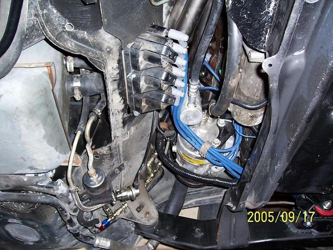

Originally posted by FieroMGDriver:
Also, what are the ramifications of mounting the ignition coils in that location unprotected?
Unprotected? Do you call them protected in the engine compartment with all the heat, and water when it rains? Have you ever drove your GTP in the rain and got out to see what is wet, and what is dry? The engine and all stuff gets wet.
Anyway, this is the 5th setup like this to get the coil packs mounted here. The rain actually misses this area of the car while driving down the road. The coil packs in this location have been tested in down pours with major street flooding, and ZERO problems from mis-fires, or stalling.
Its where I like it to keep the up top area once again ... CLEAN installed.
Loyde

Here's my TOP shot for tonight.. I found some things in my other pics that I must resolve to feel good about the other angles.
hummm MAYBE you can reduce the weight of the wire a bit I didn't need to use a hoist on mine
Yours didnt run either the first time you started it I believe you had to go back and add some wires ..

Report this Post09-22-2005 07:42 PM Click Here to See the Profile for FieroGTguyClick Here to visit FieroGTguy's HomePageSend a Private Message to FieroGTguyDirect Link to This Post
Heya Loyde,
I need A/C lines to run around my WCF headers, but all I have is my old Fiero metal lines. Would you still be able to help me out if I pay any added expense from getting whatever else you need?
Your Friend,
Greg

Well, I top'ed off the car with the decklid, and ice cold AC today. Little paint in the engine area, and clean up some wires.
Rear shot of the muffler just barely hanging down.
