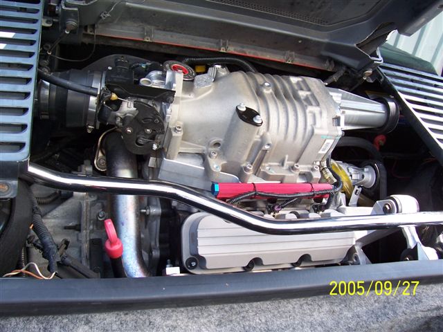

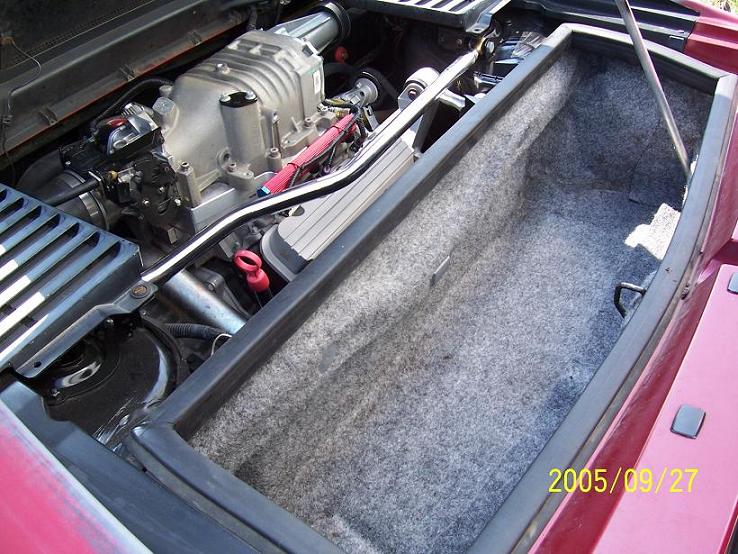

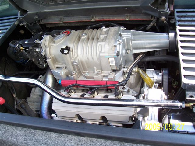

Here is the trunk with finished carpet installed, and his strut bar.

vallen11
Posts: 149
From: Cincinnati Ohio
Report this Post09-27-2005 02:27 PM Click Here to See the Profile for vallen11Send a Private Message to vallen11Direct Link to This Post
I see where you had to notch out the lid for the supercharger pulley end. Were there any other mods to the engine compartment or decklid that had to be done for the intercooler to fit? Thanks.
The decklid hinge had to be trimed at the bottom, and the torsion rods removed. So, you can add the Rodney Dickman strut rod kit to hold the decklid up.

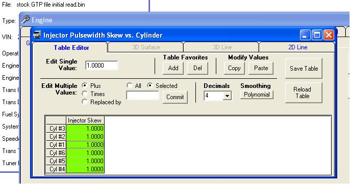

I use to work with Kinsler Fuel Injection on development back in the early 90's. We used mechanical fuel injection were the fuel flow was controlled with what we called pills. Then it was time to move to EFI. Kinsler and I had many discussions on fuel flow and were low pressure area's, and foaming, things that effect how the fuel was finally going to get to the injectors and be consistent at EACH injector.
So, fuel in the racing world is completely different from just the average daily driver. GM is moving most of their product line to returnless for weight reduction, and cleanness at the engine bay I am sure is on the minds of even GM engineers.
I know there are debates on fuel not getting the same pressure at the END injectors as the first set of injectors. I have heard all that in many discussion at race tracks.
GM answer to that is Cylinder Skewing. There's a table in the PCM that allows adjustment of fuel flow of each injector. Isn't nice to have sequential fuel injection in todays modern EFI and engine packages.
This is the skew table with all injectors getting the same fuel flow...

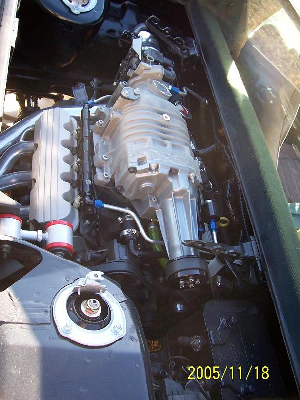

When you delete this vacuum port, where are you connecting your brake booster?
If you don't use an evap system, do you simply block the vent tube from the gas tank?
Originally posted by Ken_86gt:
The EGR on this engine doesn't use vacuum, so no lines there. The only vacuum line you are left with is for the power brakes, if you delete the evap system. There is a line for the map sensor that is tapped from under the front of the blower on the manifold that could be considered vacuum or pressure (unless that was removed as well). The cruise can be adapted to the newer style that does not use vacuum. Remove the purge soloid. What do you need vacuum lines for anyway?
FastFieros
Posts: 2698
From: Dallas Texas USA
Total ratings: 265
Report this Post06-26-2006 07:57 PM Click Here to See the Profile for FastFierosClick Here to visit FastFieros's HomePageSend a Private Message to FastFierosDirect Link to This Post
here is a project with lots of pics.. http://www.fastfieros.com/projects/will_m3800/will_m.htm
The throttle body has a port on the side of it I use. Sometimes I just rubber line to it, sometimes I turn a 3/8 -6an down and drive it in.then i hardline to the rubber line.
Its the blue fitting in the side of the throttle body.
then in this next shot you can see the hardline going forward to the rubber hose.
Do not block off the old Fiero EVAP line. It is an emission control device and you should either follow your local state laws, or use the car in a manner of OFF ROAD use only. I give the options to the customer and let them decide on what they want.
Loyde
