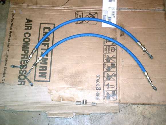

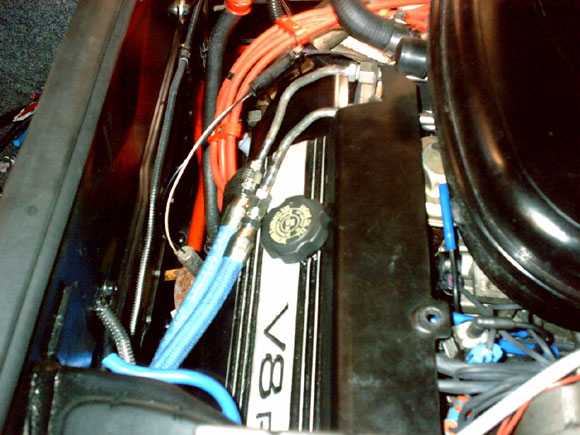

Well now that I am back, I have been knocking off my final To Do list.
Got the fuel lines made. These are Nomex covered braided steel Aeroquip lines:
installed:

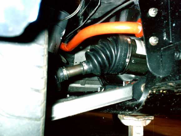

Got the Left axle in p/n 8471:

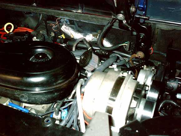

And finished up with some odds and ends on the top ot the motor:
Next battery cables, battery, fluids and exhaust. Oh yeah, bad news! My SLP muffler will NOT fit. *Sigh* Guess I have to go with the Flowmaster. Damn!

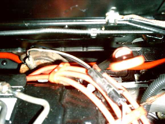

Report this Post07-18-2003 12:01 AM Click Here to See the Profile for BV MotorSportsSend a Private Message to BV MotorSportsDirect Link to This Post
Looks like I will be adding this http://store.summitracing.com/partdetail.asp?part=PRM%2D3311
This should help reduce some clutter.
Steven

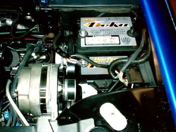

Well got the battery, cables and misc wiring done today. Hooked up the batt and saw my indiglo gauges light up for the first time! Woohoo. Exhaust, dual circut heat exchanger and fliuds and I am done!
Battery:
Lucked out and found a 26 series with 770cca and 900ca. Stock 75 series was too close to the pulleys.
Indiglo:

Very nice Steve. Very professional looking.
Dragon1/Brian

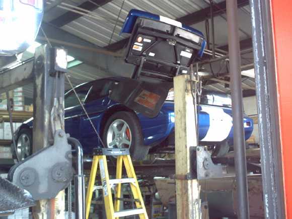

Report this Post07-21-2003 02:30 PM Click Here to See the Profile for BV MotorSportsSend a Private Message to BV MotorSportsDirect Link to This Post
Well, dropped off the fiero to the exhaust shop today. Got some neat tricks I'll have to show you when I get her back. BTW I'll get some pics while its on the rack.
Rockcrawl, if you are reading this, I REALLY REALLY need that MEMCAL. I'll try to call you again later.

Report this Post07-21-2003 03:39 PM Click Here to See the Profile for BV MotorSportsSend a Private Message to BV MotorSportsDirect Link to This Post
BV MotorSports
4821 posts
Member since May 2001

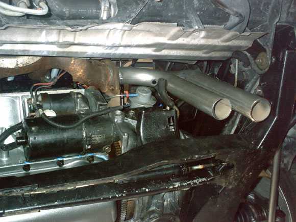

Pics from Muffler King:
Y-pipe being made
BV MotorSports

y-pipe
Flowmaster 42853
And this thingy.....

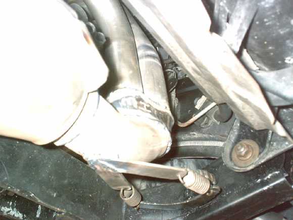

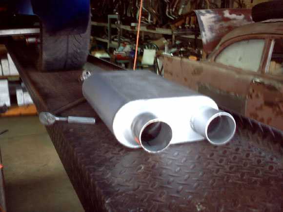

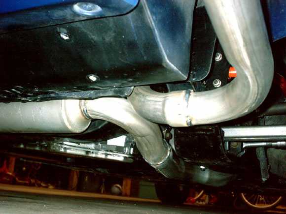

newest pics from the exhaust shop
3.5 inch hard pipe
y-pipe collector
exhaust routing
Thats how a flomaster muffler should set in a fiero!
Steven

Were they able to get that exhaust system installed without "massaging" any sheet metal?
BV MotorSports
Posts: 4821
From: Oak Hill, WV
Total ratings: 189
Report this Post07-23-2003 12:38 PM Click Here to See the Profile for BV MotorSportsSend a Private Message to BV MotorSportsDirect Link to This Post
The car or cradle was not altered what so ever to fit the exhaust. These guys are really good at what they do.

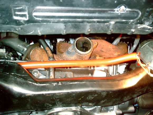

Report this Post07-23-2003 03:02 PM Click Here to See the Profile for swanthogSend a Private Message to swanthogDirect Link to This Post

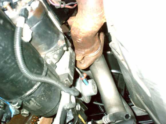

About the exhaust, did you just block off the original exhaust opening on the trunk side manifold? Any pics of that area from underneath after completion? I imagine not since that big 'ol muffler would be in the way of the shot.

The shared collector was capped and a y-pipe replaced the stock 4.9 U-pipe. I just got the car home and will lift it and take some more pics. What till you see some of my "tricks".
Steven

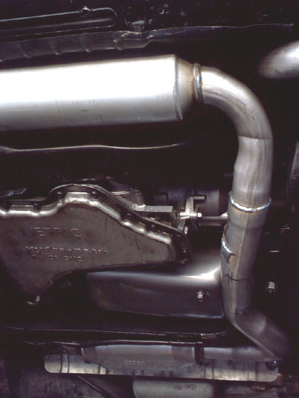

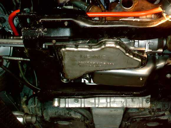

BV MotorSports
Posts: 4821
From: Oak Hill, WV
Total ratings: 189
Report this Post07-23-2003 06:58 PM Click Here to See the Profile for BV MotorSportsSend a Private Message to BV MotorSportsDirect Link to This Post
BV MotorSports
4821 posts

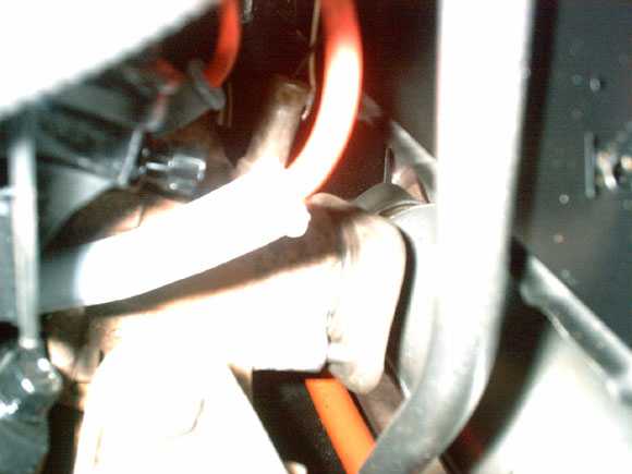

Here is the best pics I could get of the exhaust and shared collector:

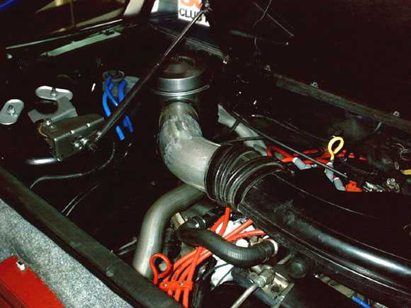

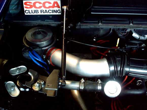

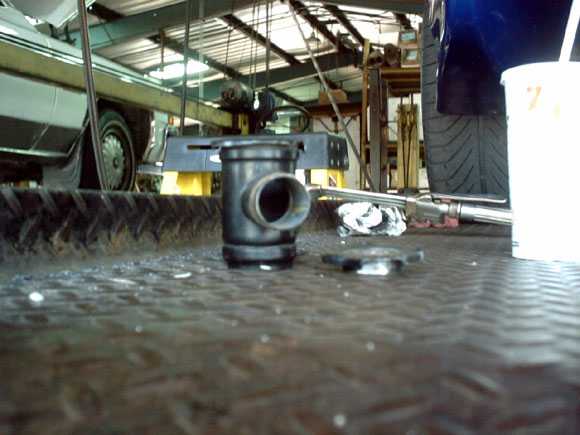

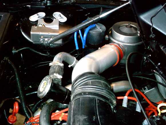

Here is the 3.5 inch intake tube w/ modified Fiero t-stat housing:
Now its just a oil/tranny cooler, alignment, 88 sway bar end links, and MEMCAL away from being driven!

Well, my car is up and running. It was very very uneventfull first start. FOund I had knocked one of the MSD 6AL wires loose and she fired right up. No leaks, no surprises. This made me very happy. In order to test fire it I looped the oil cooler and tranny cooler lines. I should have my dual circut oil cooler here NLT Friday.
I have to tell y'all, I was dancing in the garage and patting myself on the back tonight! This was a very long swap since I changed so many things on my car.
I still have to get it aligned, top off the fliuds, bleed the brakes, install the oil/tranny cooler, have the exhaust tips installed and wash it. Oh and the all important test drive! Yeah, I cant wait for that!
But its official, I now have a running 4.9 Fiero! YES!
