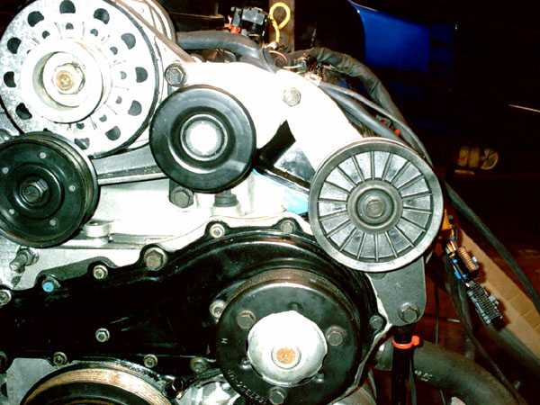

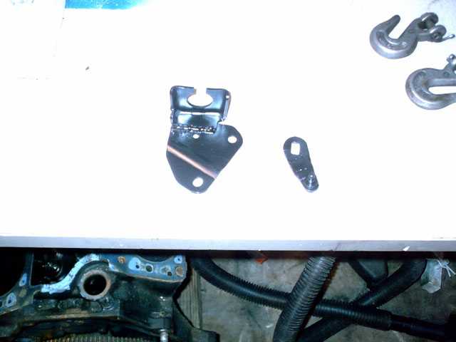

Here is some of the pics for the idler/tensioner prototype I am working on:

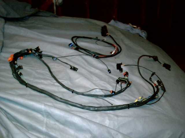

Report this Post06-17-2003 04:25 AM Click Here to See the Profile for BV MotorSportsSend a Private Message to BV MotorSportsDirect Link to This Post
Well my wiring harness has been ordered. I have everything ready to install into the car once the harness gets here. Have to send Rockcrawl my ECM to get reprogrammed.
I'll put up some more pics later today. I am getting excited!

its monday..err tuesday, whatever, and you still dont have the engine installed!! what are you, some kind of a slacker!! Looks great so far! Now get going!

I think it might me projectfinishedphobia.....
I spoke with Jim and my harness should be here Monday or Tuesday. Reason I havent installed the cradle is because of the harness. Its much easier to route the wiring and secure it with the drivetrain out of the car. Looks much cleaner that way. Besides, I have to find a way to use all those nice adel clamps and heat resistant wire wrap I have! Here comes some pics....

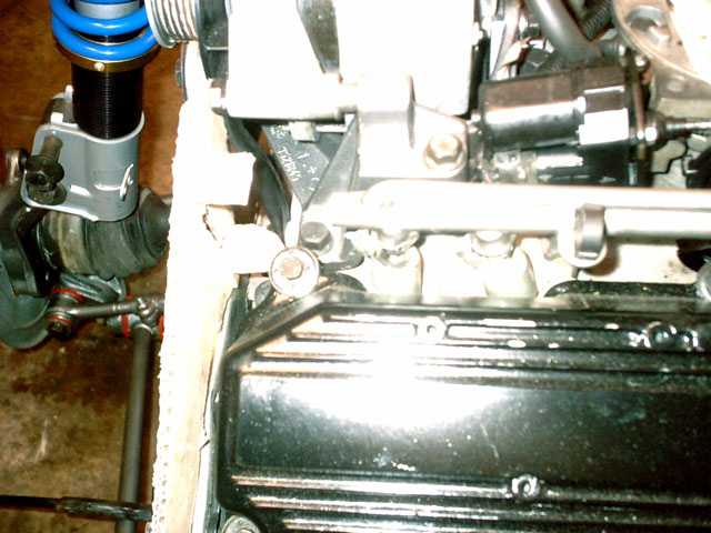

Report this Post06-21-2003 09:20 PM Click Here to See the Profile for twodogjohnnyClick Here to visit twodogjohnny's HomePageSend a Private Message to twodogjohnnyDirect Link to This Post

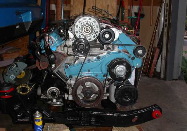

I originally mounted a tensioner on the left.
It wouldnt fit in the car.
So I chatted with Ed Parks and Steve, and ended up with this.
I need to find some time to test fit, but I'm fairly sure it will clear everything.
-john
-john
John looks good! I wonder if that idler is going to clear the hinge mount and firewall? Its gonna be close. I "think" you need to move it toward the trunk about 1 inch. Let me know.

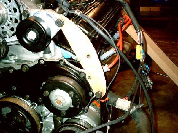

twodogjohnny
Posts: 163
From: reston, va, usa
Registered: Oct 2002
Report this Post06-23-2003 08:53 AM Click Here to See the Profile for twodogjohnnyClick Here to visit twodogjohnny's HomePageSend a Private Message to twodogjohnnyDirect Link to This Post

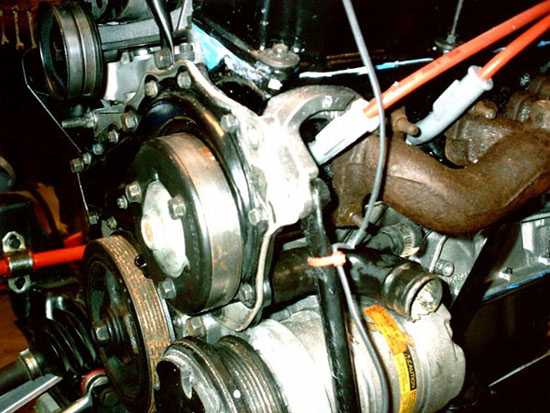

I test fit, and the location looks good. Plenty of room to the firewall, but I may have to move some wires/hoses to be safe.
I am really close to the battery tray. So much, that I had to take the pully and tensioner off to get the engine in the car. Once it's in, I have 1/4 inch between the belt and the tray.
It's not a huge problem for me to move the engine towards the driver side 1/2 inch - so I'll do that next. reattach the pully/tensioner, and snap some pics.
-john

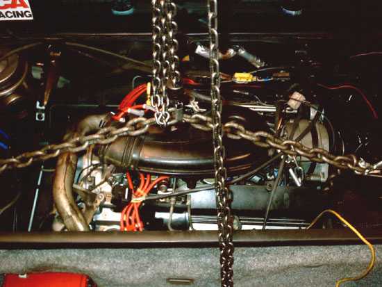

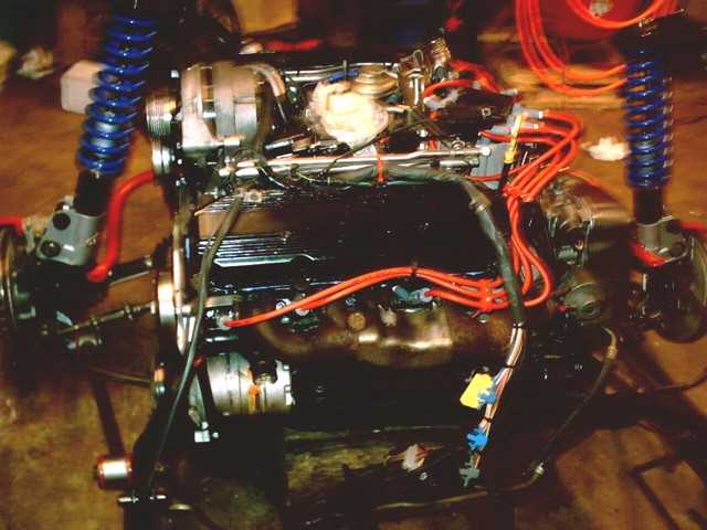

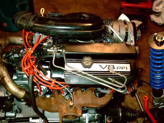

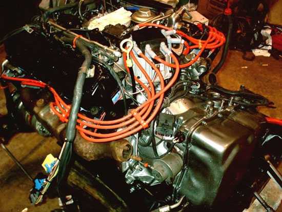

Well after a 1 week break I got back on my swap. After returning from my trip I had a box waiting for me. What was it? One of the last things I needed, my harness! Thanks Jim!
Here are the newest pics, I should have the cradle installed and the car ready to go to the exhaust shop by tuesday.

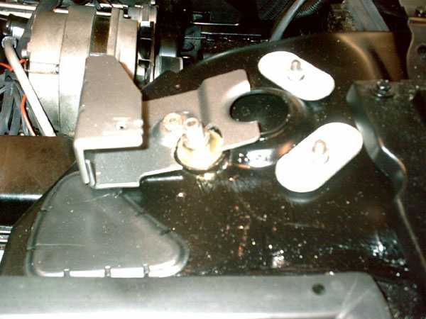

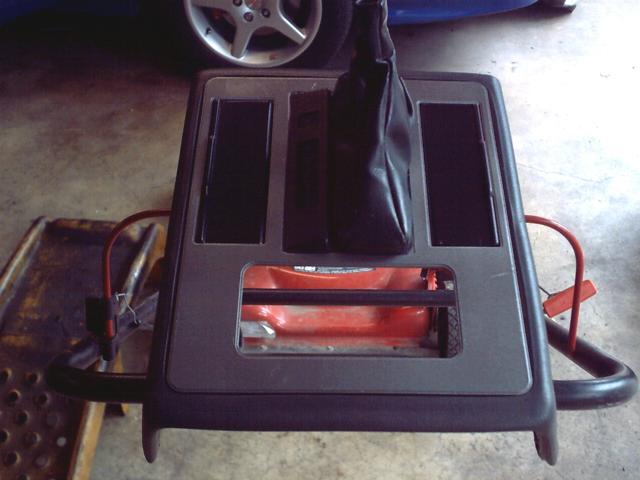

Got alot done today. Bolted the tq converter to flywheel, mounted starter, finished routing engine wiring, trimmed timing chain cover, made the shifter brackets and finished building the car hoist.
Check out the pics:
It works!
shifter brackets

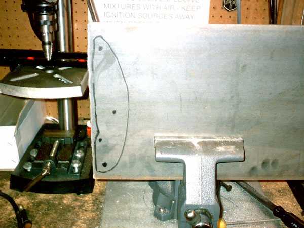

Report this Post06-30-2003 10:12 PM Click Here to See the Profile for BV MotorSportsSend a Private Message to BV MotorSportsDirect Link to This Post

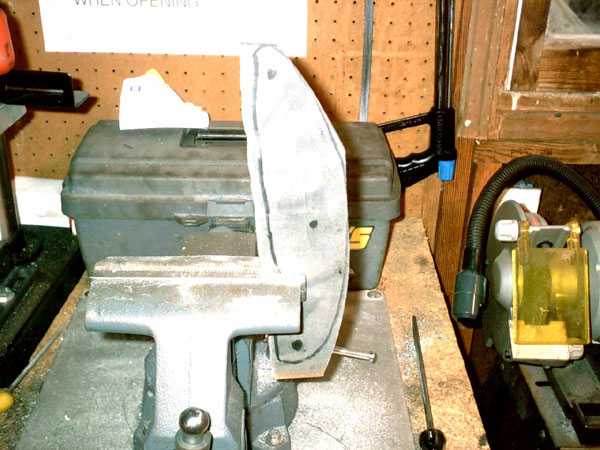

BV MotorSports
4821 posts
Member since May 2001

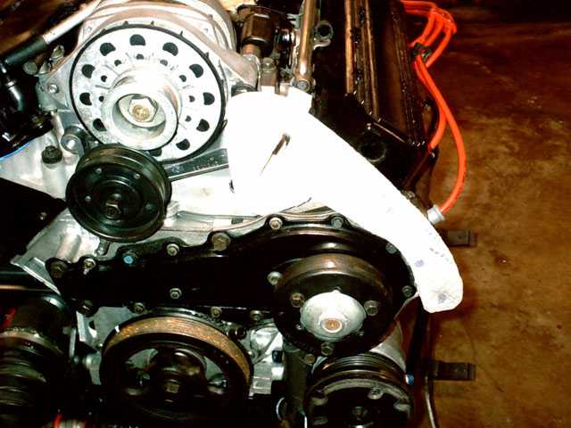

More progress today.
Cardboard template:
Working on tensioner bracket:
Finished
side view
Putting the drivetrain in tomorrow! More pics later... sorry dial up guys.

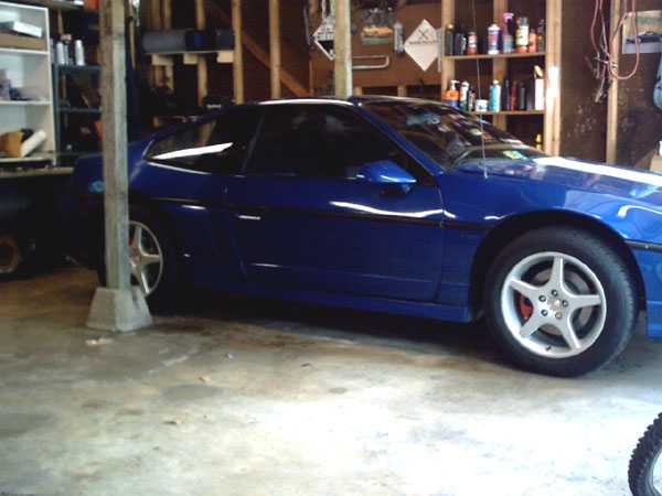

in case anyone is wondering.. this is what my car looks like all put together:
fieromadman
Posts: 2217
From: Oconomowoc WI, USA
Registered: Jan 2003
Total ratings: 63
Report this Post07-01-2003 12:43 AM Click Here to See the Profile for fieromadmanClick Here to visit fieromadman's HomePageSend a Private Message to fieromadmanDirect Link to This Post
well nice looking car you go there, i was wondering what it looked like all put together. Oh btw, what the deal with the poly mounts? P.M. me

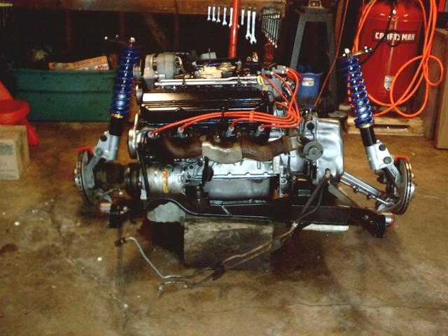

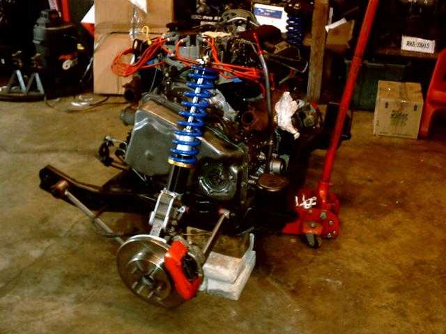

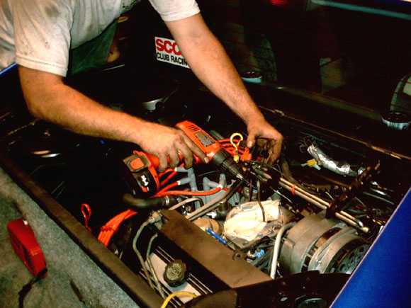

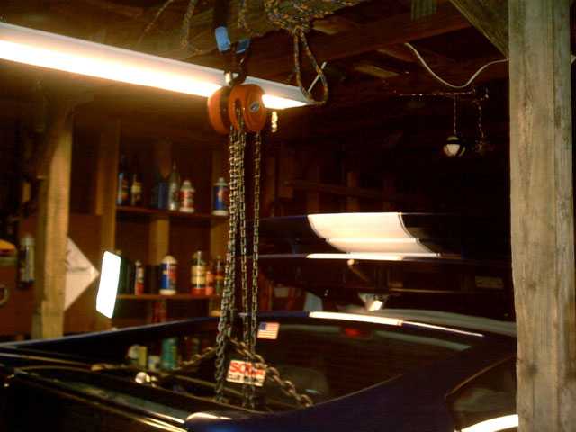

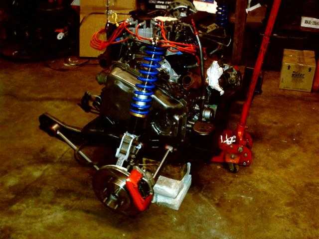

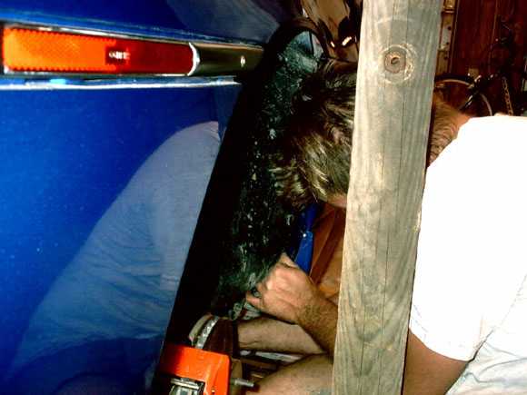

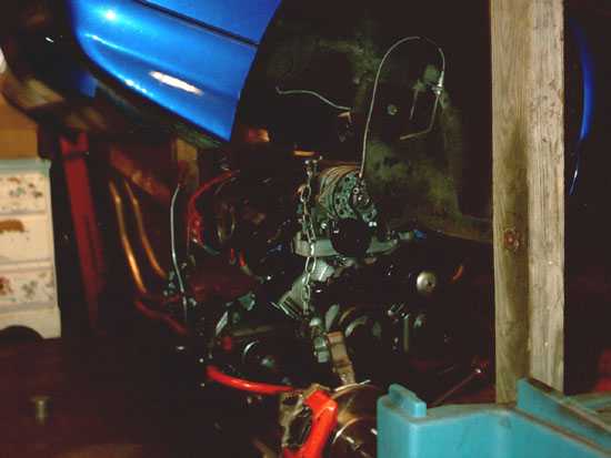

Well the drivetrain is in. Thanks BIG TIME to John for coming over to help wrestle the cradle in and give my GF piece of mind knowing I wasnt out there to get smashed all by myself.
Well, here are the pics. There are 20 from tonight so I'll just post a few... Bandwidth and all...
John
Going in
Almost there
Me trying to do something, I forget...
Trying to get the cradle lined up
BV MotorSports
Posts: 4821
From: Oak Hill, WV
Total ratings: 189
Report this Post07-02-2003 02:55 AM Click Here to See the Profile for BV MotorSportsSend a Private Message to BV MotorSportsDirect Link to This Post
BV MotorSports
4821 posts

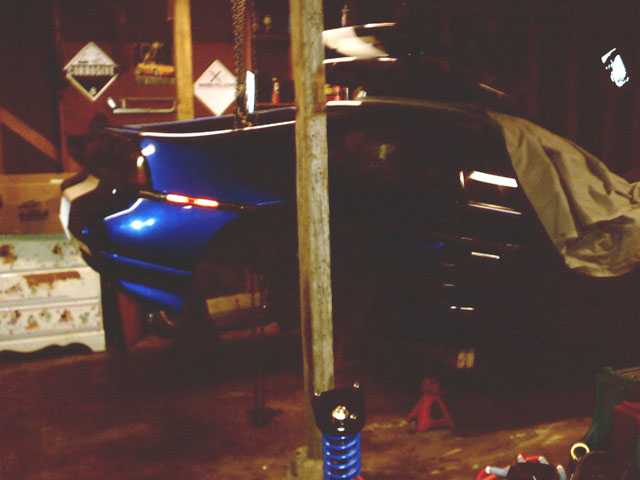

More

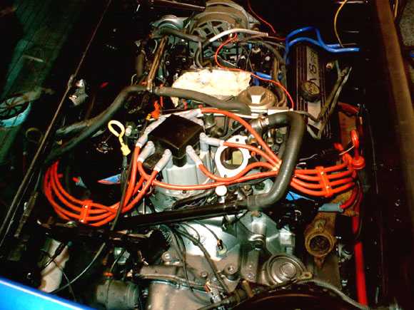

Drilling a hole for the throttle cable to lock
In!!!!!

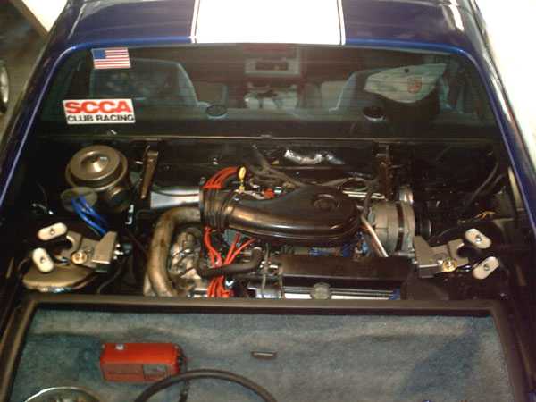

Well I have alot to do tomorrow (err later today). I am worn out. BUT.... I have a 4.9 fiero I have a 4.9 Fiero! Wooohooooo!
Steven

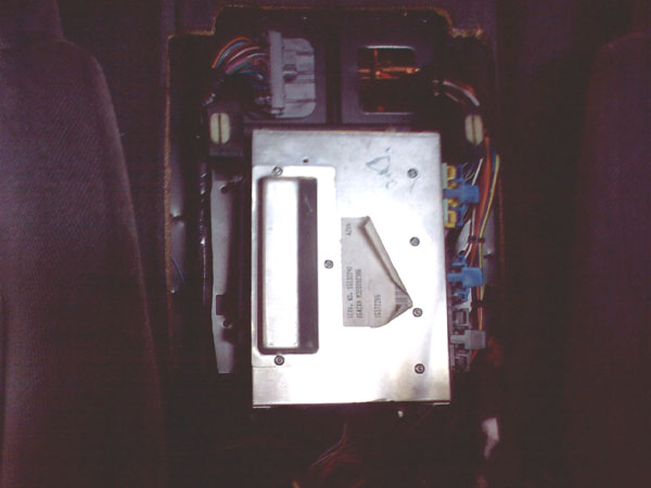

LOL first race will be my 4.9 vrs Jesse's. Since I sent my MEMCAL to Rockcrawl for his 4.9 voodoo and pulled a few tuning "tricks" on my swap.... Jesse is going down like a pwr window on express. Then the WRX is next. Then Garth and his TDC. If there is any car I am going to have to sabatoge its garths 13.3@106 TDC.
Good news is since Rockcrawl has my MEMCAL and is turing off the codes I will be able to hook up the SES circut.

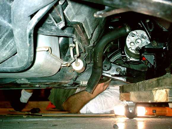

Got alot of work done today. Guess what? My fiero is setting on all 4 wheels for the first time in 2003!
I ended up getting the coil overs installed for the 88 cradle. What a PITA. Best tool for the job... 1 1/2 hole saw works wonders to clear the hat on the adapter perch.
Hooked up my brake lines and e-brake cables. Not sure if I am missing a part though. Seems the is something that I need that ties the 2 cables together inside the cradle rail. Figure that one out tomorrow. Came up with some really cool ways to clean up the install and make it look more factory. I kinda stumbled into a neat way to route the upper coolant hose. Cant believe no one discovered that in the pics. All the vac and coolant hoses are done but I am constantly looking for better ways to route them. Got the ECM mounted with some neat brackets I fabbed up. Still hoping to get the car to the exhaust shop this week b4 I go to NYC. I am concerned about the SLP muffler fitting. I'll post some pics tomorrow.
Steven

wheels on for the first time in 2003
Them 88 brakes look good!
Almost done
relocated strut (88 cradle swap)
mounted ECM
Steven

Well here she is. First time out of the garage in 9 MONTHS!!!!
