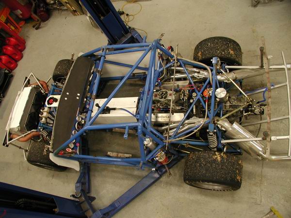

Home Built Tube Chassis IMSA Race Car - 3.8 lb./hp | 1987 Fiero GT 119,xxx, 3.1 motor, HHP swaybar, Full poly
For more IMSA Fiero info: http://www.cardomain.com/memberpage/789315

It is a fact. Mid-engine cars (in general) make better road racing cars than front engine cars. (puts on flame suit) Keep in mind that an AC Cobra and the like have "front" engines that are 60 to 90% behind the front axle. By putting the engine behind you, you can truly be mid-engine (better for inertia) and rear bias. I attached a layout picture for an example.
A stock fiero can be set up this way (longitudinal) with a V6 and a few tricks without going past the fire wall.

A classic example of another "front" engine race car is the Factory Five Racer. See: http://www.factoryfive.com/table/ffrkits/speccar/kit/specs.html for specs.
Note that the front-rear weight distribution is 46% front and 54% rear. Sounds real close to what you have.
BTW... could I stop by and just HUG your car?

The mid-engine design is one of the main reasons I like the Fiero. I want to be a little rear heavy (wait... that didn't sound right )
Back to the topic... Moving the battery to the spare tire area makes sense from a weight distribution stand point. It would be a better location than the nose due to the lower inertia.
